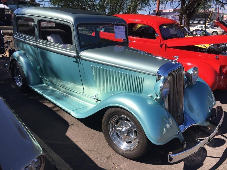

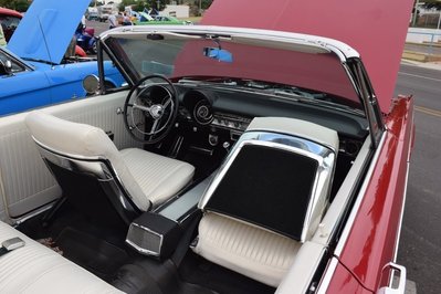

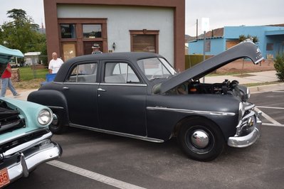

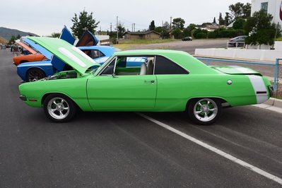

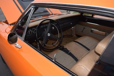

Show in Bisbee, Az yesterday. Did not win anything but there were a few Mopars....

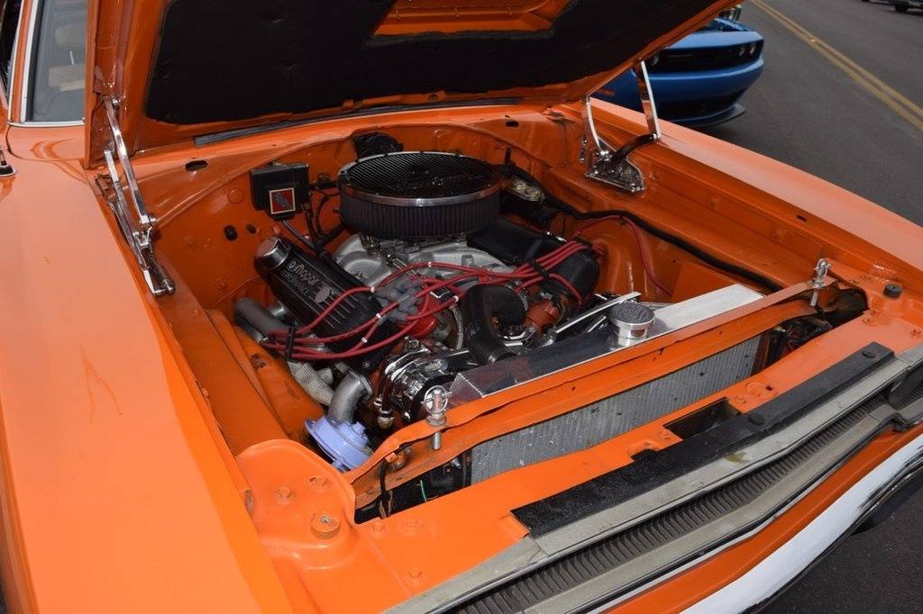

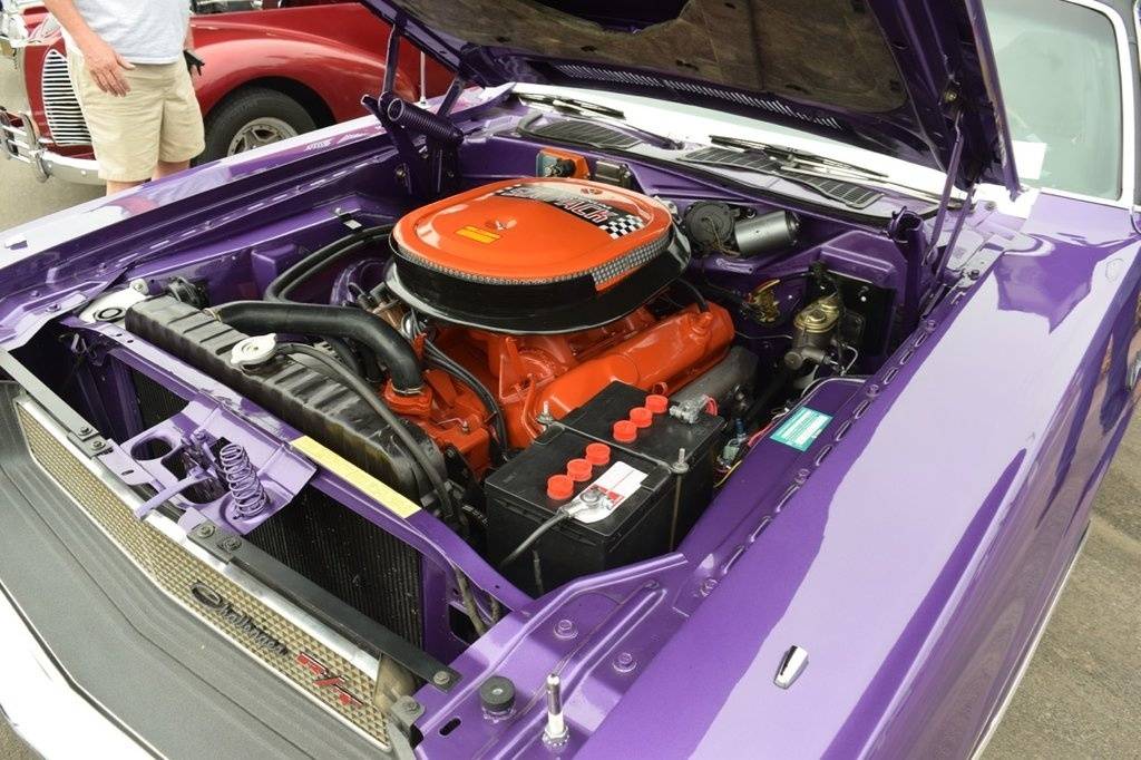

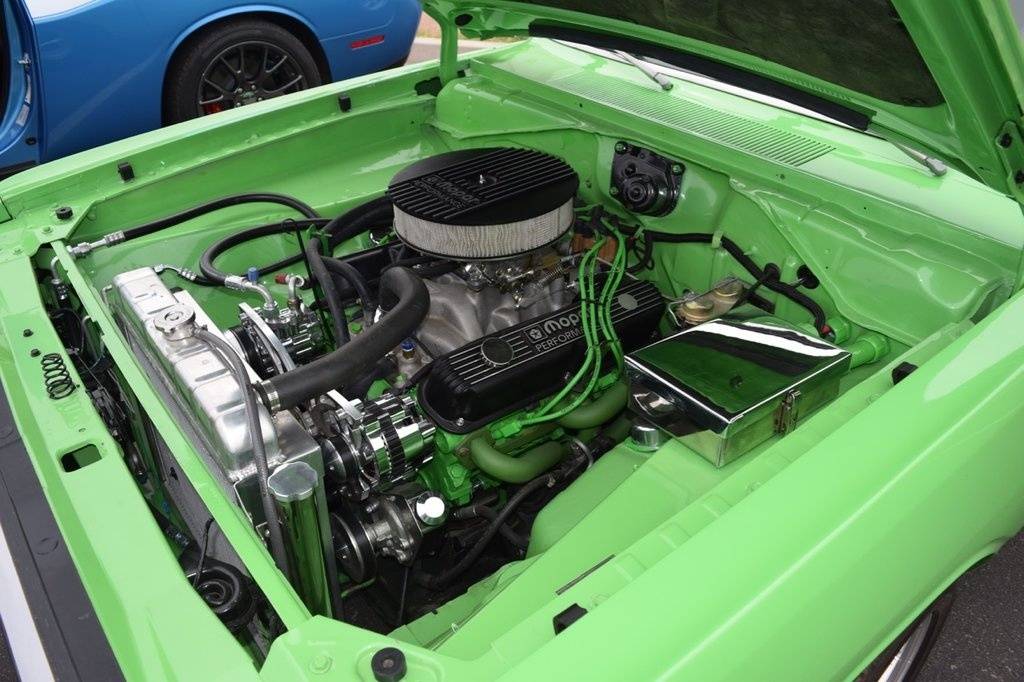

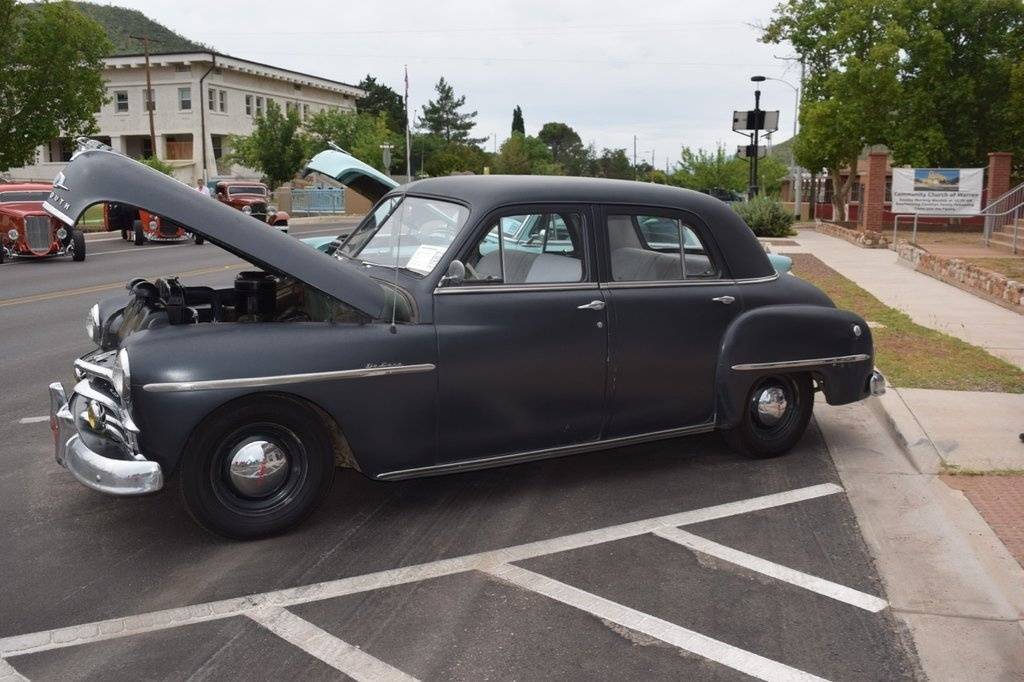

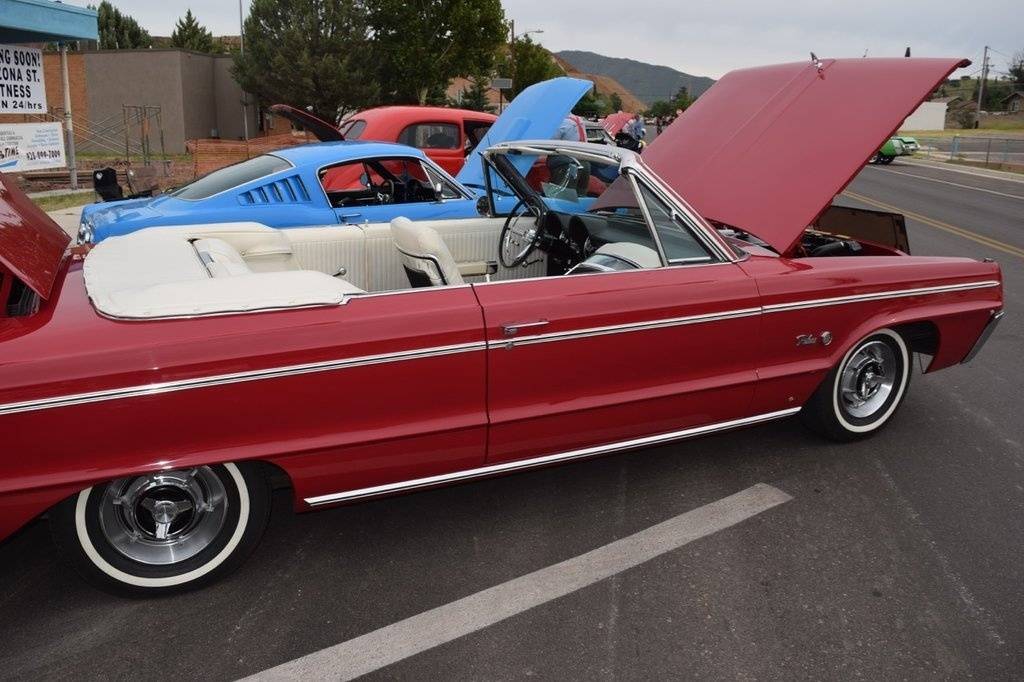

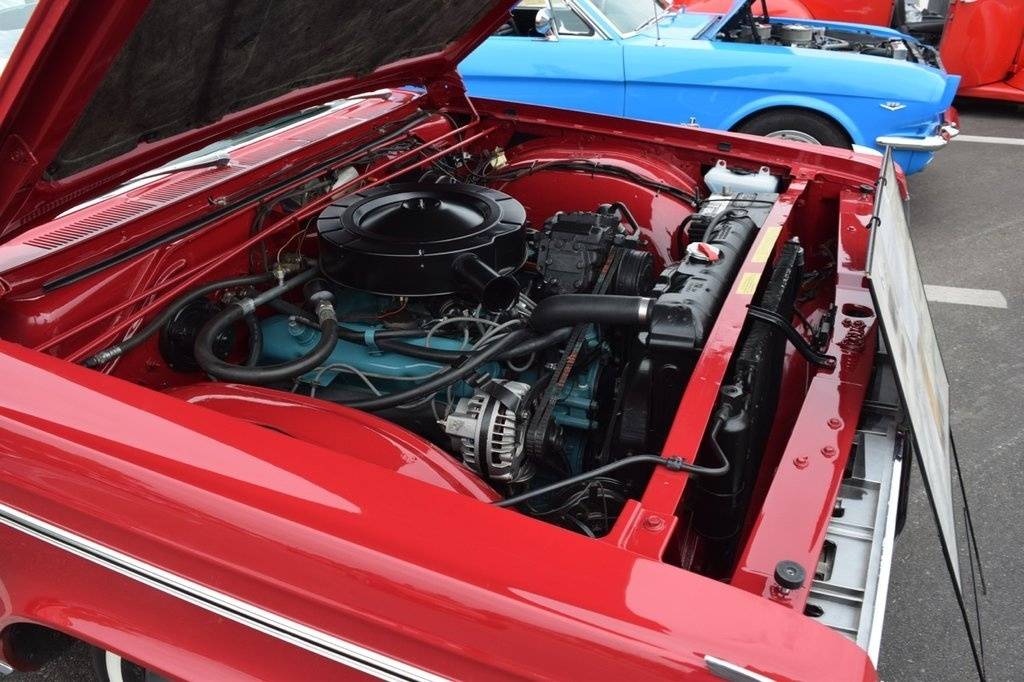

DSC_0089.jpg DSC_0091.jpg DSC_0093.jpg DSC_0094.jpg DSC_0095.jpg DSC_0096.jpg DSC_0097.jpg DSC_0098.jpg DSC_0099.jpg DSC_0100.jpg
Big competition at that show. I assume the road runner and challenger won trophies?
