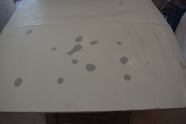

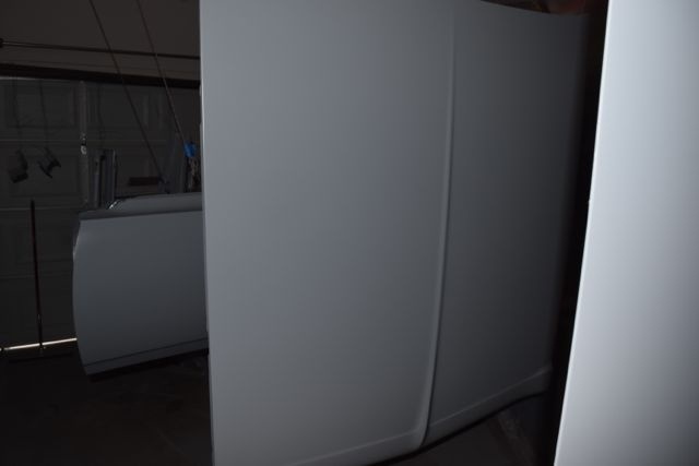

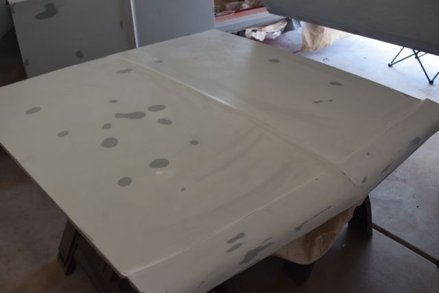

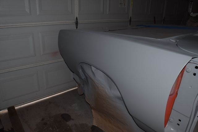

I am not sure I understand what happened to the hood. It had a lot of peaks, not dents
but a few layers of high build, then some blocking and it is nice a straight

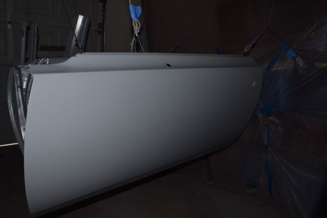

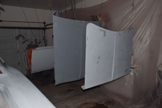

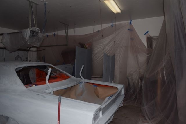

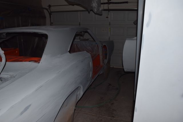

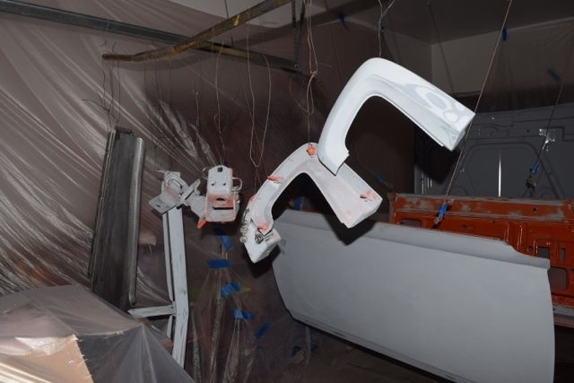

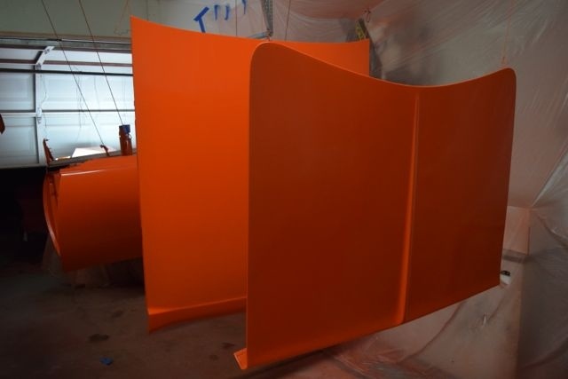

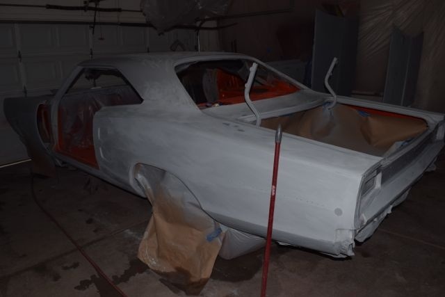

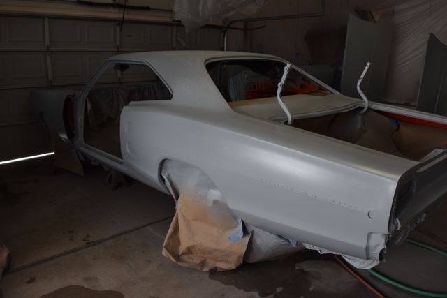

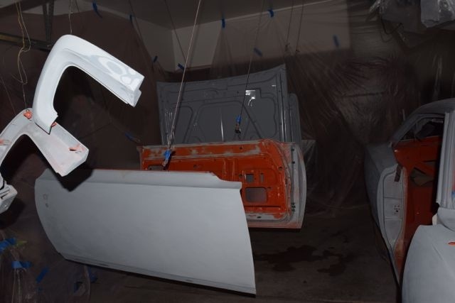

I am getting excited now. The Rube Goldberg paint booth is up and the panels are hung after I sanded out all orange peel and trash with 500 grit then wiped down with Wax and Grease Remover.
I then sprayed down the floor with water and squeegee it off twice. I will let it sit overnight to let the dust settle and shoot the SPI Epoxy with reducer as a final sealer first thing in the morning before the wind starts. If all goes well I will be shooting orange Sunday morning!
Hoods and to a lesser extent, decklids are funny things. The bracing underneath adds strength in those areas which can amplify issues when blocking. If you bear down on the block and/or use too short of a block, you can "create" your own artificial lows where the hood skin is un-supported.
It's all too easy to apply too much pressure when blocking, but it's the sandpaper that should be doing all the work, not you.
I realized that very early. I applied virtual no pressure on either the hood or deck lid and used my 18" block. You could feel the high spots with your hand. It was weird. It is very flat now.

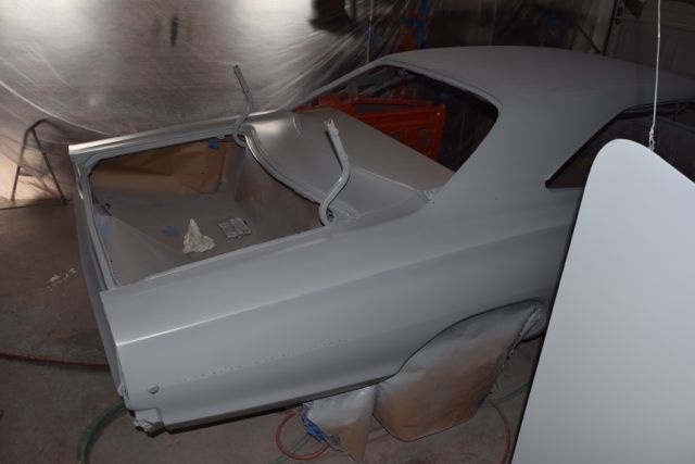

I could use a little prayer, heading out to spray the final sealer coat ready for color this afternoon….

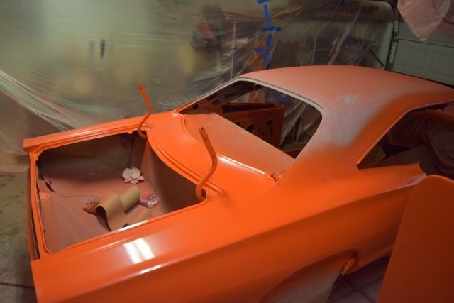

Success, except for one stupid move with knocking crap on the cowl then spraying over it…. light sanding in a few hours will take care of that. Spent the morning texting with Barry at SPI and I gave the game plan for the weekend… I should have an orange/black Coronet by Sunday Night..
Wet sanded with 500 grit and wiped down with Wax and Grease Remover… 45 minutes till orange…...

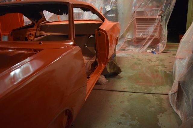

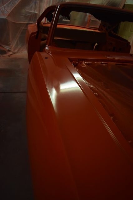

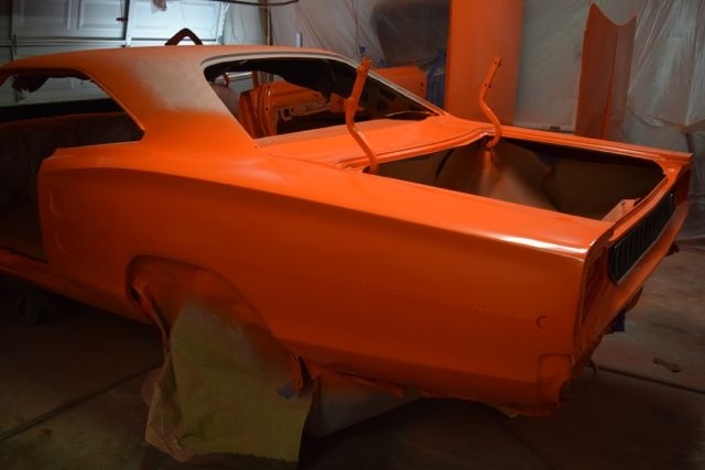

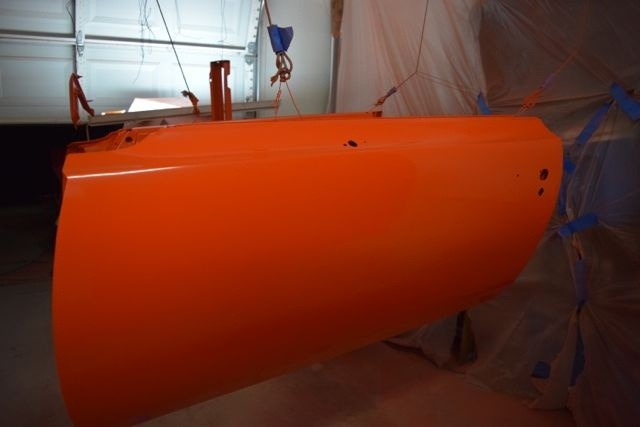

What a looooonnnngggg day. All I can say is thanks to Barry at SPI. I started shooting the Orange and I had a panic attack as the wet sand marks popped out like crazy on the first coat. I texted Barry and a little adjustment to the reducer in the paint and 4 more coats it is 99.9% better. What a bloody mess my garage is now. I looked like a umpa-lumpa when I finished and there is orange dust every where….. but it is done…. Tomorrow layout out the hood and trunk stripes shoot a bit of black and it is time for SPI Universal Clear.

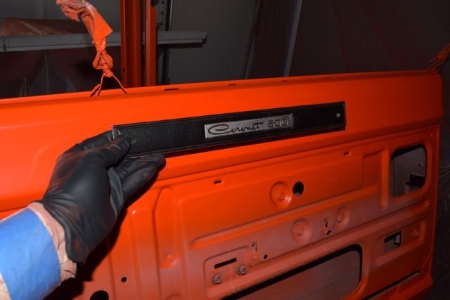

It is straighter than I ever thought I could accomplish and I am proud of that fact. I also got excited and wanted to see some details. The interior is black but I think I am going keep the inner door upper and lower panel orange with the black highlights. I may run a black strip down the middle where the placard is but I have not decided…

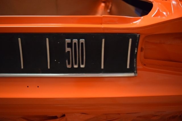

Can't find an example right now. More of a Plymouth strip that was on my old Sport Satellite. I wide stripe down the middle flanked by 2 narrow ones. I wanted something different and something to tie the black vinyl top and black rear panel and black trimmed grill together. I will likely paint the "500" center orange instead of red in the grill and rear trim.
