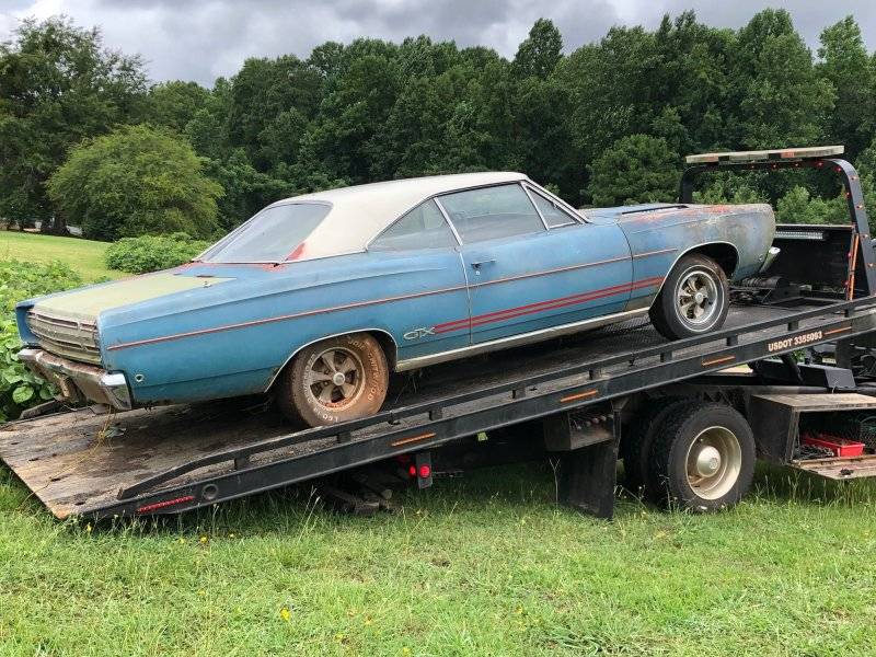

Here is a pix of my 68 the day I got it loaded up to bring home. The red stripes were obviously changed from whiteIMG_0153-1.jpg by the original owner. But it is a factory two tone paint car: question, was the chrome trim used to separate the two colors, as used on all vinyl top cars, factory on all two tone cars? Ive seen them with and with out the trim.
I would assume (always a bad idea) and did in post #8 that the factory used the trim to separate the two-tone otherwise it would look weird. I'm sure I have seen a two-tone transition from roof to body without trim also, but not on a factory car.

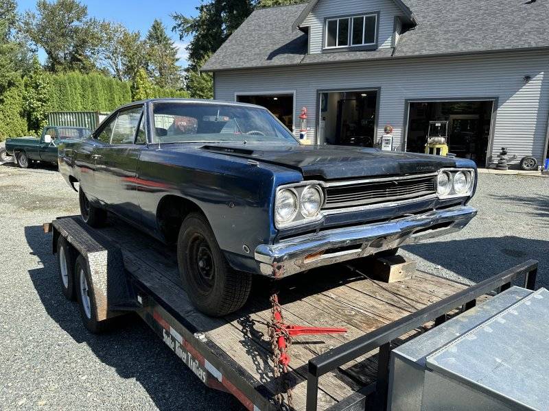

Finally made it to the trailer and heading to my shop in the cariboo! Parts & panels are loaded
