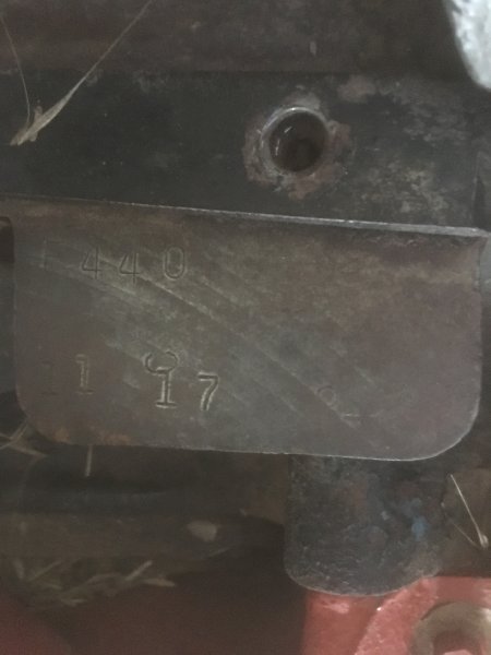

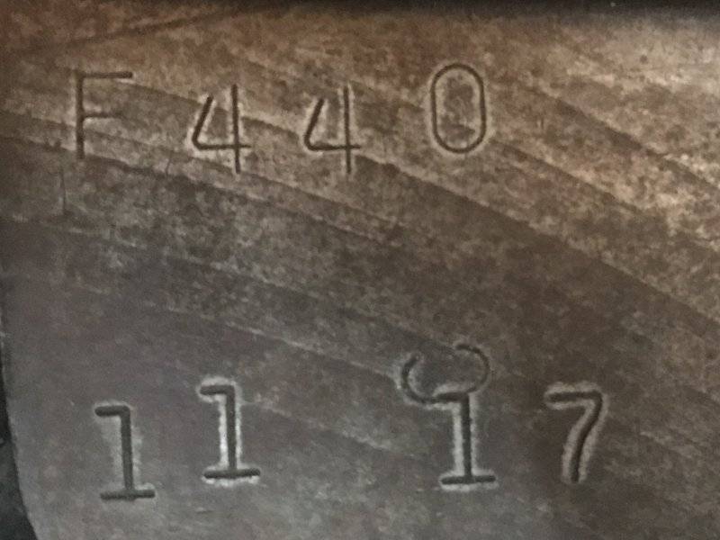

Looking at the block pad, I see the following:
F 440 which indicates a 1970 motor.
11 17 which I am assuming is the month and day of the build??
Then there is the sideways "C" which I cannot find on my block decoding sheet. Anyone know what that means?
Also following the 11 17 there is a space and then 2- (see second picture) which I have no idea what it represents.

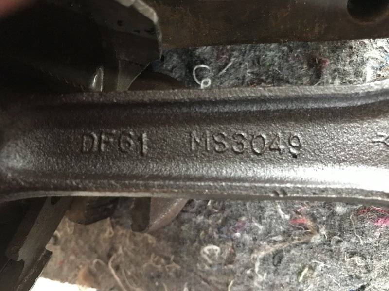

Here are the connecting rod numbers:
From what I can find online, they seem to be high quality replacements. Anyone familiar with them?

F440 is 1970 model year application
11 17 is assy date Nov 17th 1969
2 is 2nd shift
C - I've no idea
Lack of the HP stamp tells me it's probably out of a C body
2 is 2nd shift
C - I've no idea

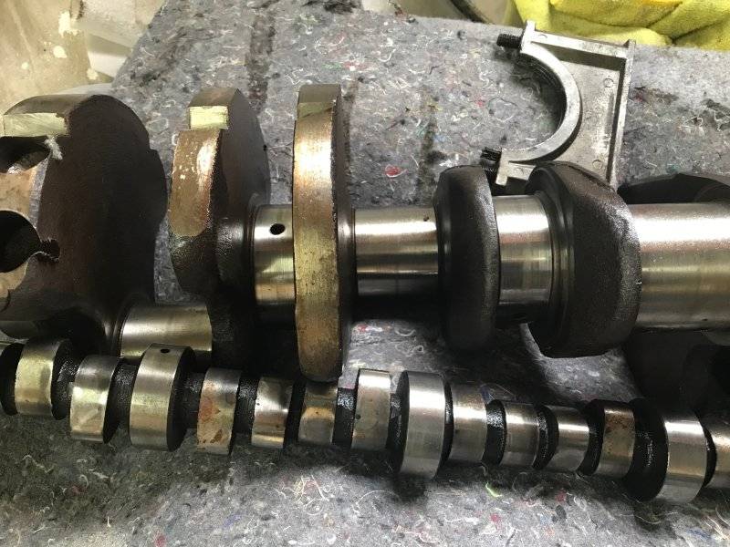

Thanks. I'm taking it to a local guy who worked on my signature car's motor tomorrow for an inspection.
Okay, the engine builder agreed it is a stock bore and he believes it should clean up with .030" oversize.
He told me the problem with sending a crankshaft out for work is the shipping cost is about $200. Apparently the combined costs are enough where he recommends buying a new crankshaft if mine is in bad shape.
He will give me his price to obtain the cam bearings, pistons, rings and freeze plugs in a few days, then I can search for a better price if I can find one.
With his current work, it will be some time in May before it will get to work on my block.

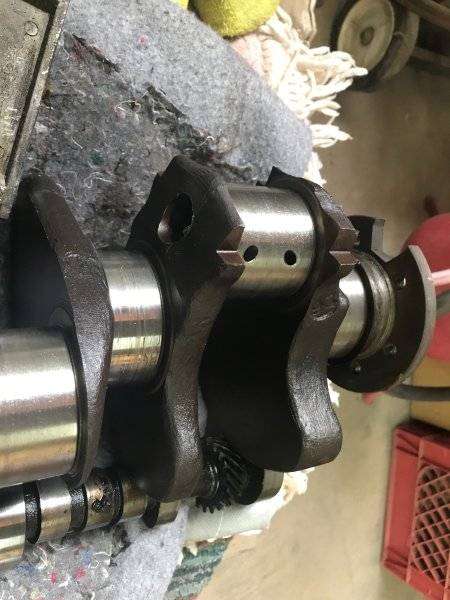

Those scratches look like water stains that have "wicked" into the gap? Is it a forged crank or cast? The pic's
are too close to tell. Measure the journals. could just need polishing.
