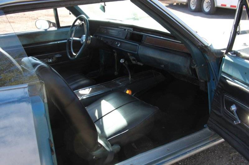

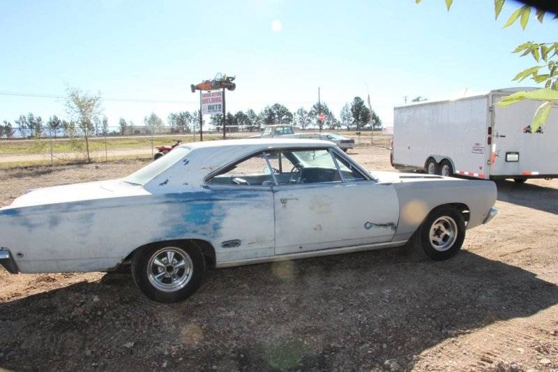

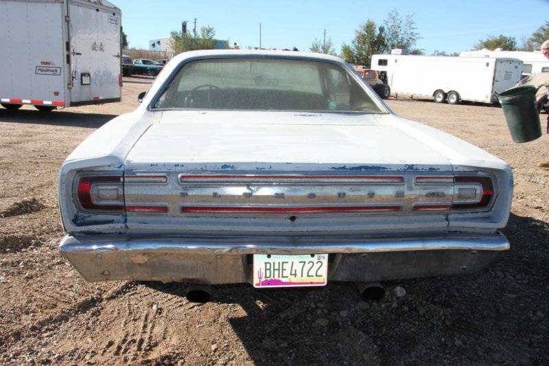

Purchased this car recently. The pictures show it assembled but the owner had taken it to a restoration shop in town and after they disassembled the car they basically quit working on it.
The guy ended taking the car home in boxes and rather than attempt to restore it himself put it up for sale.

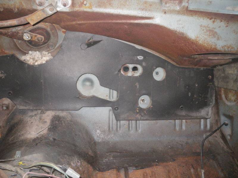

Pulled the dash assembly and then the heater box:
Nice mouse nest in the center. I'll post up some more pictures later.

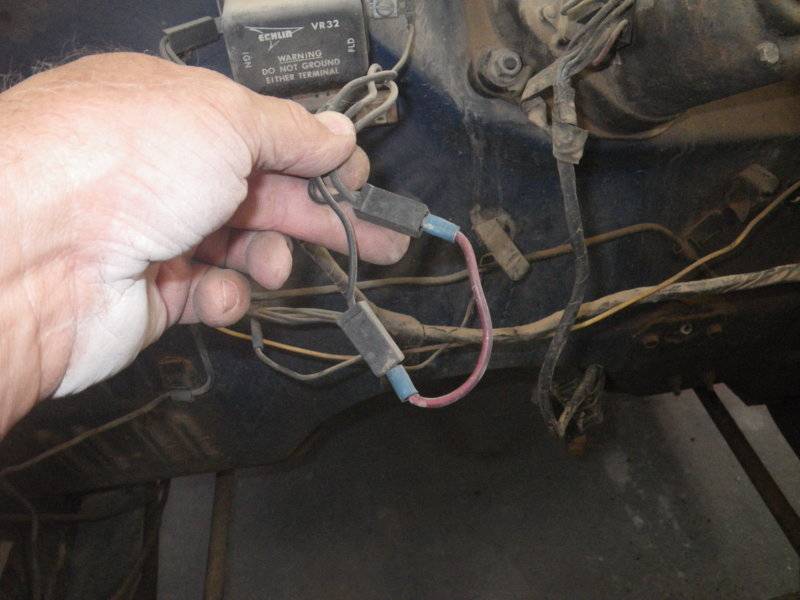

Next is the voltage regulator, washer pump, horn side harness. Note the fusible link:
A couple of splices and dead ends in this harness:

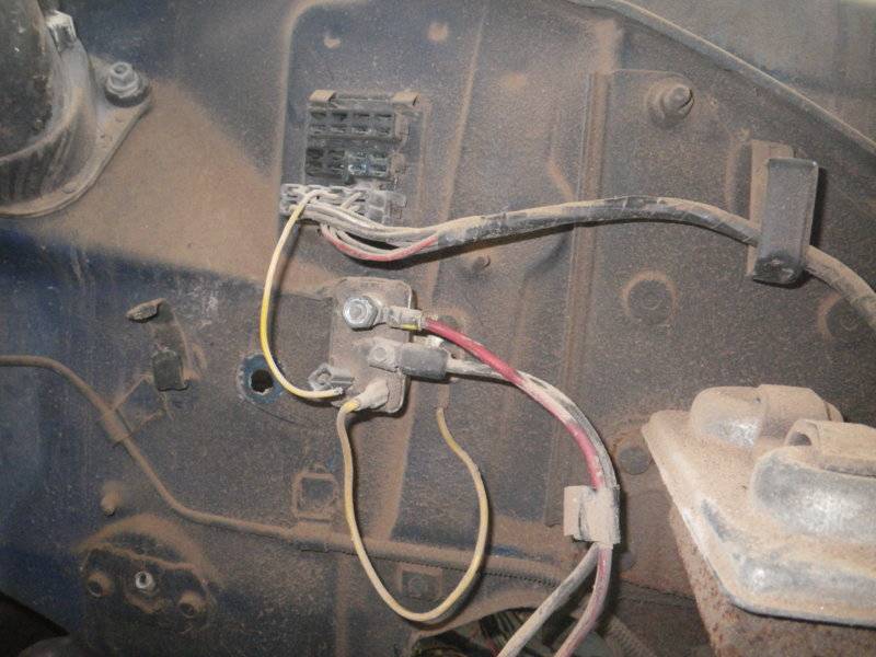

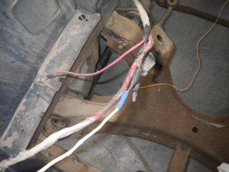

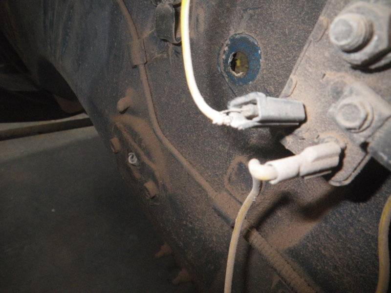

The final connector is for the headlight harness. Notice the yellow lead running to the relay. It is attached to the plug by one single strand of wire:

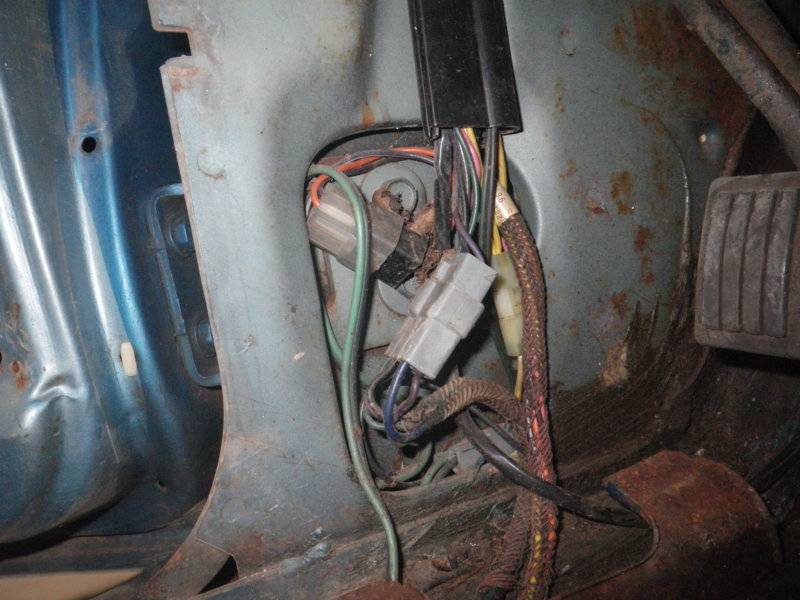

The connectors for the dimmer switch, console, dome light, trunk and tail lights is behind the driver side kick panel.
Of course all of these are wrapped with tape and labeled upon removal. You end up with a box full of wiring harnesses.

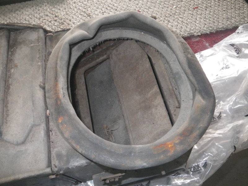

Also discovered the water leak that rusted the floors. It turns out the passenger vent to cowl seal was pretty distorted and obviously not making good contact.

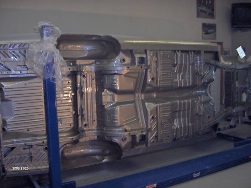

Some inspiration for you. I did this one 10 years ago.
This one is 100% original metal, nothing changed. This is a J code 1968 and a few things to note. Of course the one is the torque boxes, second, the pinion snubber was double plated, and at the rear shackles there is an additional gusset. These are all factory reinforcements.

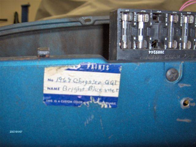

Not sure if this will help you but this was the paint code under the dash of the GTX.
