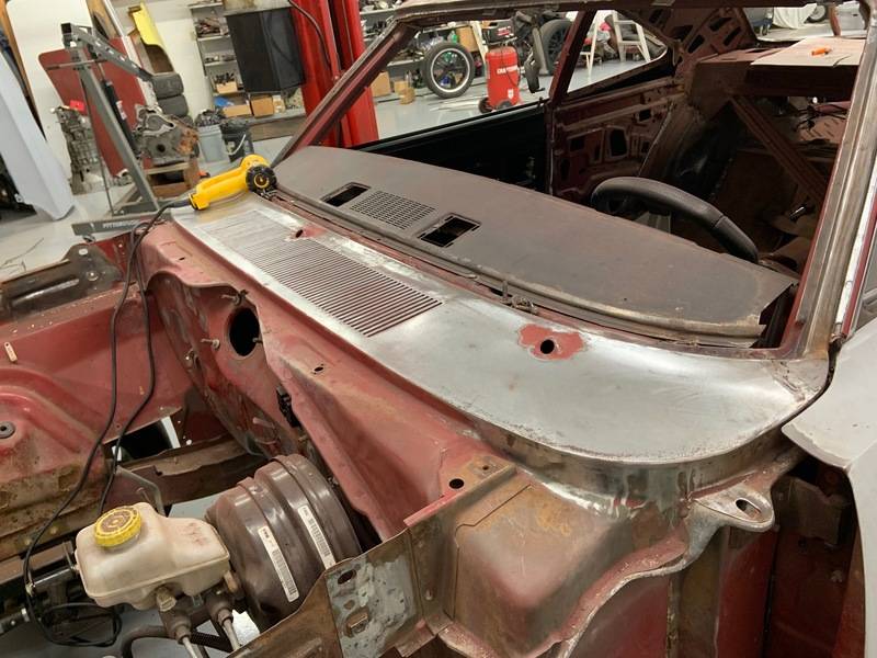

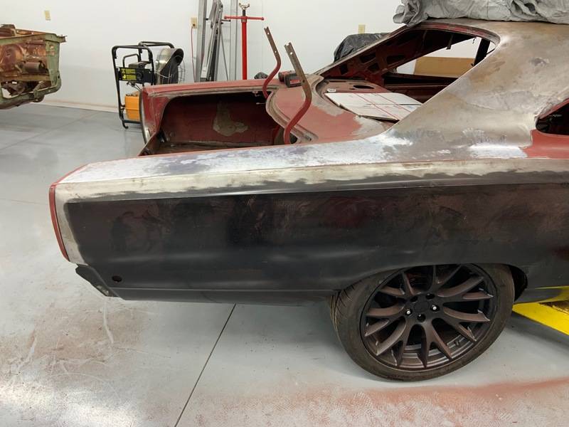

Thanks for the prayers and encouragement. For the first time in two months, I ventured out to the shop this week (twice!). My right shoulder (I'm right handed) has very limited range and i have to take it easy since the bones haven't grown together yet. The first day, I removed all the windshield trim clips from the window channels. Yesterday, I started the process of stripping the remaining red exterior paint. I only had 2 hours in me. In that time, I stripped most of the top of the right quarter panel. Here's about 30 minutes in...
This is all I got done
The disc on the left is the one I was using. I like them because they are quite effective and yet they don't build up much heat in the sheetmetal. I was using air and a fearless grinder.

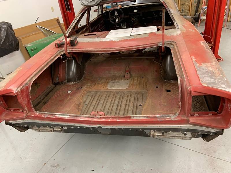

I've SLOWLY been stripping paint over the past 4 weeks. I'm stripping the large open surfaces so the media blaster won't warp them. I'll have the media blaster use aluminum oxide to strip all the jams, inside, engine bay, and bottom side of the car.
I also dug out all the putty/sealant that in the gutter rail. That stuff was HARD and difficult to get out!

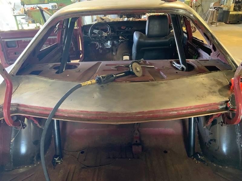

After getting t-boned in my 1969 charger in December, I started to really think and worry about side protection. If the other guy had hit me in the door of the charger (instead of the front fender), I would have been in serious trouble. After mulling it over, I decided to send the Roadrunner back over to my buddy's shop in order to install a 6 point cage that will provide me with some side protection. We will also plan for some modern seatbelts with inertial reels. I don't want the car to be annoying to get in and out of, but my wreck has made me look at things from a different perspective. While its there, the lower radiator support will get boxed/reinforced, and plates will be welded in so that it can be provisioned for a Monte Carlo bar.

The cage should finish up next week but here are a few early pics
Matt tabbed up some finish panels that I'm really happy with...
