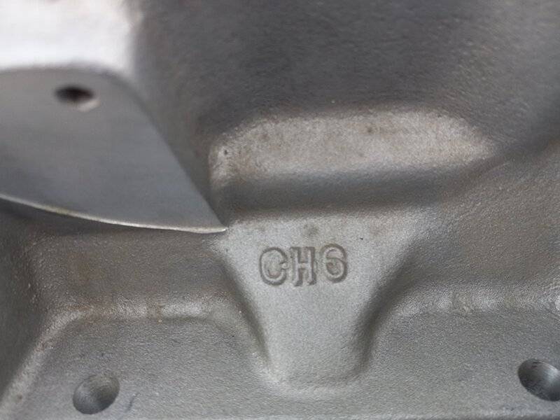

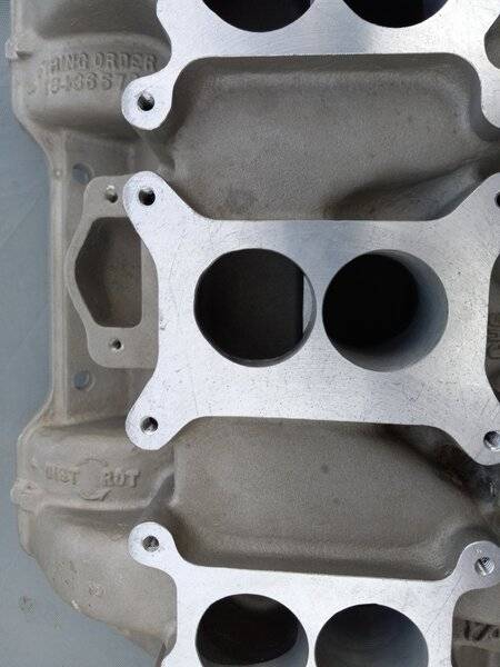

The carbs sure look right. I'm not so sure about the intake being an original A12. The early over-the-counter Sixpack intakes could be spotted as non-original from across a parking lot, they had ch6 cast on the heat crossover, and no part number. I know, I've got one.. It made restorers unhappy, so edelbrock changed the mold,getting rid of the ch6 and putting the part number back.
What makes me wonder, is two things....I know the six at the end of the part# on the originals is faint, and slightly "wonky". Yours is MAYBE a little too nice. And, it doesn't look like it has ever had paint. All original A12 intakes had paint.
This is NOT a put-down, I love your car and what you are doing. I would DEFINITELY use your intake and carbs. Just paint the intake.

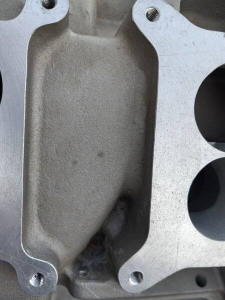

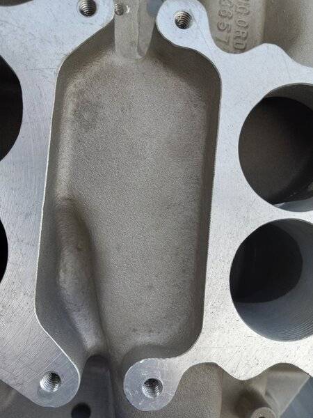

Not doubting you, and thank you for your feedback, but could you post a pic of yours without a part number? I have never heard that before. I have heard the same thing about the exaggerated and offset 6 at the end. I also heard that they cleaned it up some but the new 6 was still off base some (which mine is). Been doing a lot of reading on them today and never came across anything with no part number at all.
And mine was recently painted. Not sure by whom and when but it has been painted and cleaned up a bit.

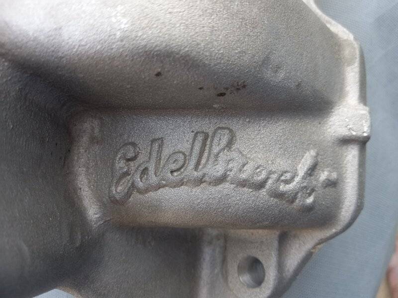

This is my NON original intake. The edelbrock logo,cylinder numbers, and firing order/rotation logos are very poorly defined, and the CH6 gives it away as a late counter intake after the cores had worn out. The core shift is terrible too. Mine was free, but that's cause it will take some work to make it usable. It was the victim of an unsuccessful attempt to conceal a nitrous setup (by someone else).
