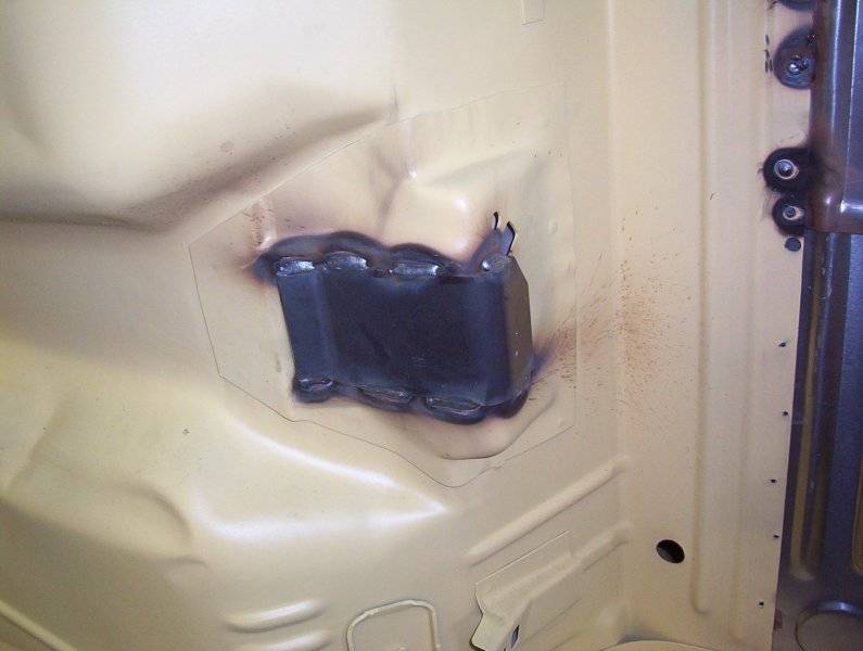

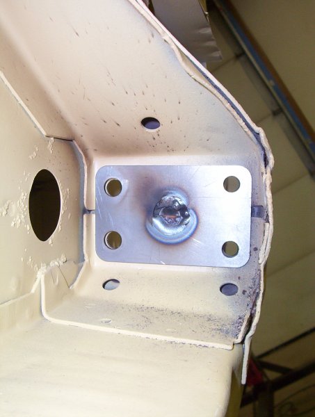

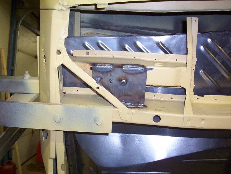

The rear spring front mount also had a reinforcement. Here is one photo and the floor along with rear shackle reinforcements. Lots of people have never seen these.

Pictures you see are from my car as I installed them I also did all the mods along with full length completely welded in frame ties.

Dr. Diff sells the front spring hanger reinforcement plates. I am not aware anyone reproducing anything for the rears or pinion snubber area.
There was a guy I think out of Florida that was selling them. I cant remember his name. I believe he also sold me torque boxes.
I bought the rear shackle plates, pinion snubber reinforcement and the spring hanger plates for my 68 Charger. It's a 440 R/T so it didn't have any of that stuff to begin with. I didn't do the torque boxes. Resto Rick sells all of the reinforcements
