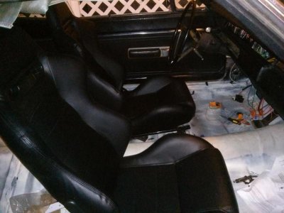

Not had time to do much with the car the last week. I managed to install the bucket seats. I hope this weekend to replace the fuel lines from tank to pump and put in a new sending unit if it comes in today.
I got to find a roll cage I can start installing so I can add a seat belt harness setup. Also got to find a video on tuning the holley carb and setting the timing for this car. Im ready to do a burn out :)

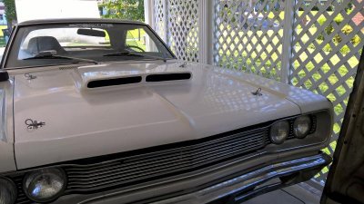

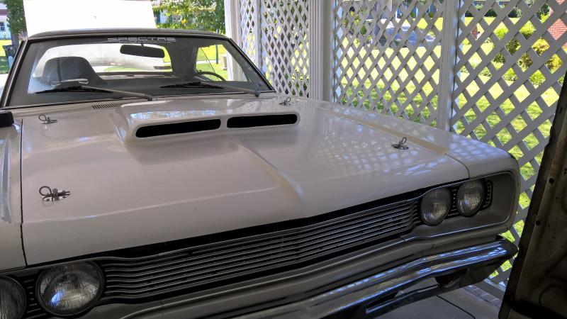

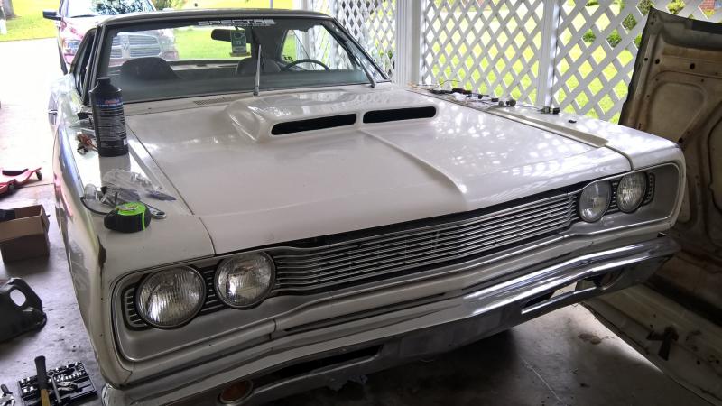

I have not had the time to do too much. I am working on getting the new hood fitted and pinned.

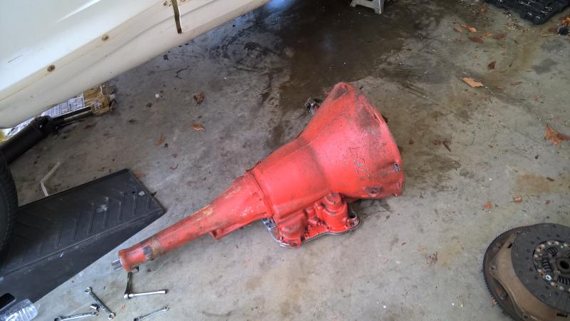

Finally got the transmission our after some help from the driveline forum. I am again in unchartered waters. Just learning as I go.

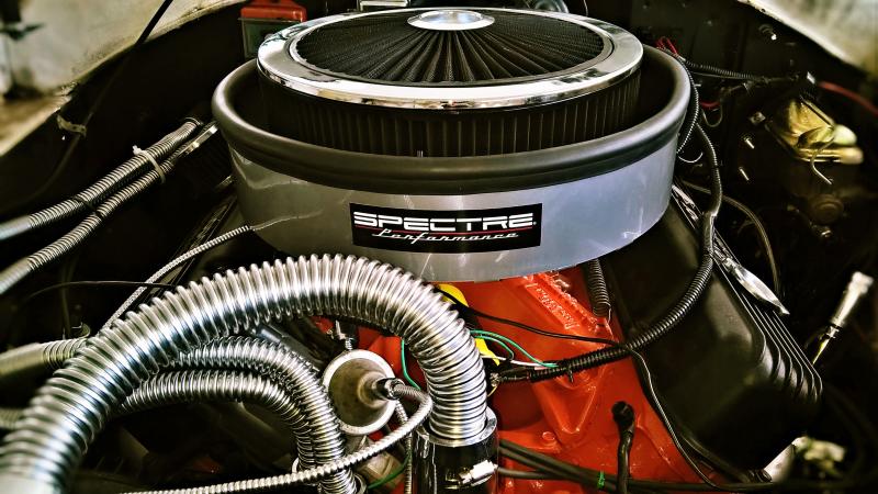

Spectre Performance has supplied me with an excellent air cleaner setup. I am going to work on building a breather/intake box for the a12 hood. I want it to be fully functional and block out as much engine heat from the intake as possible.

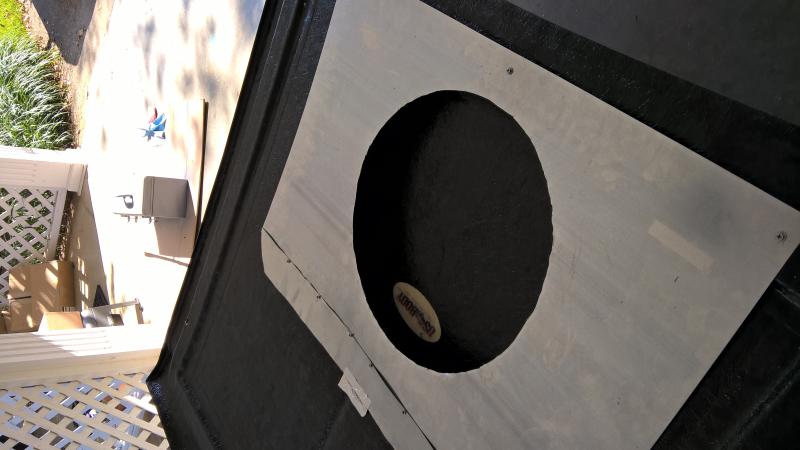

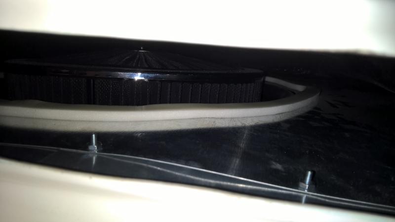

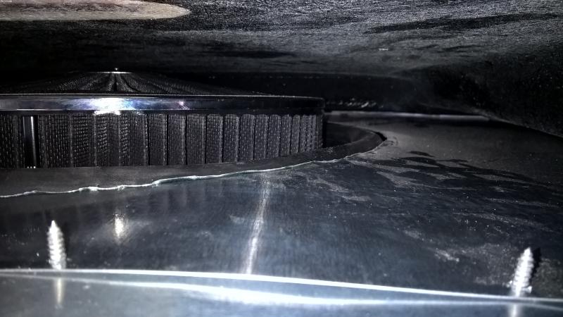

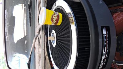

Well this weekend I decided to work on the air intake for the new hood. You guys probably know this but if you want a good way to locate or measure hood clearances use play-doh and a little dab of grease. This was my first attempt at this, the fitment seems pretty decent. I have to do a bit more work flattening the metal more and making sure all gaps are sealed and sturdy.
Sorry 2 of my pics are sideways not sure why the forum is flipping them over.
