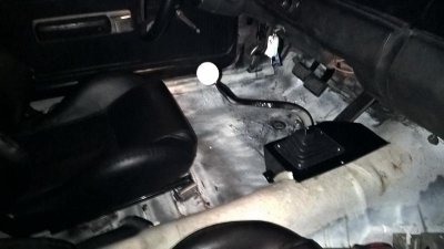

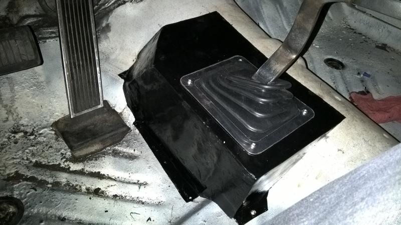

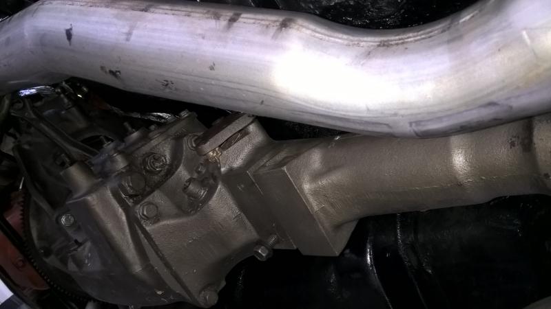

Not too much to show yet but have the 4 speed mounted but still need to install the linkage, cut out the tunnel area, drill and tap the mounting pad.

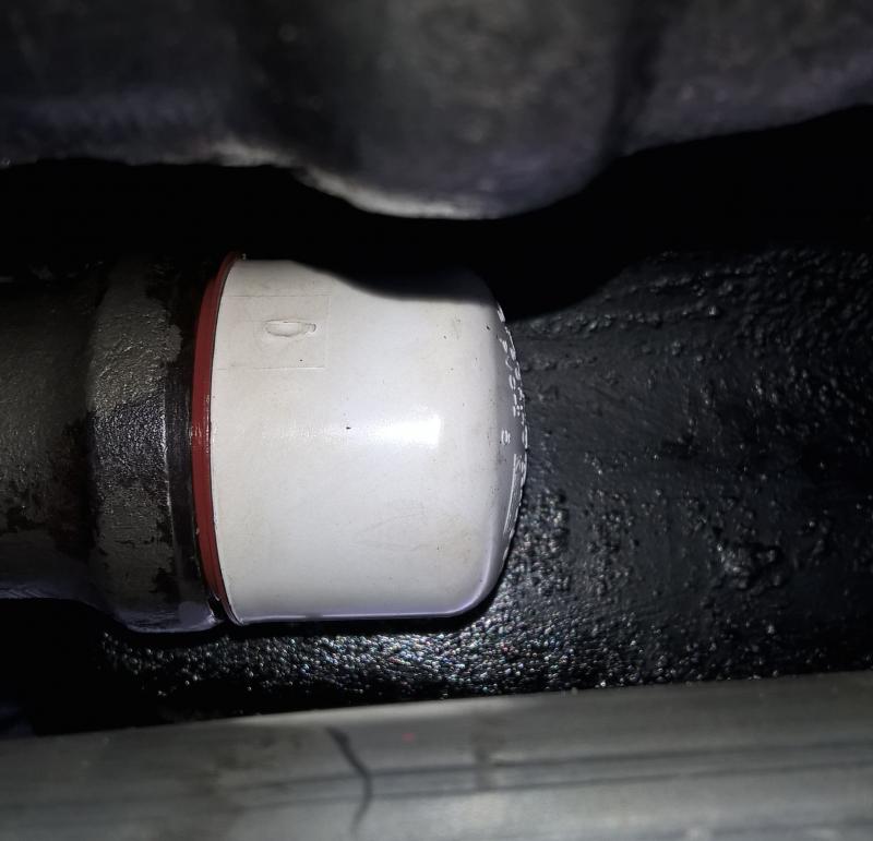

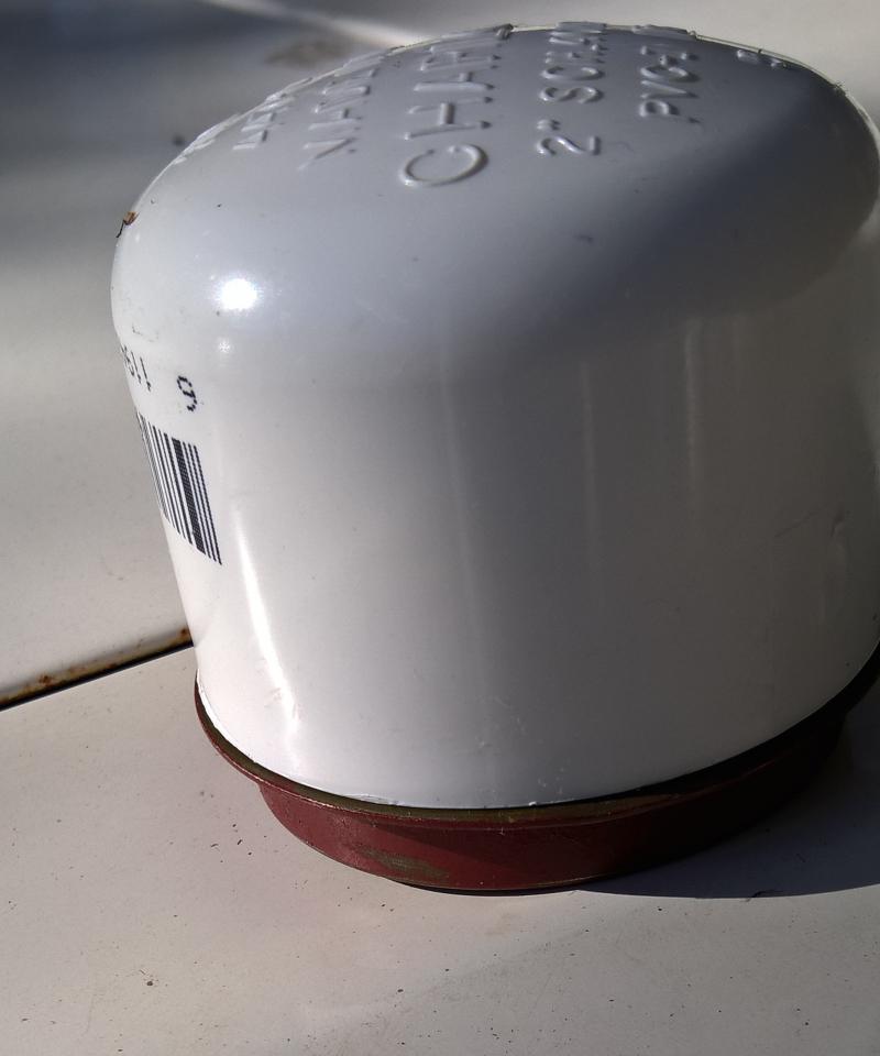

I replaced the rear transmission seal and found a cheap install tool if you have to replace one. I used a 2" pvp cap $1.30 from home depot.

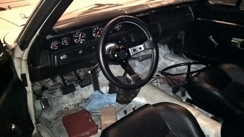

I swapped the steering wheel out for a new one that I am testing out.

Any info on your gauge set up? I'm trying to figure out what to do with my non rallye dash and it looks like you've made something work…
Where did you get the steering wheel ? More info on the dash setup please.

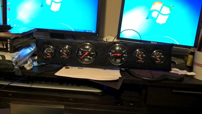

Yeah I made the dash from scratch and was cheap and easy do do.
This is what I used:
  1. I started with MFD board from Home Depot, enough to cover the dash. (same type of stuff people use to make audio boxes from)

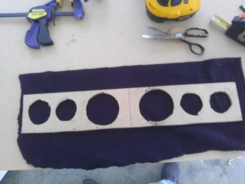

  2. Use a compass if you have one, I made one out of string and measurements at n,s,e,w of the circle. Cut out according to you gauge size (auto meter has the measurement in the included instructions). For cutting I made large hole in the center with a drill and drill bit. I then took a jigsaw and cut out each hole. If you have a dremel tool it would probably be easier. I took some sand paper/file and cleaned up the holes to be complete circles. Fit test your gauges they should fit in snug.
  3. Buy some scrap fleece from a material store, just the cheapest stuff they have. Cut it out to cover the front and back of the wooden gauge cutout.
  4. Coat the front of the gauge wood with some self type of strong adhesive allow it to become tacky and cover it with the fleece (I put mine in the center of the fleece so I could wrap the remainder of the fleece over the top and bottom of the wood.) I used http://www.homedepot.com/p/Loctite-13-5-oz-High-Performance-Spray-Adhesive-1408028/202365672 adhesive which I already had. Make sure the fleece fits tight with no wrinkles. After it dries I pulled the rest over the top and bottom of the wood and glued.

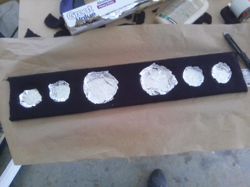

  5. After the glue is dried I took a razor and cut out the holes for the gauges. I test fitted the gauges again then removed them. Covered the inside of the gauge holes with tin foil for the next part.
  6. I took fiberglass resin and a paint brush and coated the front of the gauge fleece a couple coats and try and get it as flat as possible. http://www.homedepot.com/p/3M-Bondo-1-qt-All-Purpose-Fiberglass-Resin-20122/202077790
  7. After the fiberglass resin was is dried I removed the foil from the gauge holes and test fitted gauges again.
  8. I took some left over bondo and put a light coat over the front and get it as flat and smooth as possible and let dry to its instructions.

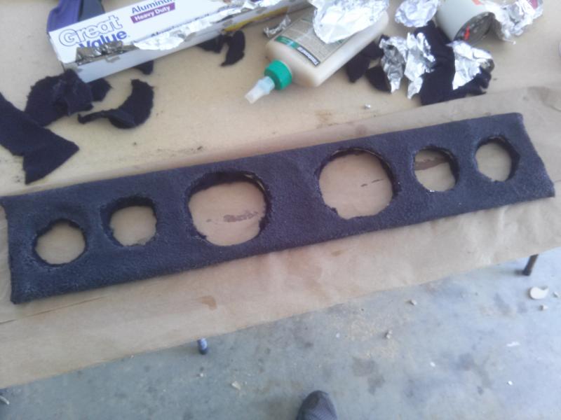

  9. Sand smooth the front of the gauge panel then test fit gauges again. This should look very close to how your wanting it to turn out.
  10. I removed the gauges then covered the front of the panel with faux leather using extra adhesive. I cant exactly recall where I got the faux leather at but I believe it was shelving contact paper from home depot. It was about $6 and came with a ton.
  11. Cut out the holes with a razor be careful not to over cut into the front of the panel. Then place in your gauges in for the last time and line them to your liking Then attache the rear of the gauges with the gauge bracket.
I will mention that the Non Ralley Dash frame may need some slight metal trimming, I cant quite remember. I also replaced the bottom section with toggle switches and new light indicators. I know this panel needed the old switch frame section cut out some.
I wish I had taken more pictures but for some reason I did not. The last picture has a few creases visible but I was able to flatten them out.
Also you will need to decide how you want to mount your gauge panel. I put screws from front to brackets I made that hang down.

This is the exact set I bought. Minus the Tach it was bought separately. The speedo is 3 1/8" and others are 2 1/16"
http://www.autozone.com/gauges-and-...ter-designer-black-street-rod-kit/131198_0_0/
I started off using sheet metal but when I was done I did not care for the look. I also did not have the right tools to make it nice. I used tin snips which ended up warping the metal more than i would like.

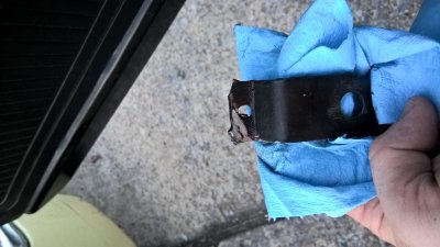

Well today kinda sucked, took the car out to see how it drove. Stopped at a rite aid to pick up a drink then got back in and no reverse..... The reverse lever on the hurst shifter broke off :angry1: Would have never thought this was even possible. Perhaps the lever was already damaged. Anyways Im ordering new shifter sooner than I thought I would.
