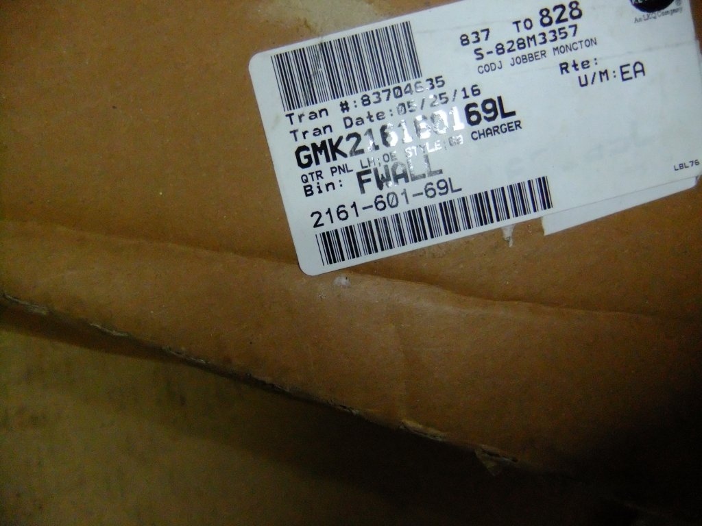

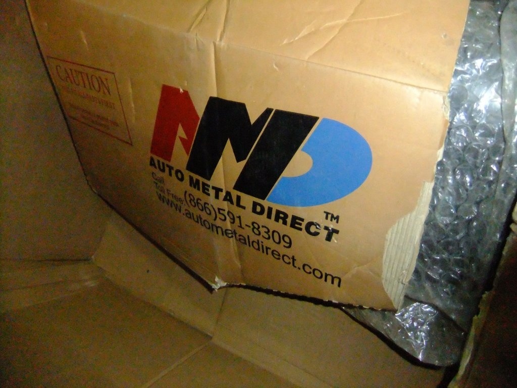

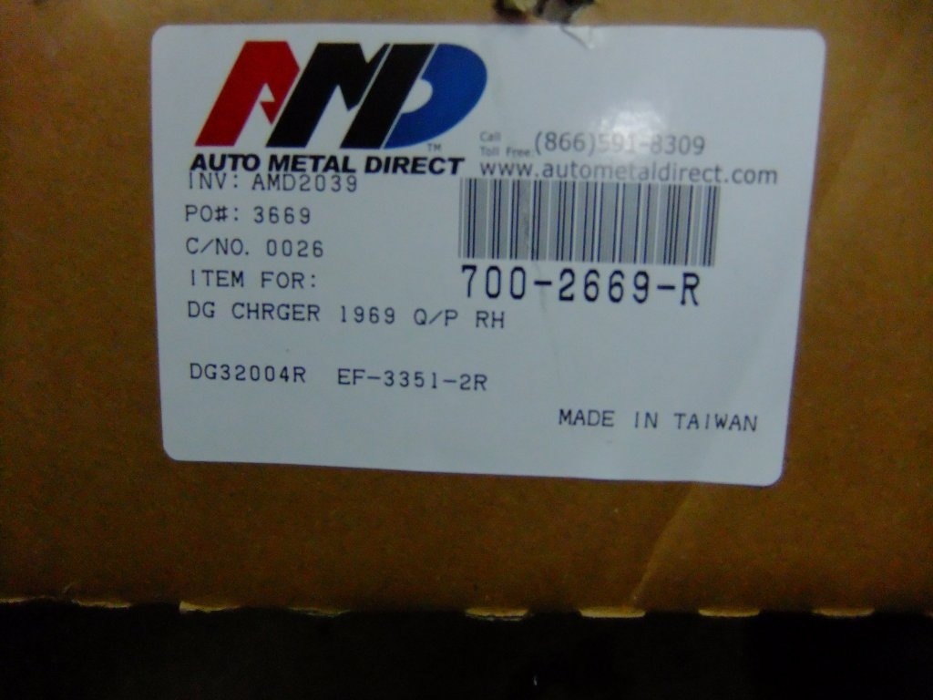

Wondered if i could get some of enlightenment on a issue here. Now i know that people will swear AMD metal is superior to anything else(goodmark for example). however, that being said, my quarter panels just arrived and they have both AMD and Goodmark part number labels on them? they came in AMD boxes? Would this mean that they are intact all made in taiwan and just stick the appropriate label on them for the company??
Wondered if i could get some of enlightenment on a issue here. Now i know that people will swear AMD metal is superior to anything else(goodmark for example). however, that being said, my quarter panels just arrived and they have both AMD and Goodmark part number labels on them? they came in AMD boxes? Would this mean that they are intact all made in taiwan and just stick the appropriate label on them for the company?? View attachment 394293View attachment 394294 View attachment 394295
Are these direct from AMD? If do, I would guess you are right. For a retailer, it might just be a way to list both numbers for an identical part and just carry one in stock?
