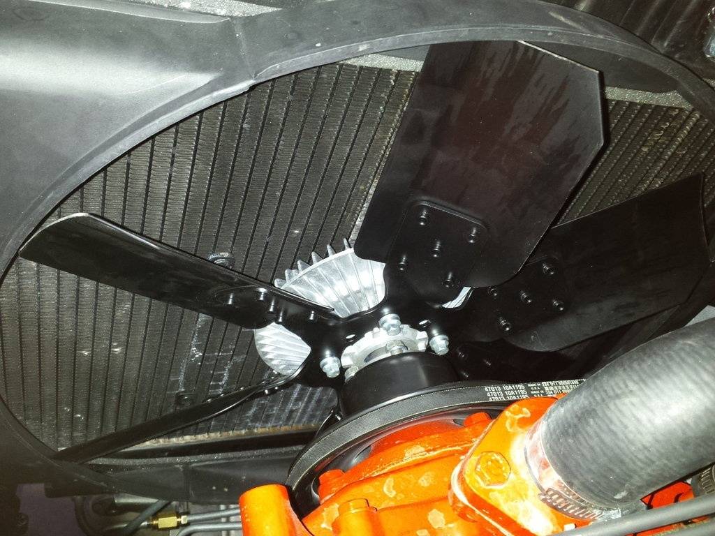

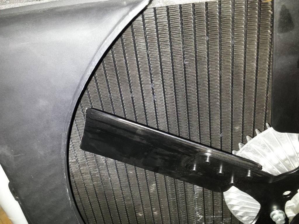

Here are a few pics of the fan. I had to take off 1/4" from the end of the blades as it just barely rubbed. Scribed a line with calipers and used a cutoff wheel.

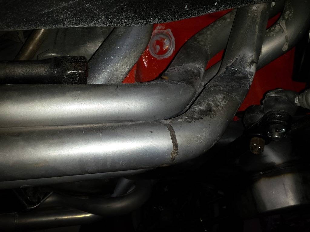

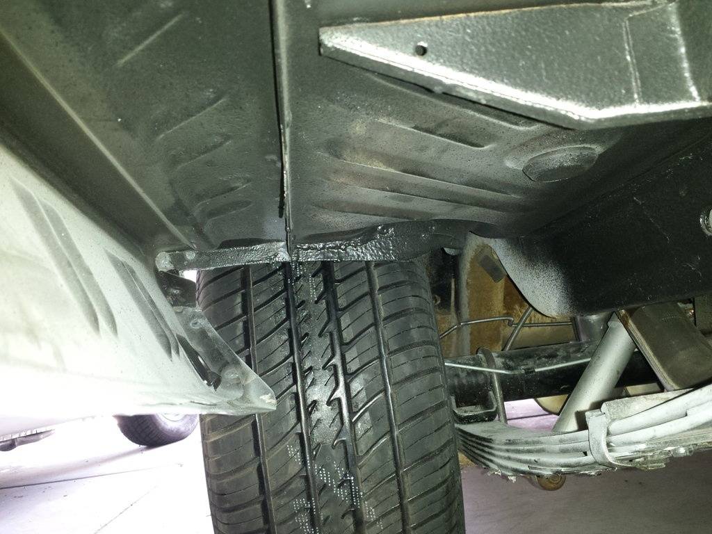

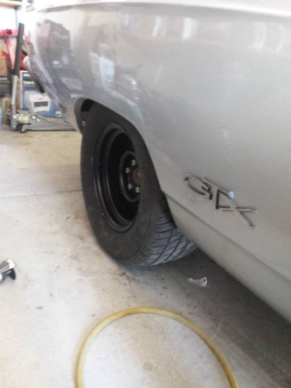

And what started as me putting my speedo cable in ended with me punching a hole in my header while clearancing it from the torsion bar lol. So I pulled the torsion bar, hammered it up and welded. The speedo cable is still laying there...

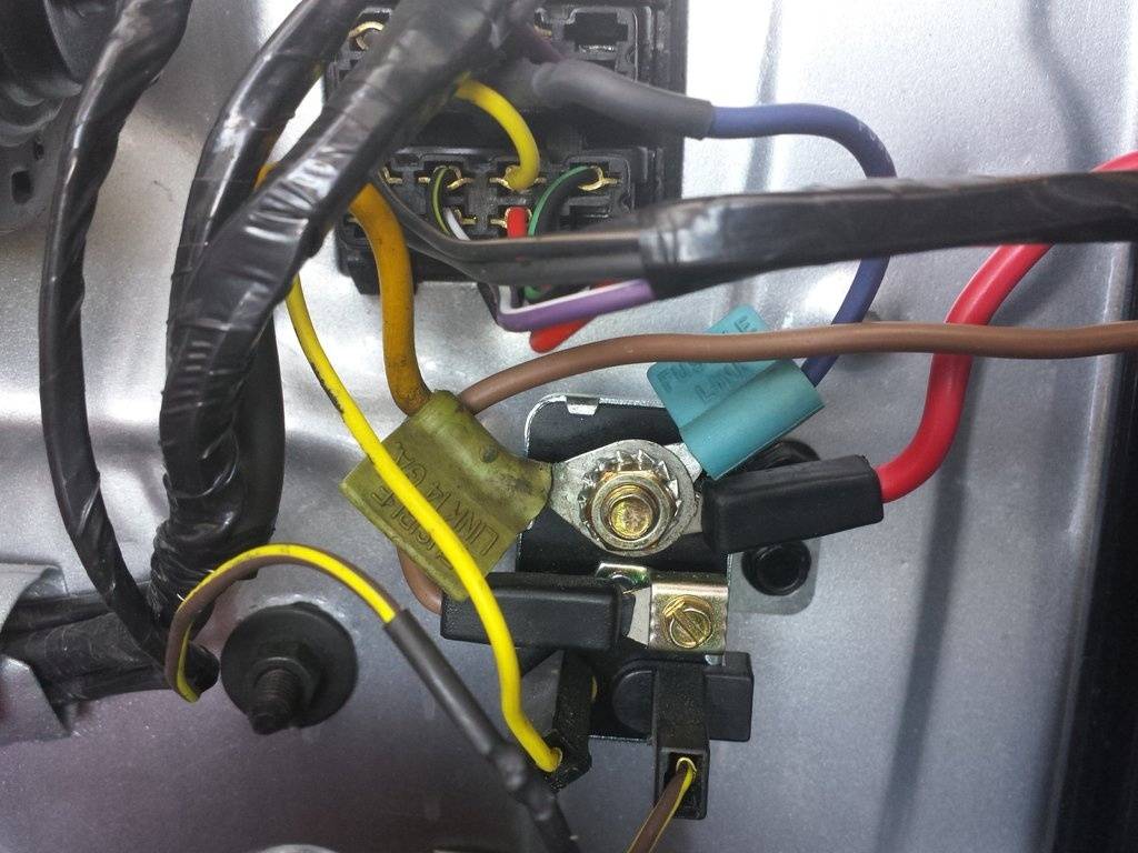

Update. I figured out there was an issue with the high beam wire (red) so I ran a new one from the bulkhead to the floor dimmer and while I was in it I ran a new light green wire from the floor dimmer to the headlight switch.
I still need to wire in the high beam indicator, which was on the same red wire circuit but I want to check if the connection on the dash is good first.

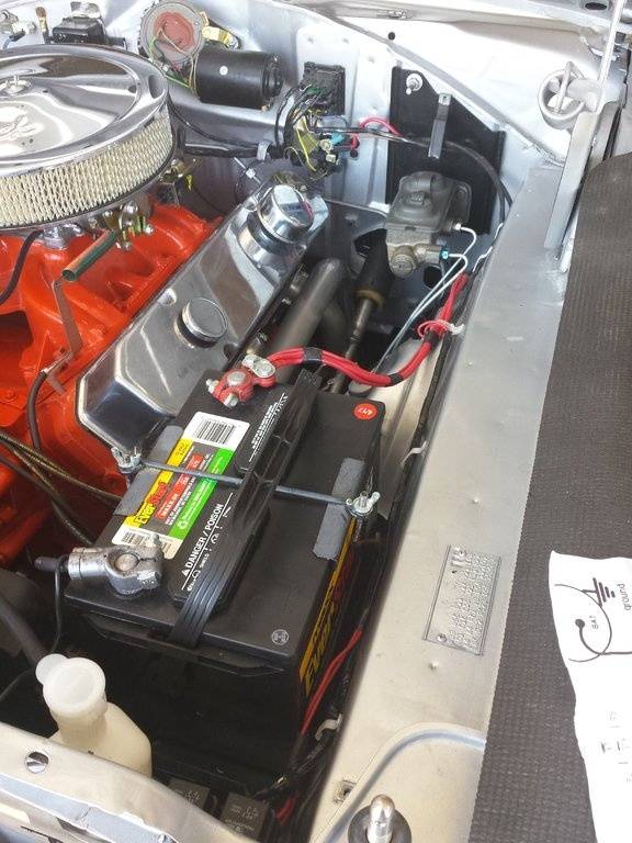

And I completed the ammeter bypass. The red and black bulkhead wires were spliced into a 10 gauge wire, out the bulkhead and into a 16ga fusible link to the starter relay +. I also ran the black alternator wire to the + through a 14ga fusible link.

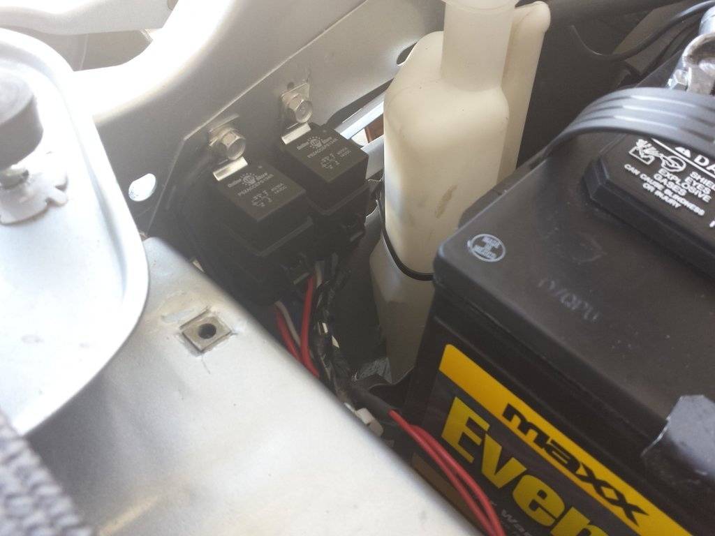

Then I installed my high / low headlight relays right on the radiator support. Everything works great. I am still waiting on a length of fusible link to put on the hot side of the relay.
Next step is to install a volt meter.

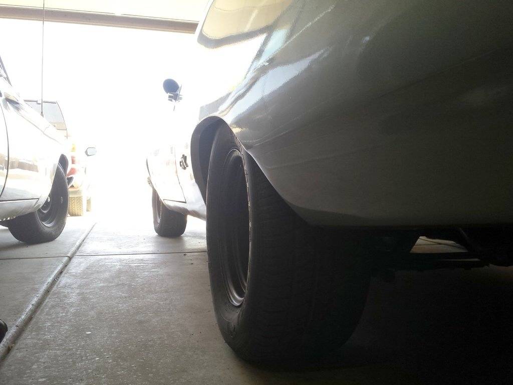

And for the test drive it got a little sporty. I got on it pretty hard out of the neighborhood and although the engine was revving nice I didn't notice I was laying 2 strips of rubber for half a block :)
And out on the road i was into it about 3/4 throttle and stayed into it straight to 5800 and shifted, burning my tires most of the way. This car is awesome!!! I have my wheels and rims ordered. Wheel Vintique 63 Steelies, 15x8 rear, 275/60R15 Cooper Cobras; 15x6 front 225/70R15 Cooper Cobras. Plus Summit will mount and balance for free.

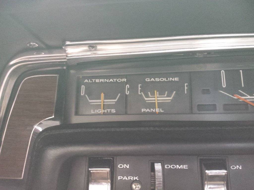

I swapped the ammeter with a Sunpro volt meter. I'll leave all the details to the imagination since I forgot to take pictures :(
I gutted the ammeter, stripped the guts out of the volt meter and mounted it straight to the aluminum faceplate with the tiny voltmeter screws. Small mods to the cluster stud holes and shrink wrap around the stud bases to finish.
Then when I got it all back together, the fuel gauge stopped working. So out it all came again. Turns out the the gauge was bad but the pin connector was also not well connected.
In the end, the volt gauge is swapped in and works well. And I got my speedo working!

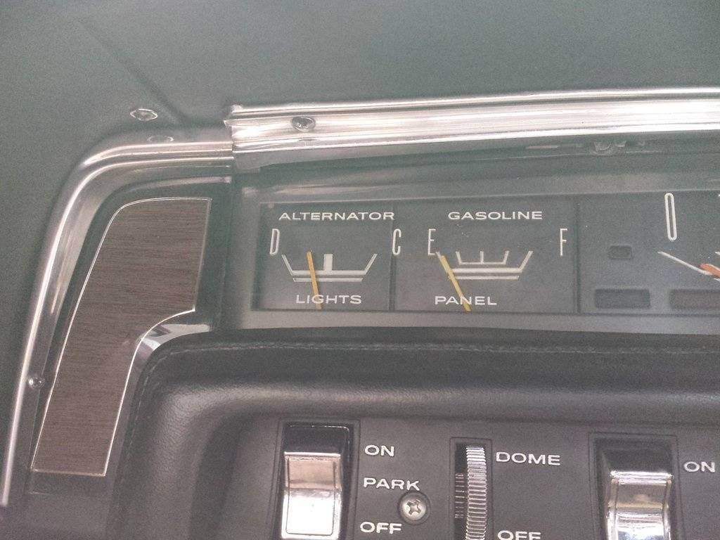

With key on, 12.6v the needle is to the left..
At 3k rpm, 14.6v....
Interesting idea! I've been looking for a way to replace mine as well.
There are a few threads on line that referenced using the Sunpro CP8215 gauge. The needle is a little short but the old needle will super glue right onto it. At least for a 68-70 non rally dash.

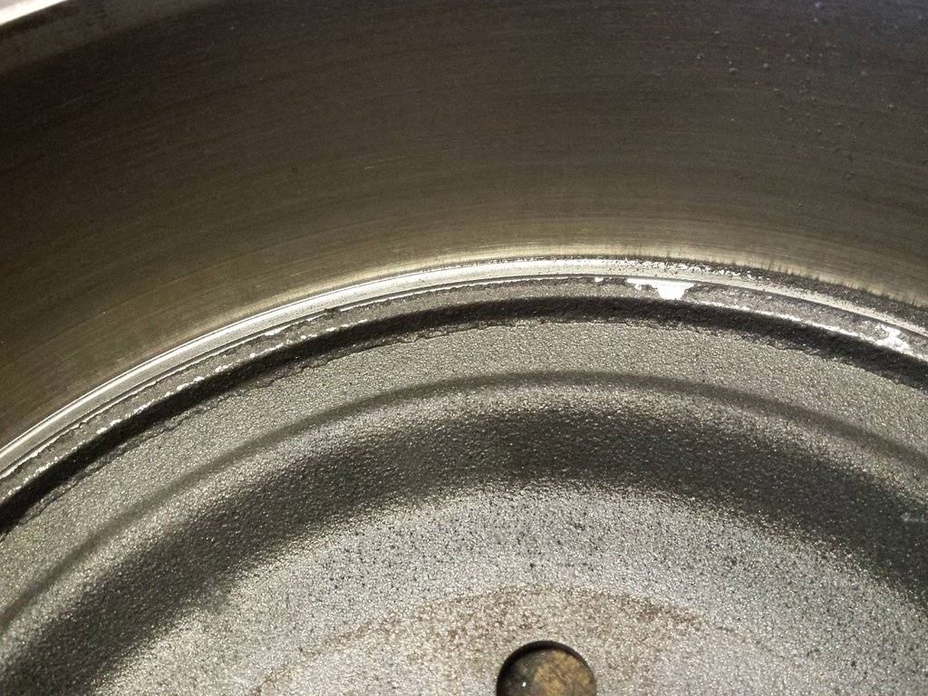

I think I figured out the rubbing / scraping when hard braking. The pass rear Chinesium drum has some flash that is being rubbed off by the shoe frames (bright spots) so i went around the entire lip and ground the flash off.

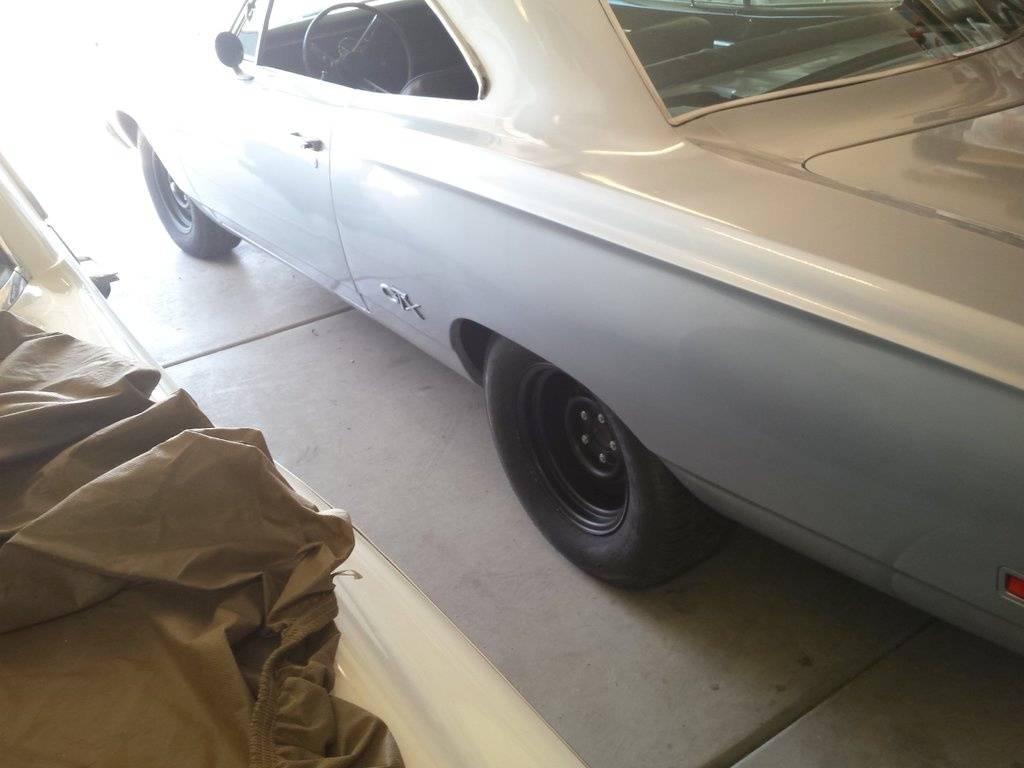

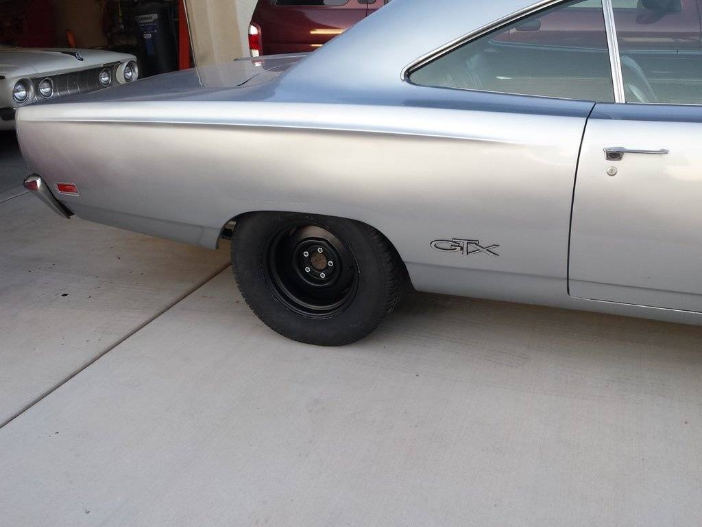

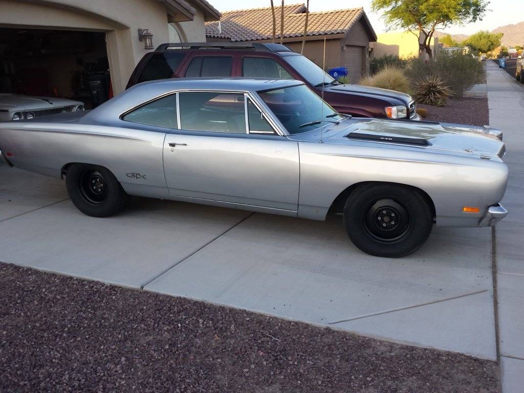

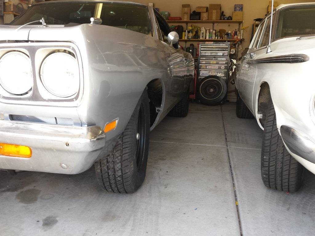

And I got my wheels and tires!! Just perfect. The rears still have plenty more room but the 275/60R15s fill it up nicely. I had to drop my front end down a bit to stay within the specifications of factory ride height. I may pull it out later this evening but it is about one hundred and hell degrees right now.
Looks all business! I am not usually a huge silver fan, but your combo with the black wheels looks bitchin'
Approved!
