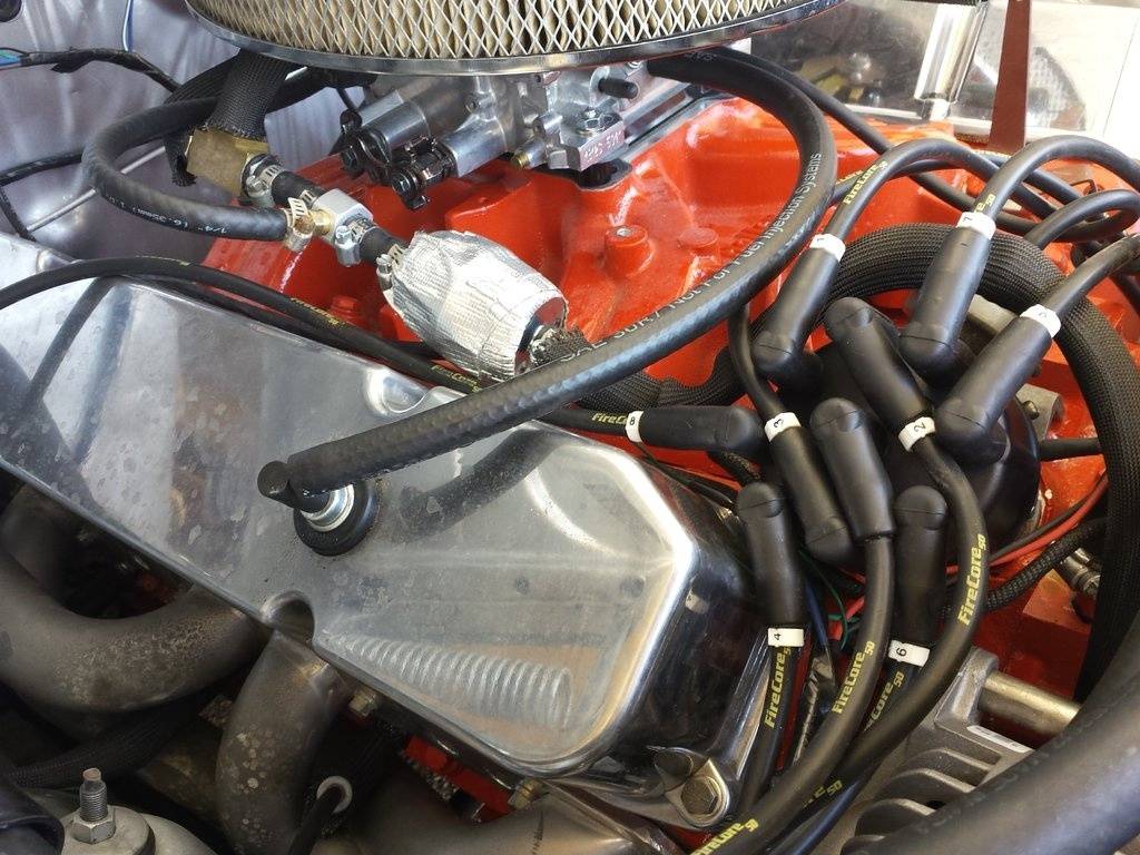

Slight update. Back from vacation. Pulled the carb off and ran temp sheathing down the fuel line to the pump. I took the carb top off and one of the floats was not set up correctly so I adjusted it per the manual. While I was in it I upped the secondary jets and used the next step up rod for the primary just to see how it reacts up top.
I have the fuel gauge and fittings so it should be ready to drive and test tomorrow.
I have it all hooked up and ready to go. I fired it up and at idle the fuel is a rock steady 7psi which is pushing the limits of the carb. I believe 6.5psi max is called for in the manual and it does smell a bit rich at the tailpipe. Maybe pushing past the float?
I also rotated the needle covers over and observed the step down operation. Both are pulled down tight at idle and they pop up when revved. Should be good. Road test is next although it is a cool 103 today so we shall see.
You can see the psi gauge tee and the fuel line sleeve.
