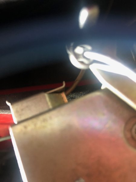

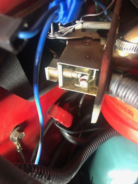

is it hard removing under the dash,he said remove the screws for the coil wire,then remove the screws from dash control lever,sounds easy.

There is a cable that attaches to it.
Single screw clamp releases that.

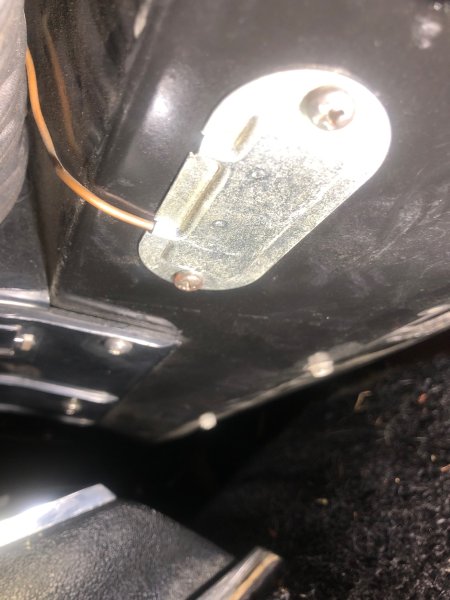

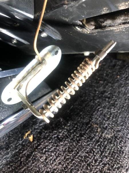

There is a capillary tube that attaches to the bottom side of the box itself.
Take the capillary tube loose.

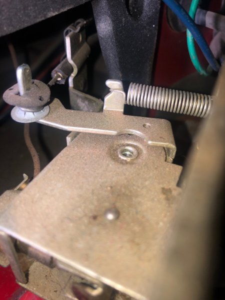

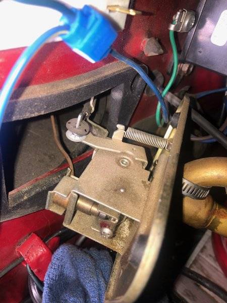

Puĺ the valve away from the firewall just enough to remove the cable on the backside.
Then slowly / carefully remove the assy from engine compartment side.
Helps to have someone inside the car to guide said tube.
Be careful it can break easily

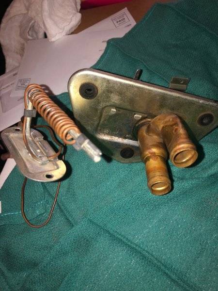

AC cars have a valve like so on the firewall ( pictured )
the 66-67 Valve look near identical externally in appearance to the 68-69 valve,, But the operation is opposite of one another ,,
So they do NOT interchange
1970 Valve is a one year only version

Ok I carefully peeled back valve carefully,took lock washer of cable holder,so for the coil wire do I unscrew screw a little?will the coil wire release?thanks bud

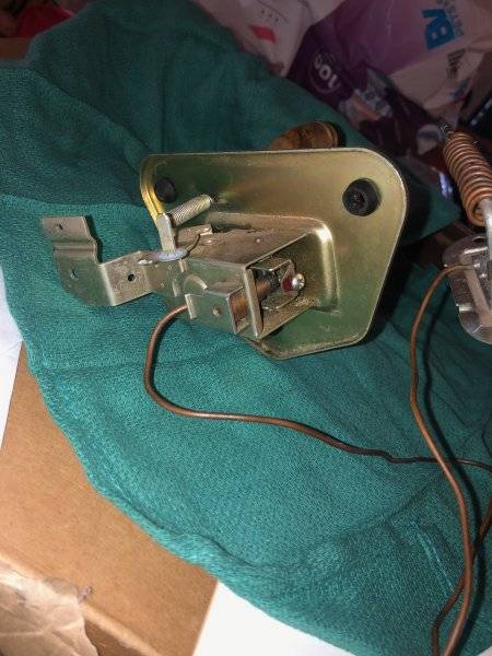

Got her out,alittle squeezed action going on ,from the top tube,,it was like that already .off to Joe heatervalves.net,,I want to thank everyone at fbbo,for knowledge and guidance.and thank you fbbo forum.
