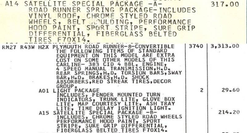

Here's the comparison of A14 and A15 packages for Satellites and Road Runners from window stickers.
Please remember the RM27 would come standard with the belt molding so that's why it's not listed in the package.

Nosin' around and found a nice example that clearly has 2-speed wiper motor/no J25, so that was erroneous. The window stickers show power steering likely not a part of the package either even though this particular car happens to have it.

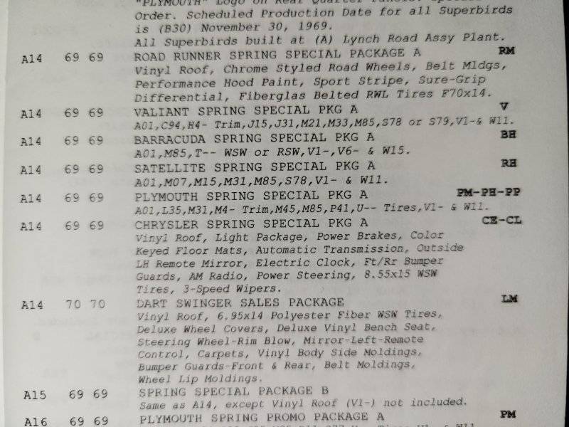

As described above, the A14 package is different for each model. Photo of Production Option Code Book listing for A14 and A15.

What was included in certain packages can vary by by make, model and body style so sometimes we have to drill down to get the details as to the topic.
While the glove box lock was included in, say, the Dart A01 package, it was not included in the Satellite A01 package.
I would venture to say that MOST of the online or published sources do not get into the necessary detail required to explain this so our, as usual, best source for accurate information is typically factory documents like window stickers or order sheets.
