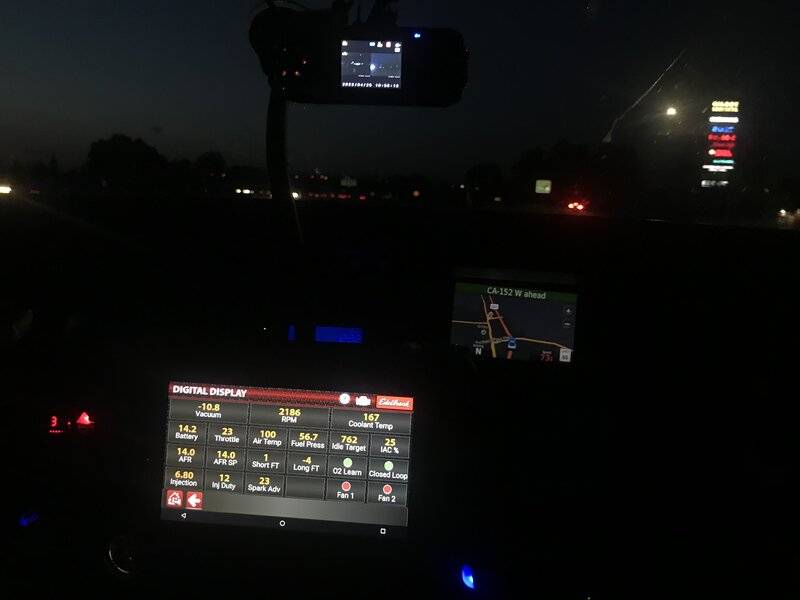

My recipe. Hayden clutch fan, 26” stock radiator, 180 Stant, green conventional coolant. Highway cool. Hot day in traffic creeps to 205. Edelbrock EFI.
. tired, but warmed up 440. Sea level.
My recipe. Hayden clutch fan, 26” stock radiator, 180 Stant, green conventional coolant. Highway cool. Hot day in traffic creeps to 205. Edelbrock EFI. View attachment 1282517. tired, but warmed up 440. Sea level.
