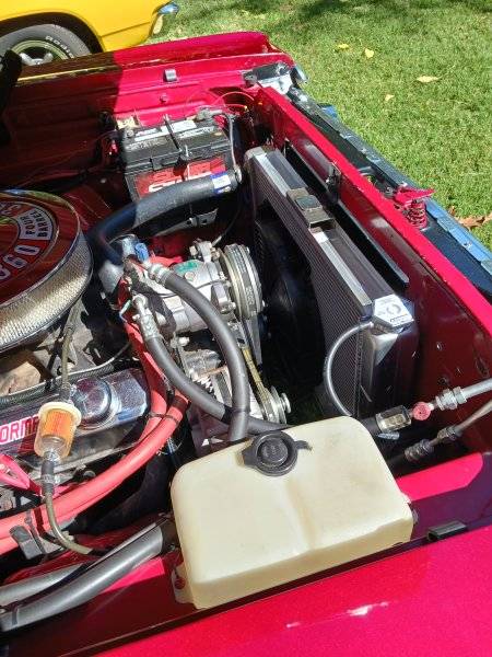

The fans on my charger never run going down the road. It has a cheap eBay 22" aluminum radiator.
We built this one with the Summit cross flow.451 big block using the factory clutch fan, no shroud. Worked fine.
