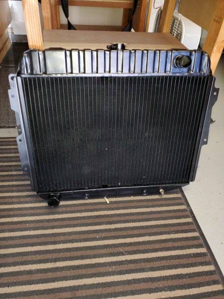

Hello Everyone, here is the latest update on my radiator problems.
Tom's Radiator called me Thursday last week with 3 options:
1. $295: Disassemble complete, clean out all old solder joints, bead blast all components, re-assemble using my original core, solder back together, pressure test, re-paint.
2. $750: Same as above, but using brand new Standard Cooling 4 Row Core.
3. $850: Same as above, but using brand new High Efficiency Cooling 4 Row Core.
My original core is in pristine condition, so I am going with Option # 1.
The radiator will be ready this week for pick-up, I will install this coming weekend, and I'm back on the road again !!
Thanks for listening and commenting on this post, appreciate all the input.
Here is the link to Tom's Radiator if anyone is interested, PIC of business card too.
Auto Repairs | Orange, CA | Tom's Radiator & Air Conditioning

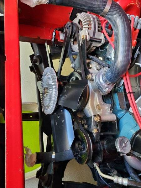

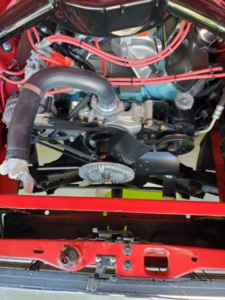

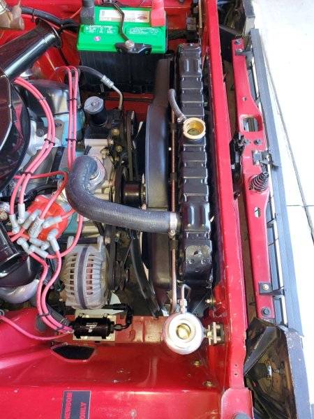

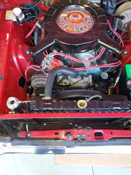

Installed the new radiator this past weekend, and took a nice test drive for about an hour, no leaks !!
Radiator looks good, and works perfect.
I did new coolant, new upper and lower hoses (although I didn't need too),
a new thermostat (probably didn't need that either), (2) new 13 # radiator caps, and new drain petcock.
I'm now at 175 - 180 on the temp gauge, used to be around 185 - 190.
(although it was a cool day, temps in the 60's here for the test drive, we'll see what happens when it's a CA hot summer day)
I'm very happy with the quality of the rebuild, and highly recommend Tom's Radiator in Orange, CA, if you need radiator or heater core help.
Thanks for all the comments guys and gals, much appreciated, and happy driving to you !!
PIC's are : (1) New radiator, (2) no radiator in car waiting for new one, (2) after installation and Happy Time...No Leaky !!!
See ya everyone !!!
