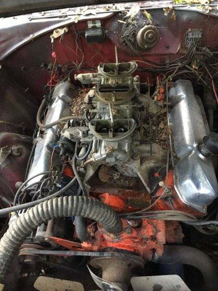

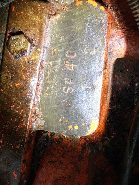

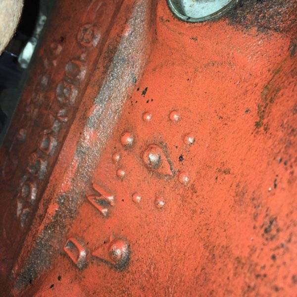

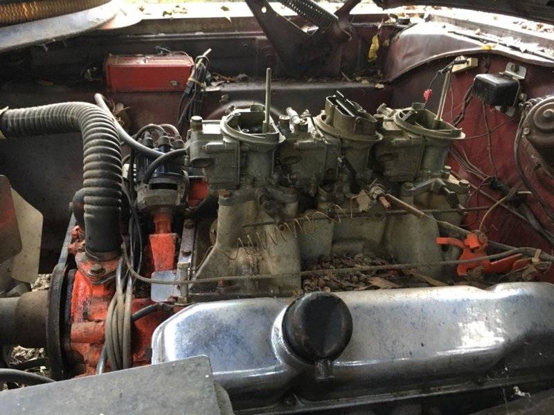

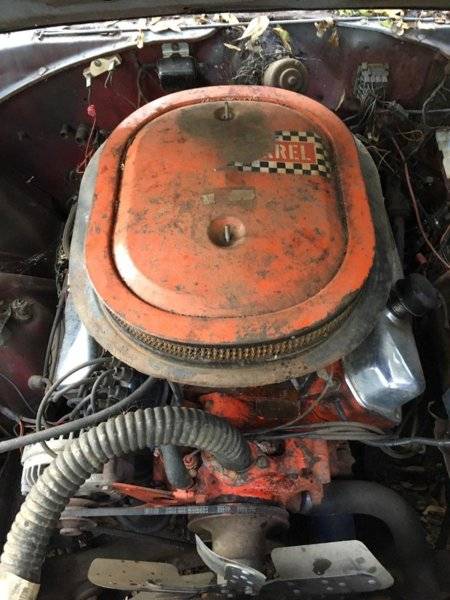

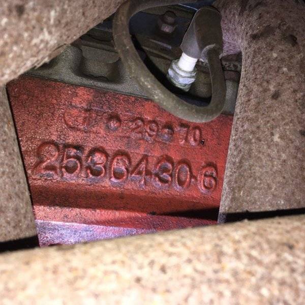

Update on the 1969 Road Runner. My oldest son and I was given permission to do a real good assessment of the car. We brought a floor jack and lifted the car. Trunk extensions are good, still not able to open trunk (no key), lower quarters has some bondo over usual rust areas, middle and upper quarters good. Rust in the lower corners of the doors.Passenger fender bondo in lower area. Floor pan has a old homemade patch over a 1 inch diameter hole, some surface rust but not to bad. Frame rails are all good. Inner fender wells on the front are good. We were told the reason the fender tag was missing was due to an accident and replaced with a salvage fender. OK, for you number guys, attached is some pictures of the engine numbers, some input from the experts will be appreciated. The engine has a small damper as a six pack should, date code correct on block, six pack carbs and intake are correct part number. We were surprised to see it has a Dana 60 rear end. Was told the drive train was installed about 25 years ago from a yellow totaled out car, info from a family friend. With the type air cleaner it has will help ID the donor car. Overall we feel the car has good potential with the body being in better shape than expected. VIN number RM21H shows it was a 383 car. Some of the previous commentators has thrown the towel in on this Mopar, however these cars are getting scarce we believe we have a chance to save another one for the next generation (my 25 year old)

What's above is good advice....just to be sure, I'd double check dash VIN vs. radiator core support VIN vs. trunk lip VIN. It's almost for sure what it seems...a 383 car with a 440 six pack. The car is not original, is not an original six pack car, is #5 condition vs. Barrett Jackson #1/#2 condition, etc. + it's not a real six pack or hemi car.....so above prices seem about right...it will cost a ton to restore.
Having said all that, I like the car. You should be able to look at the flat pad, front of engine block, driver's side front corner & see "440" + a letter or other stuff. That info would help. Also, get a flexible mirror on an antennae and look on the side of the engine block, under the exhaust manifold (I "think" driver's side) and you should see a date cast into the block...eg 6-13-69 or something like that. That would tell you the manufacturing date of the engine.
'69 440 six pack motors have small rods & are internally balanced.....so.....the harmonic balancer should be thin (1"'ish) and be symmetrical (no offset weights at all). '69 six pack motors should have aluminum intakes too.
This is "most likely" a 440 of some random year with a six pack carb/intake put on it.....still very, very cool.

OK, well I agree that dash VIN = radiator core support VIN is a really good sign & would be enough for me too (though I'd check the trunk lip). I like the car for sure + have a Dana in it sure the heck doesn't hurt. Your key negotiating tools are that it will take a TON of time/money to get the car looking good & running good and it's a 383 car. Obviously it has a 70 date code & that is a '70 six pack air cleaner...if the harmonic balancer has an offset weight "horseshoe" in the middle, then it might be a real six pack motor??? The 70/71 six packs had the big rods. Regardless, I like the car.

Well, it's looking good, but not yet confirmed 100% since it "could" be a '70 high performance 4-barrel engine with a six pack setup on it. The fact the car has a Dana too is good since it would have been standard equipment on a '70 440 4-speed car (six pack or 4-barrel). I think the drivetrain is worth more than the car.
