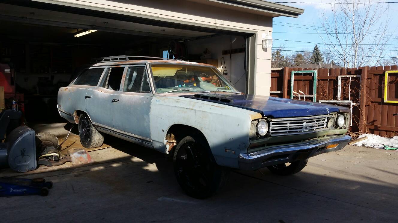

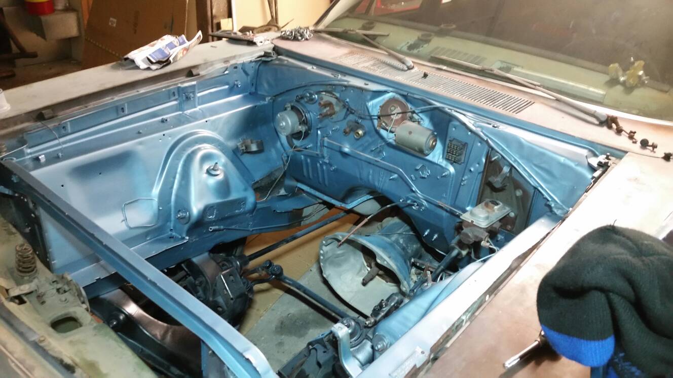

Hope everyone had great Christmas, started to work on the car a bit more. Got the engine bay painted

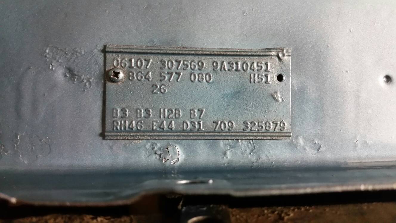

Here's the fender tag

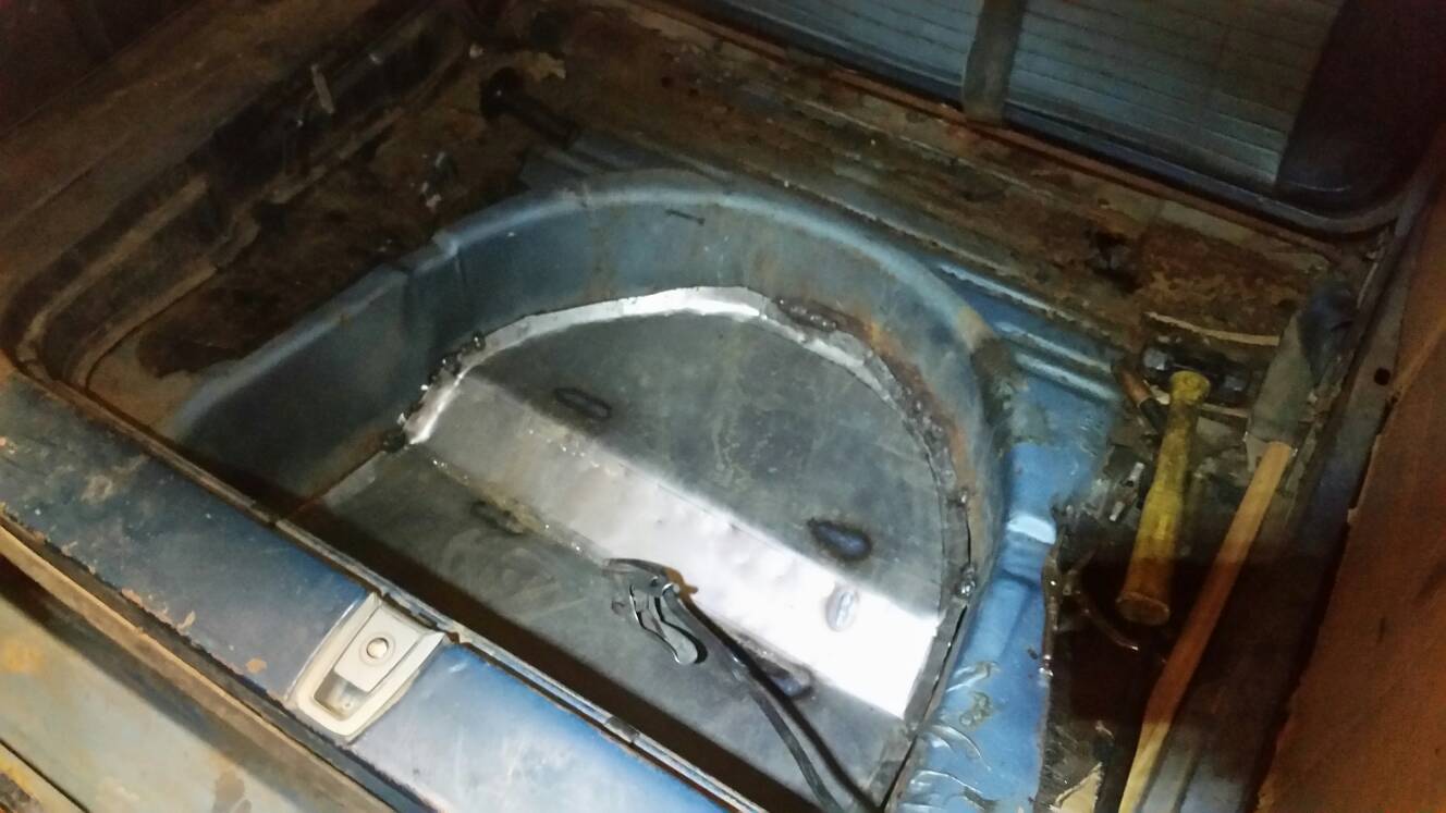

Hello. I am also doing a wagon. 68 Satellite. I think the 66/67 Satellite trunk floor pan is the same or very similar to our third seat area footwell. I have measured one at National Moparts and it looks very very close. Have you looked into that area as well?

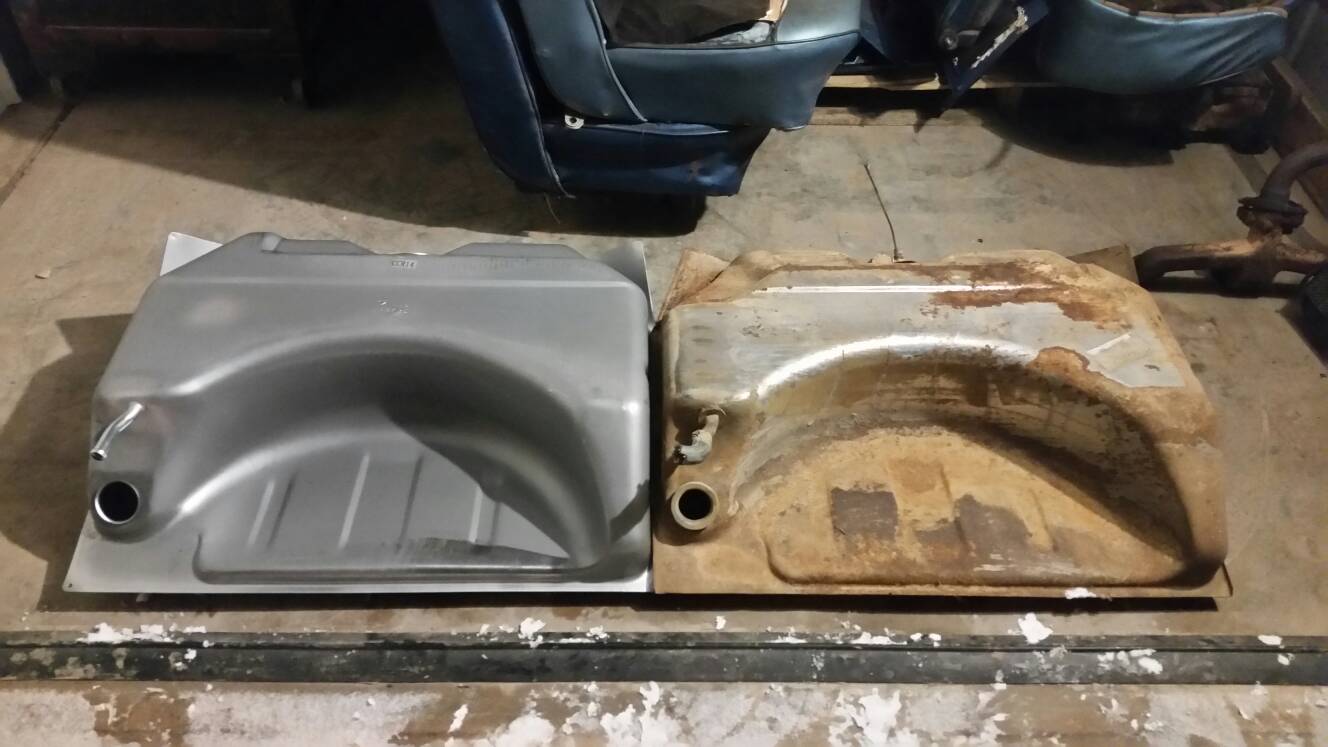

I have not, I built one out sheet metal, I did get a 66-67 gas tank to try.

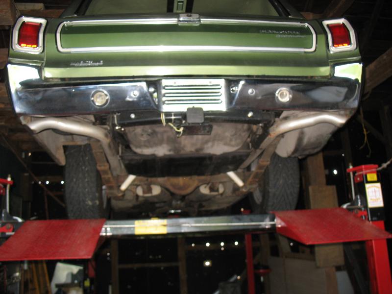

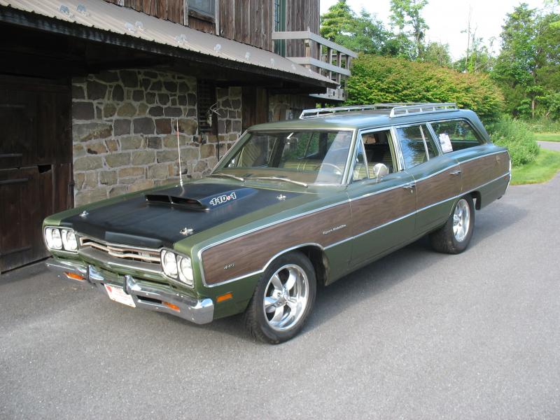

440/4 30 over/ cam hookers tti 2.5' through magna flows. 727, 323 posi.

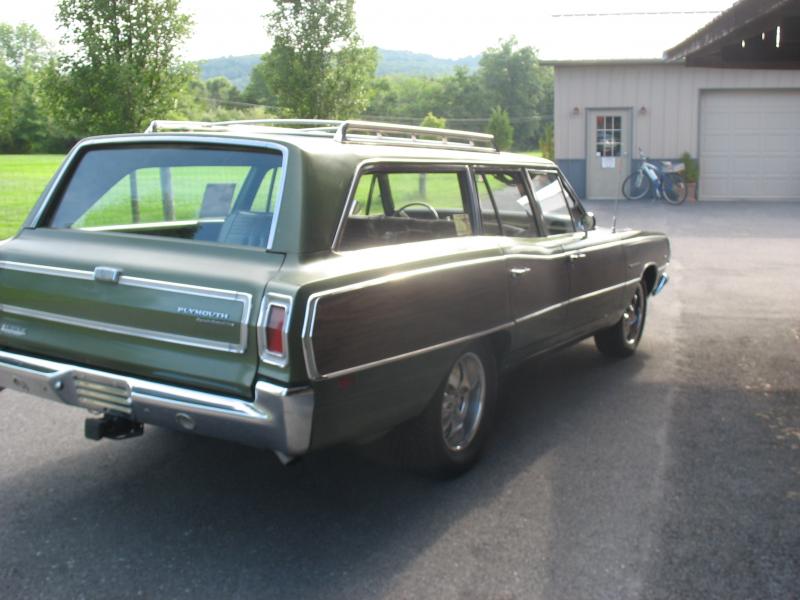

Boyds 17x7 front 17 x 8 rear. 9 passanger, 55k miles rust free body with power front seat and rear window.IMG_6412.jpgIMG_6429.jpgIMG_6441.jpg

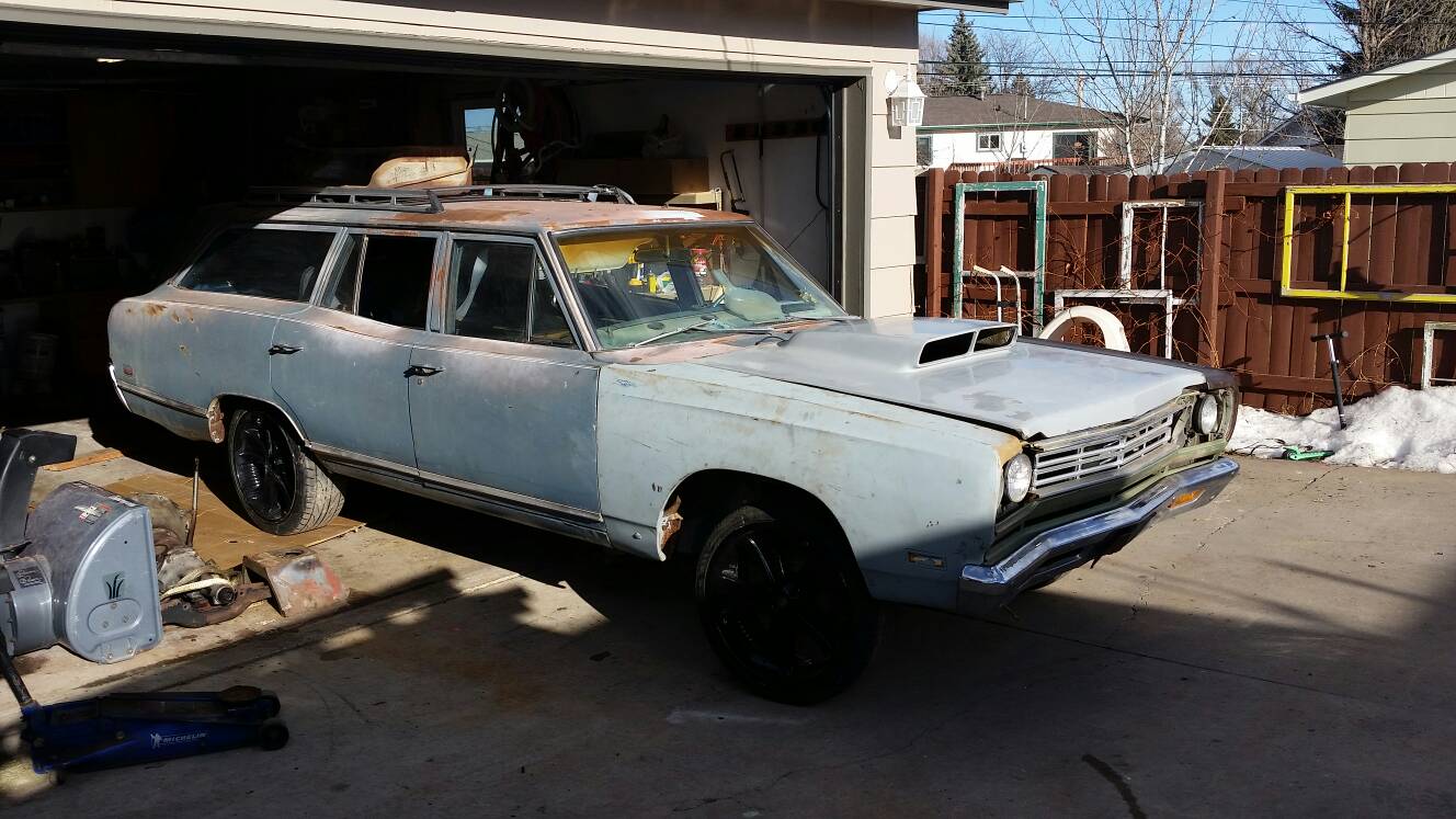

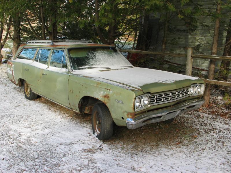

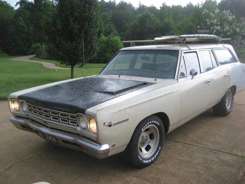

My 68 Satellite 9 passenger wagon 318 three on the tree. Hope to start the rat rod resto next summer. Leaving the exterior as is. Weld in new rear floor pan and patch quarter. All new clean red interior.
That was the gas tank I was planning on using. Let us know if it works for you and give us some more updates 66dart on your project.

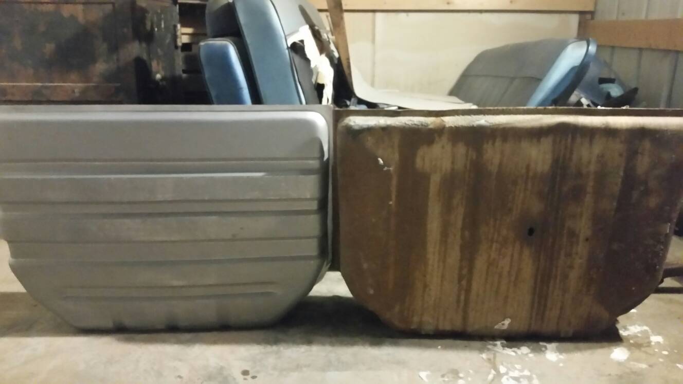

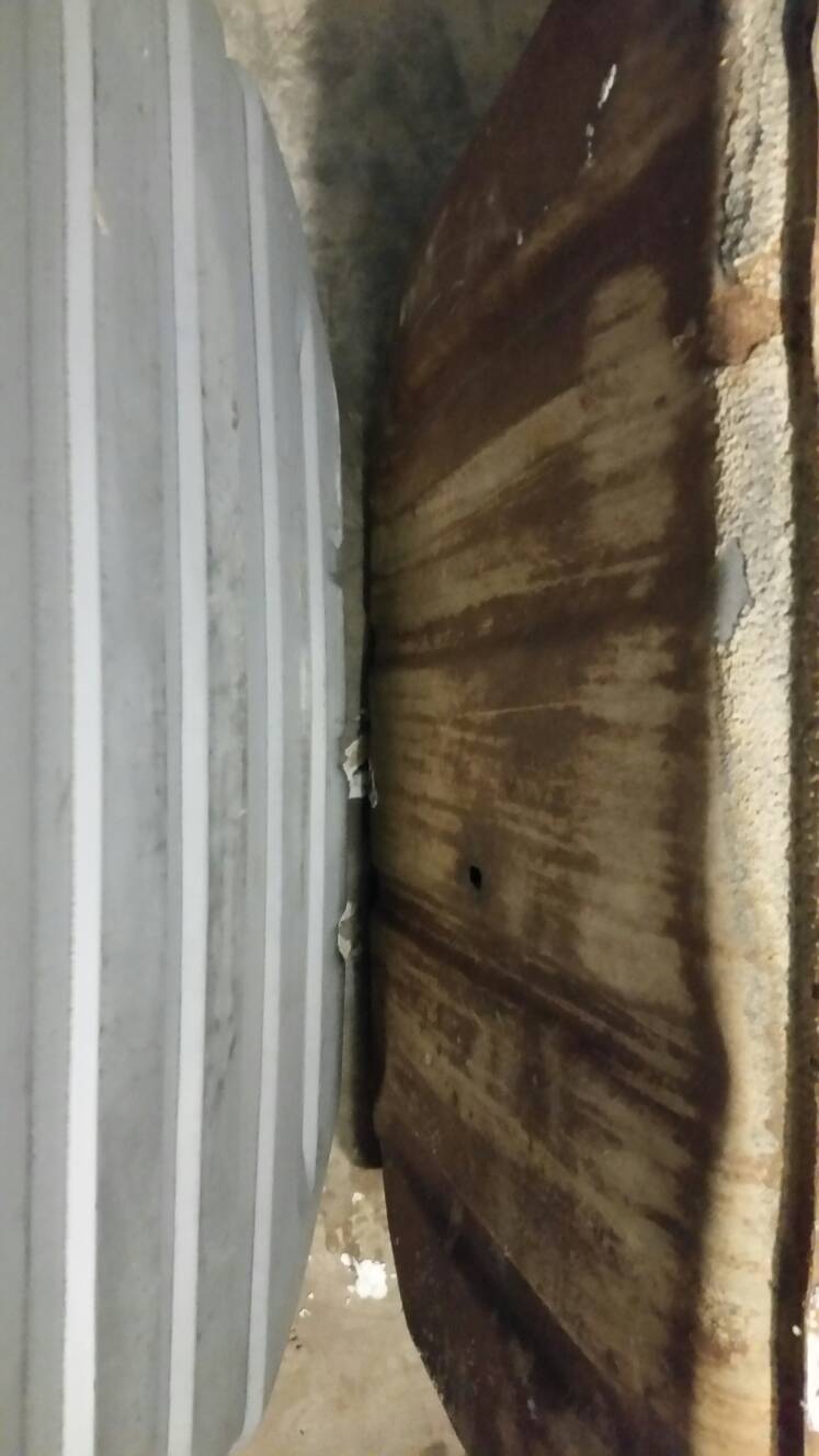

Gas Tank update! Got my 66-67 B-Body gas tank today! They are almost identical, the only thing I see is the ribs in the tank going the other way, but the worst part is the straps that go front to rear are off about 1/2" off from the orginal. Hopefully there is enough wiggle room to fix that more to come...

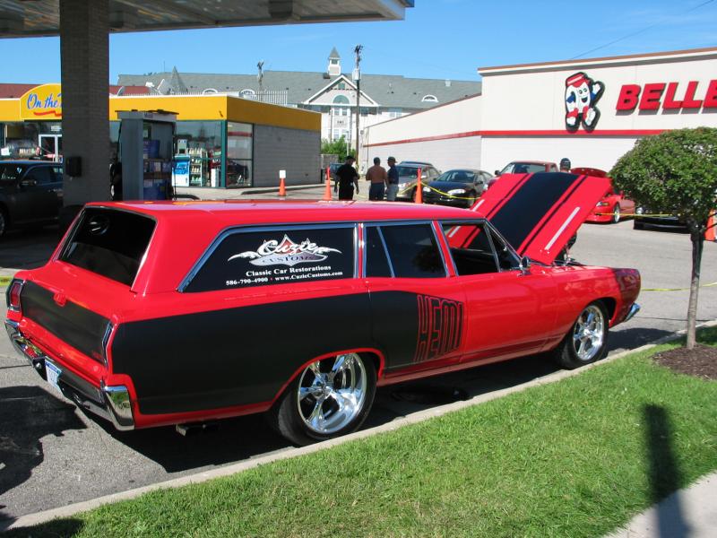

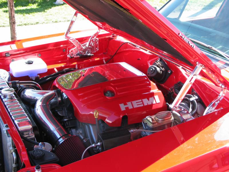

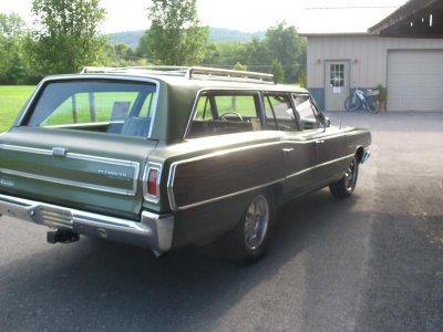

Great build. Looking forward to the updates. Will prove helpful to us fellow wagon restorers. See photos of a hemi wagon shot at the Woodward Dream Cruise.IMG_5051.jpg
