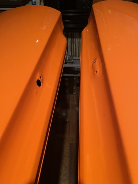

That's just someone tightening the mirror up with an air gun! While my left door is now an AMD, the right is original and so is my damaged left stuffed in the corner. None have a dimple. My passenger door was swollen at the stud hole from overtightening and we fixed it. Zero dimple on any doors... or my Bee.. or my HP2.. or the Dart.. lol
Consider that the right mirror is an option. Nobody was dimpling some doors and not others based on the broadcast sheet as they came down the line.
How many examples of this do you need to see to consider the possibility that some were stamped that way?
Yup, the dimple is caused by people cranking on the mirror hardware...
Sorry Greg, the dimple is stamped but not with a real die.. The mirror acts as a die...
ALL holes - regardless of the panel - are stamped when the panel is still a flat blank. That way all the punches are moving on the same plane. Doesn't matter make or model - its how the stamping process works. Also, a number of holes are locator holes for the rest of the stamping or forming process. As for adding "dimples" ... a total waste of time when manufacturing the die. Neither mirrors non door handles got "dimples".

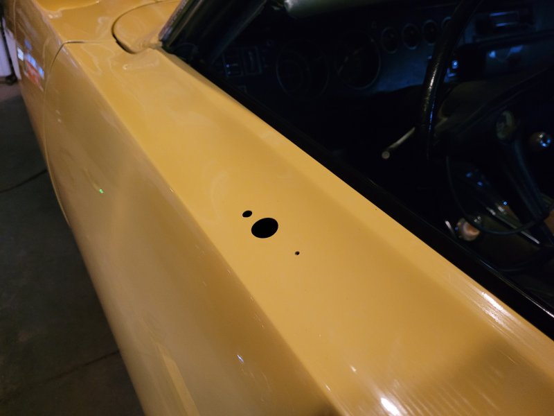

It seems odd that almost every drivers door that I've seen has that "mound" regardless of the overall condition on the door. I'm talking even on original paint doors that had the original mirrors on them or correct replacements. I admit that the stretch is certainly possible from over-tightening but with every door? I have 4 or 5 Charger doors out back that I haven't looked closely at in awhile but now I'm curious.
Dwayne's car has a failing left door mirror, I'll be replacing that soon and surely make note of the shape of the metal:
I guess none of these 50+ year old panels are original anymore so seeing the mound on any of them may still be the result of overtightening....but it has me curious.

I have two different doors for my road runner, they have the same dimple as well. It's a nice rounded dome shape, doesn't look like it was sucked up by over tightening.
