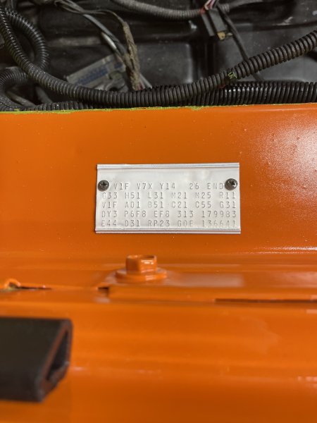

Purchased whole. Have FSM. Don’t have build sheet. Have fender build plate. It didn’t have a mirror on it when I bought it. But it obviously came from the factory with one!Did you buy this car in pieces? Have a FSM? Buildsheet?
Yes this is why I am interested in researching this here with you guys.Exactly.
If the car started out as a patchwork quilt, then build it as you like with whatever mirrors you desire.
If it's a factory correct piece, then you'll need to follow the build sheet/fender tag or sales order information....to do it right.
Ok so add the manual or sport mirror pending the drivers sude. Easy peasy. First Mopar?Purchased whole. Have FSM. Don’t have build sheet. Have fender build plate. The didn’t have a mirror on it when I bought it. But it obviously cMe from the factory with one!
G31 - OS RH Manual Standard MirrorPurchased whole. Have FSM. Don’t have build sheet. Have fender build plate. It didn’t have a mirror on it when I bought it. But it obviously came from the factory with one!
G33 baby! I was trying to find that darn code! Thanks now I know!!G31 - OS RH Manual Standard Mirror
G33 - OS LH Remote Standard Mirror

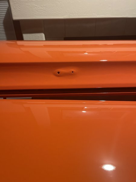

The 69 Coronet had the hole anchors in the passenger door visible from inside the door. No mirror on psgr door from factory. I drilled out the holes, put the mirror on and the wing window bumps it when opening. Can’t explain this, but be careful when installing. If I could do it over, no mirror would be there. Limited use anyway.My 1970 Sport Satellite has the holes in the passenger door for a mirror. What type of mirror was there? I know it was manual. Was that an option or was that standard for the Sport Satellite? I need to find one……
