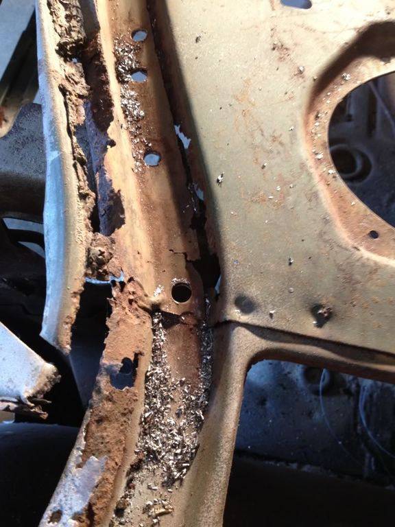

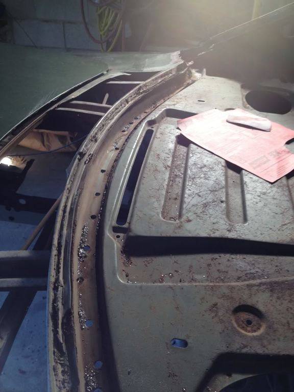

I have just started back on more welding this weekend. Since they don't make full quarters for the 70 at AMD, I have been doing a little stitching at the trunk drip rails before I cut the rest of the panel behind the back window out and the face of the quarter. I don’t want to misshape anything.

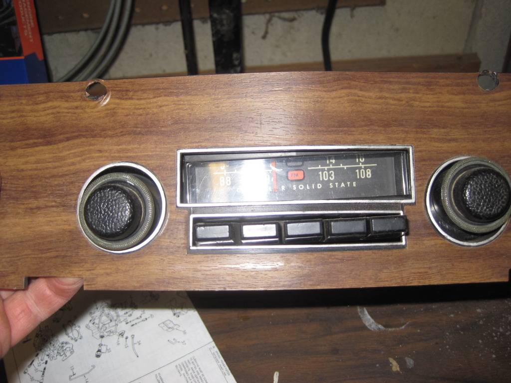

I have been busy collecting parts for the engine and I have put together almost all the interior parts. I could not resist the great deal on the am/fm radio. I have the original AM in a safe place.

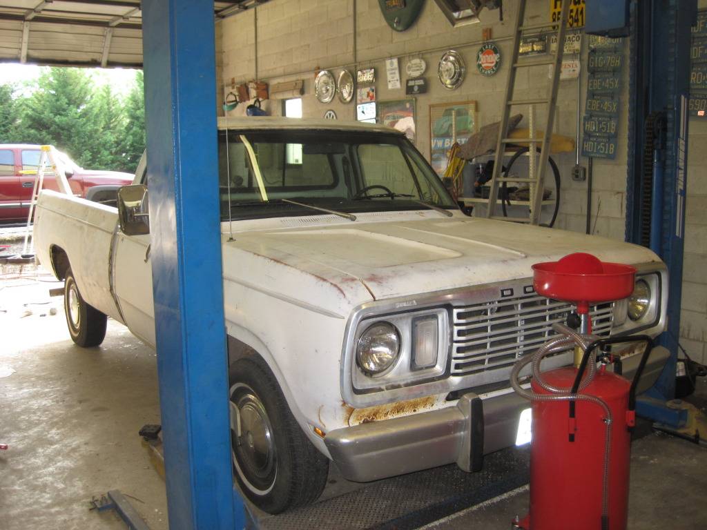

I need to get moving on my R/T. I have been distracted by two non b body cars. A 1952 chieftain coupe(see Picture) that I just got and my late grandfather's 1978 d150 pickup (see picture) that I have been working on for a while.

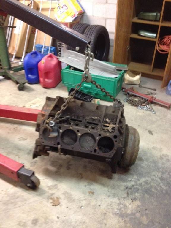

We finally pulled the original block from the 1970 R/T. It was pretty simple since most of the engine was dismantled by the previous owner way back in the early eighties. I have already taken it to my engine builder’s. I am hoping there are no issues with the block. The heads are being replaced with two redone 906 ones with new valves, springs keepers and all that with hardened exhaust seats. These new heads are the same date as the original heads. I think that’s kind of cool. I know not everyone is a date chaser but this just worked out for me. The original heads are beyond repair from sitting in the trunk when it was filled with water.
Looking good, hope your block is ok being it was disassembled should be a good chance at it..finding same date heads good deal, that chieftain looks cool as heck!! good luck..

I am still working on the filler panel. I have to weld quite a bit in order to have a nice base fo the new AMD piece. I drilled out all the spot welds and I have to fabricate the edge of the rear tray. I also purchased the curved piece that goes between the window and tray. so far the AMD stuff fits great.
Thats a nice job on your model there! Hope things go smooth for this job, im a bit Leary of my welding!
