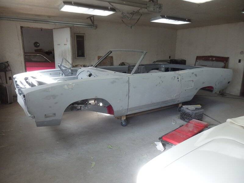

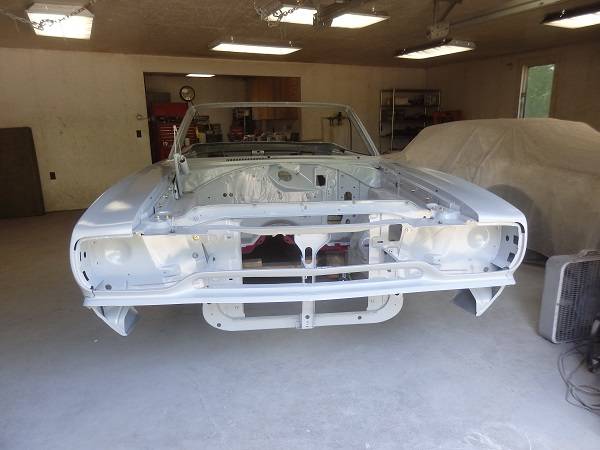

As of 5/30/21. The hardware you see holding the nose together is not correct at this time. Just needed something to put it together with for alignment and preparations for putting the car in slicksand.

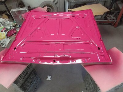

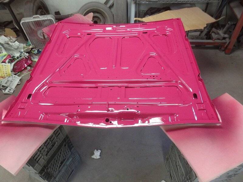

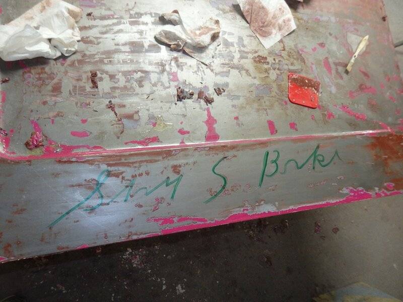

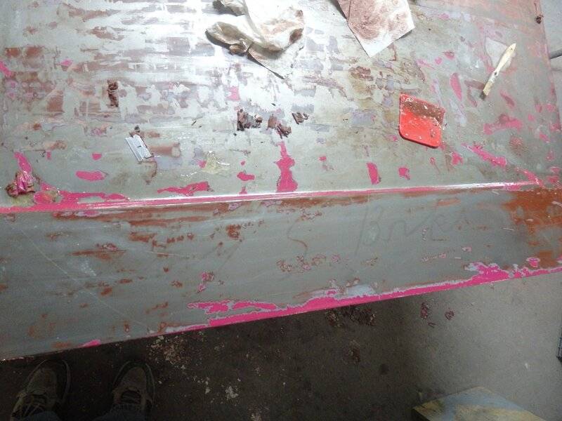

Found these markings under the paint when I stripped the hood. I traced it out to make it more legible. Looks like "8AM S Bake" to me.

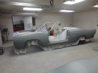

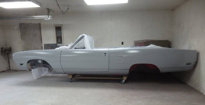

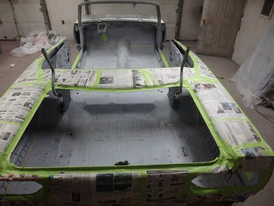

Work is going slow these days. I am finishing up my first round of blocking this week. I'm not sure what others do, but my process is to:
1) get the majority of the filler work done prior to applying the first primer coat, this is done with the car dismantled.
2) prime the entire car in pieces with epoxy primer (this is my first time using SPI primer, I usually use PPG DP40 but it is getting way to pricey),
3) I then put the car together,
4) fix the panels gaps as needed,
5) block the whole car with 180, fix the small defects that appear during this process.
6) prime it again. Some people may decide to consider this to be the last primer step before painting, but the next steps really even out the panels relative to each other.
7) apply 3 coats of Slicksand and a dusting of guide coat,
8) block it again with 180
9) apply final primer coat
10) sand with 600
11) and paint away.
today I am on step 5.

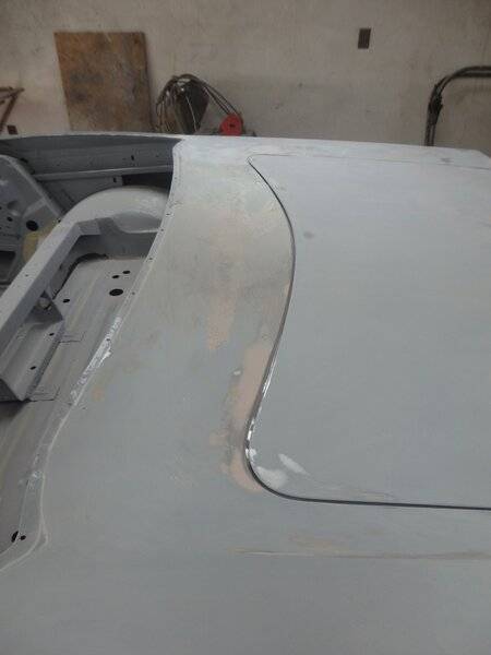

It took me some time to get the trunk lid gaps the way a like them. I think it will turn out really nice.

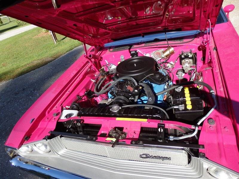

Awesome car, awesome project ! Do you have the original drivetrain ? You CAN build a relatively healthy 318 (or 360) with a stock outside appearance, albeit with a 4-bbl intake, which is more easily swapped back to the stock 2-bbl than a complete drivetrain.
I have an 318 FM3 Challenger that's is all original, so I really would like to show them as a matching pair. So definitely 318 2bbl on the outside.
I moved North 5 years ago and don't know many car guys, but went to look at a beater W150 a week or so ago and the guy was a local Mopar guy. Told me about some amazing local area cars and one of them was a FM3 70 Hemi challenger that was originally from this area, it's now owned by a woman in WA state.

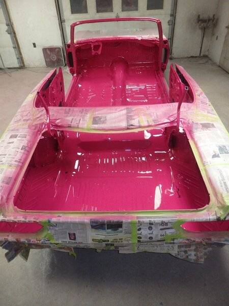

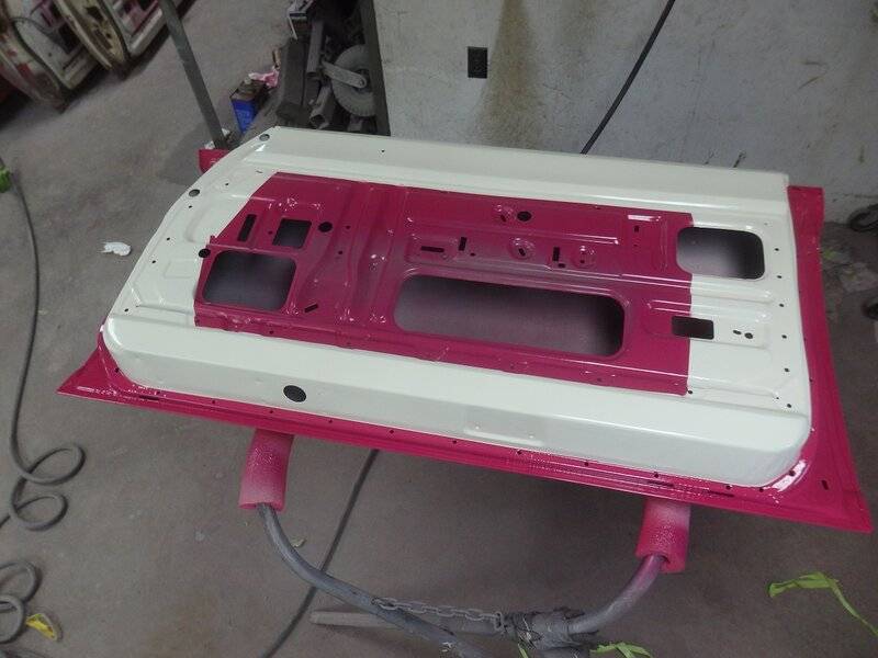

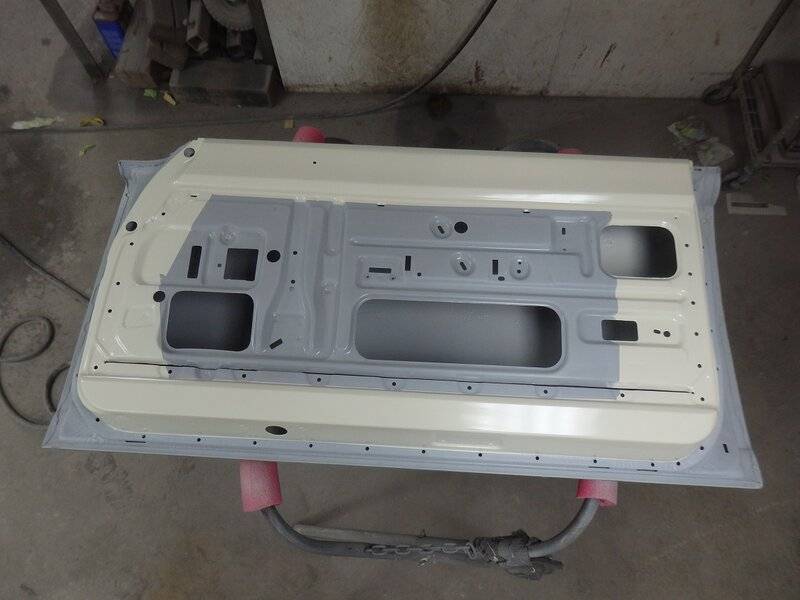

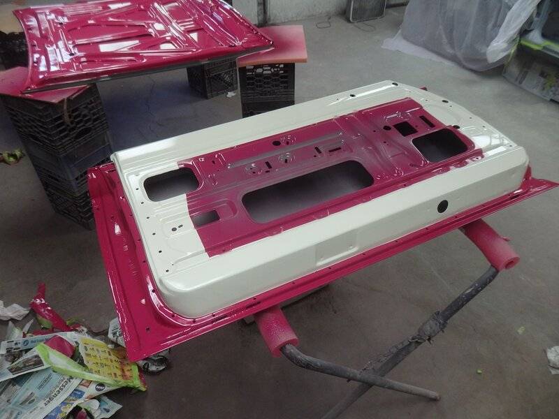

Well it's in final primer. All I need to do now is sand it and put it in color. I've already painted the inside faces of the doors in white and will be spraying the FM3 on the insides of the panels this weekend.
View attachment 1125222 View attachment 1125223
If that is original trunk lid then you may be ok. Think mine was a donor so had to shave down my corners where the dutch mans panel is. Then weld it back up. Looking good. Yep lot and lots of time blocking and filling. Your on the right track.
