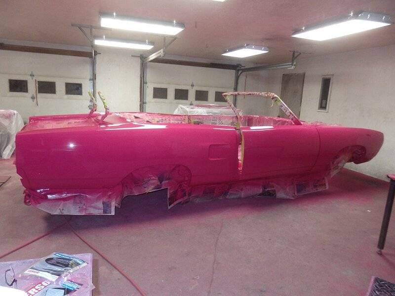

That really is something seeing all that pink. Now I kinda know what it's like being a Gynecologist.
Can't wait to see this car finished. Only Ma Made a Pink car look cool.
Congratulations on a long and difficult rebuild. That is real dedication. In 1970, I was driving my Sunfire Yellow SuperBee at a popular lakeside summer resort town when I saw my first FM3 Mopar. It was a 1970 Road Runner coupe. My first thought was, "Wow, that is a lot of pink!" .

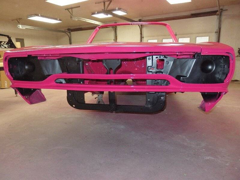

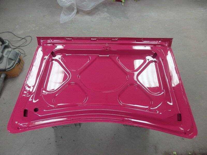

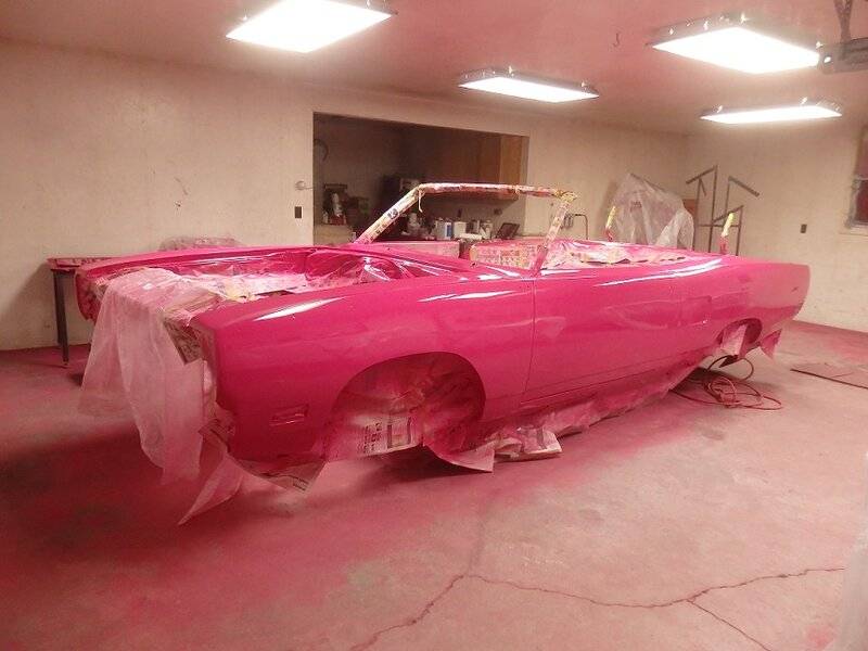

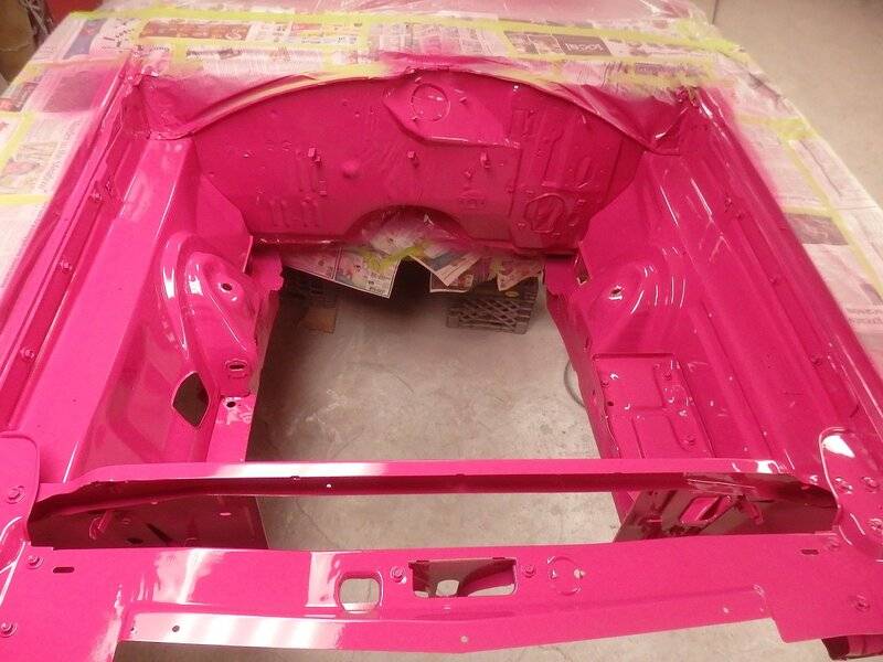

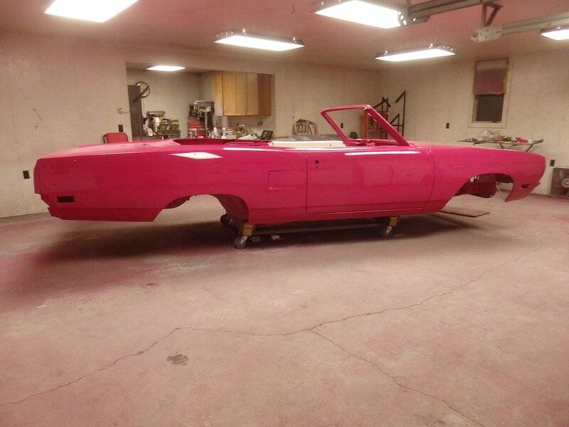

Engine bay and underside of trunk lid are now in color. Time to sand and paint the outside!
That is actually worse than what I started with. I very much appreciate what you did there.

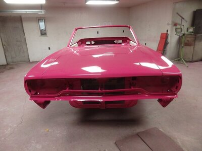

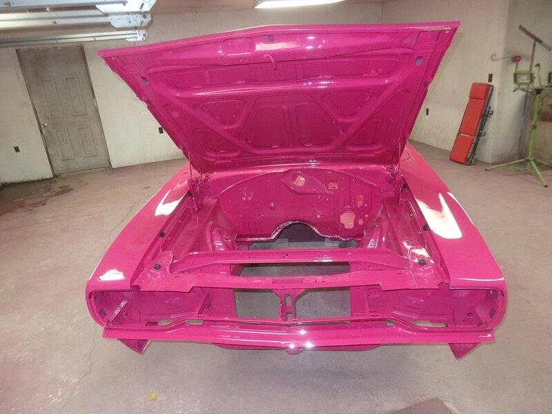

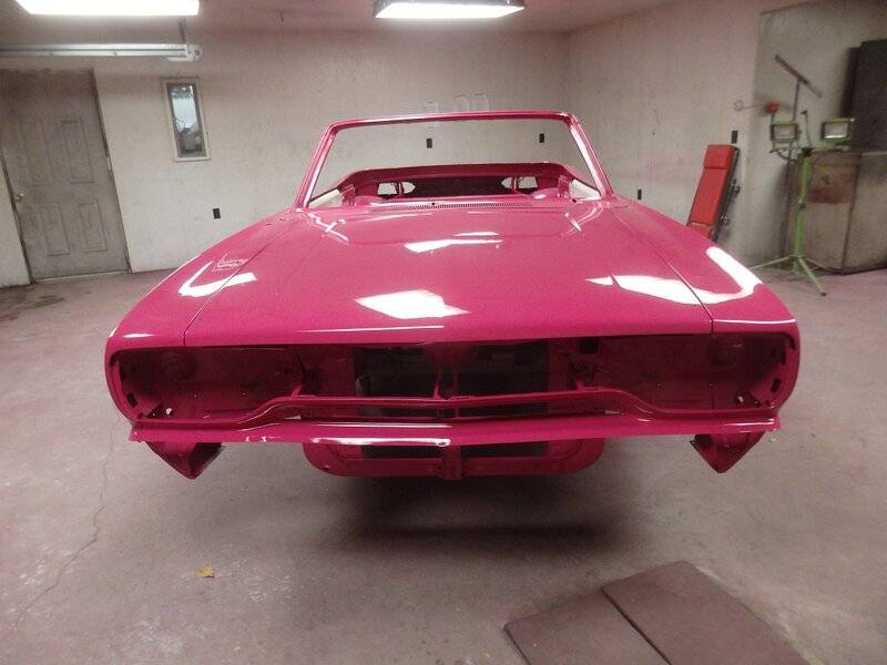

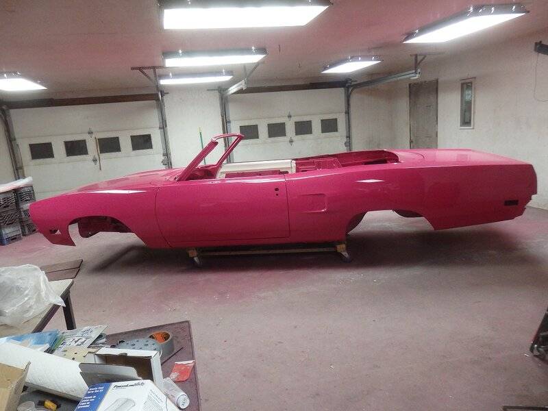

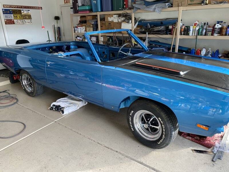

Update 11/3/2021: Sanding & Buffing is done.
My sanding process is blocking with 1500 by hand in conjunction with 1500 trizact disks, then 3000 trizact disks and finally 5000 trizact disks. This process took me about 16 hours with 1500 taking the most time.
Buffing was done using the 3M Perfect-It 1-2-3 compounds. This process took me about 8 hours.
With the trunklid and hood re-installed the next step is radiator support blackout.

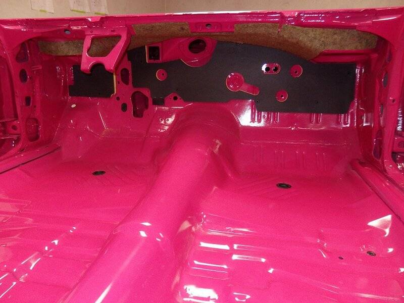

Firewall pad and insulation is installed. I ended up painting the insulation like Moparnation74 did on his 69 GTX as the insulation only comes in gray. The repo firewall pad wasn't quite correct. there is a flap by the steering column opening that I had to transfer over from the original pad. the repo just had a piece of cardboard hanging down.

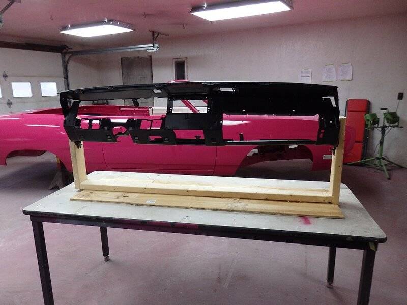

I painted the dash frame in the correct black suede lacquer paint from Instrument specialties. Then I build a nice assembly stand for it.

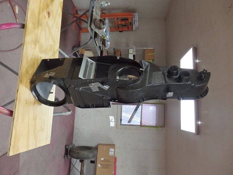

The fiberglass on the original heater box was disintegrating, so I bought I box to restore from a member here. In the last picture the fiberglass is cleaned up and I bead blasted and painted the metal pieces that couldn't be removed from the box. more to come as I get stuff restored and installed.
