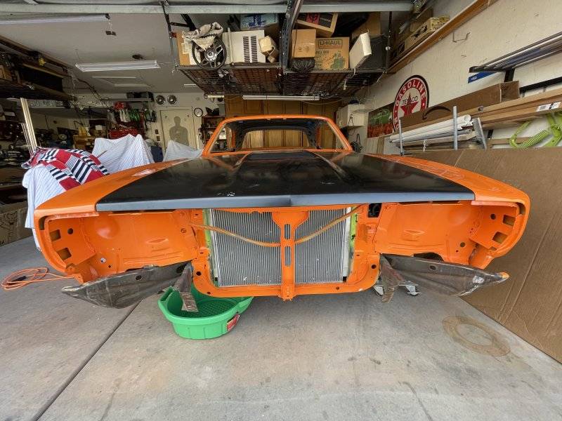

So I’ve been working to lower my air cleaner to get enough clearance to my new air grabber hood. I ended up removing my carburetor spacer used to provide vacuum to the PCV. That was enough to clear as I was able to mock up finally with the hood in place. One can see the hinge in a full down position in which it will not be at. It will be up at about 2 Oclock. So there will be about 1/2 to 3/4 inch clearance. I would like a bit more and I might swap the high rise manifold to give more clearance but right now I know I have a workable situation. And yes I ordered my Air Grabber door decals lol!

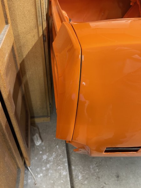

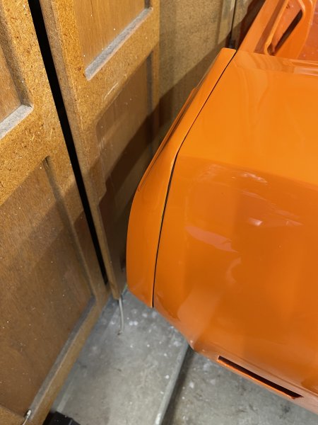

Hood fitment is really good. I have all new rubber hood mount hardware in place.

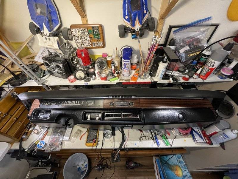

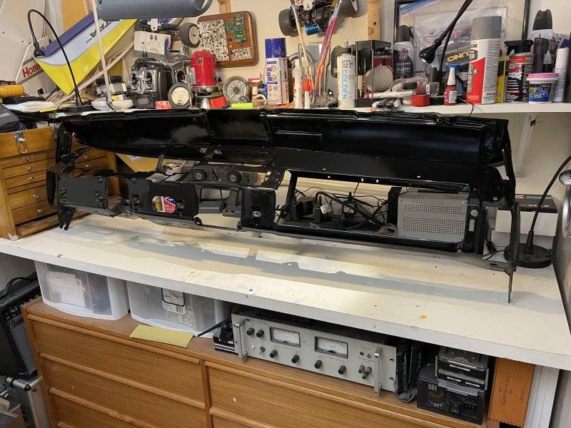

Been too hot to want to spend much time in the garage here in Phoenix. Starting to gather my parts and brains for the dash assembly. I’ll need to make the AMETER modification as mine is stick and functional but not super comfortable with all that current flowing through that part. Not sure what I’ll do so if anyone has any good suggestions feel free to chime in.

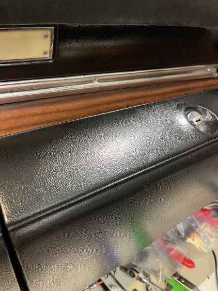

Dash pad restoration complete.
Done except for the ash tray cover (as its drying) and the radio knobs. This was a green dash…. As it is right now its bone stock with essentially a new wire harness. I’ll figure out what to do with the charging circuit upgrade soon.

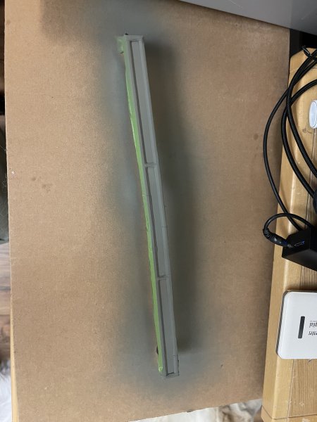

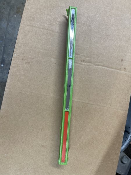

The stock emblem had most of the paint missing. It’s a chrome plated part that is painted. Not a good idea for longevity but then again it’s not plastic! Not easy to mask prime and paint with automotive paint base and clear.

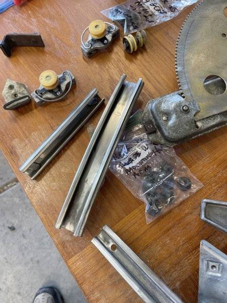

On to the rear quarter windows. I am going to have a lot of questions and I am sure there will be much cussing floating out of the garage. Cleaning the mechanisms now and digging up old pictures and docs as I am clueless as how to assemble these lol.
