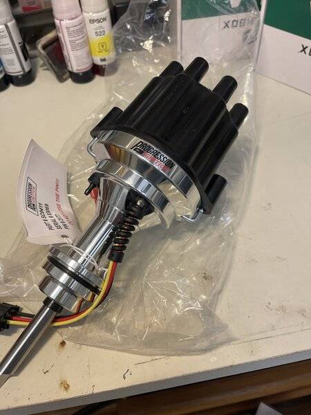

Currently in process is the installation of the Progression Distributor. Because I am working with an evolving engine (later to get a new cam and torque converter and other goodies pending my lotto status) I need a way to tailor my curve without committing suicide. My wife thought that being able to change entire curve on the fly might be a good thing…..I agreed.
Currently installed just need to figure out where 1V drop is in my Ignition source. I may run a relay.

Well I installed a Progression Distributor because I was having a hard time tuning the motor and torque converter combination. This wasn’t in the plan since I purchased a new MSD billet Distributor MSD6AL and remote variable timing control unit.
I have to say I don’t think it would have been possible to tune this set up without it. I now have a decent idle and a slight drop of a 150 - 200 RPM idle from in gear to out of gear. The transition is actually surprisingly smooth. The carb is now well tuned for idle and behaves well on the road. This Progression Distributor made this job actually fun. You can change the timing anywhere on the fly in a non linear way if needed. Balancing the timing the main throttle, secondary throttle and mixture was needed. Very surprised but pleased at the result.

Thank you. Yes the Progression Distributor/Ignition system enables me to bump the timing at such small intervals I am able to finally tune for a really comparable idle both in and out of gear at idle. Can’t do this with any other ignition system that I am aware of. Really pleased so far with it.

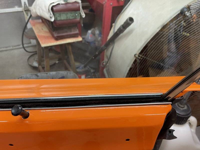

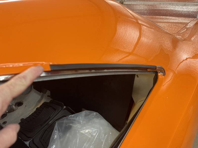

All the door seals are in as well as whiskers. It’s certainly the process. Door seals use the integrated plastic clips no adhesive. The roof rail seal also doesn’t use adhesive. The trunk seal does use adhesive and using contact cement makes it a very effective way to attach.
