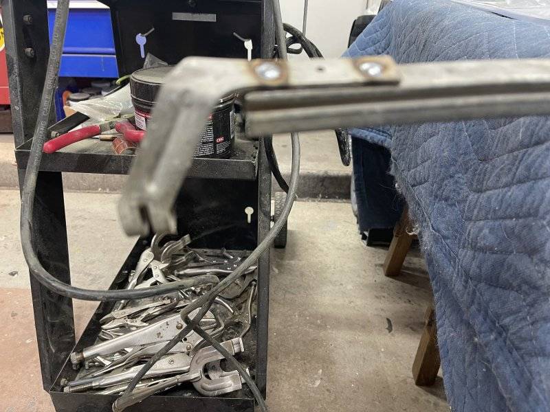

The help on this forum has been great and very much appreciated! Starting on the windows. The lower support seems to break the crap weld the factory used. Well I know they were never designed to last 55 years but consistent failures of two point welds tells me their process wasn’t right. Anyways the support bracket is now firmly welded in.

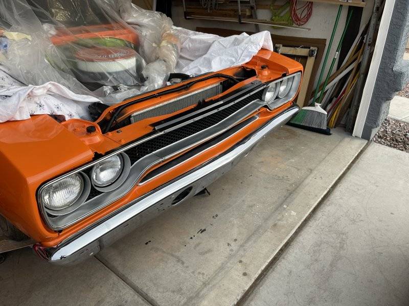

Working window channel slider issues (more on that later) while doing other stuff. One such task is front end grill alignment . I now have it assembled and it shows significant need of adjustment and tweaking. 50 year old plastic parts along with a minor front fender bender will take some time to make this look a lot better. Also missing quite a bit of chrome that will fill many of the voids seen.
Meantime the window and engine preparation are on the priority list!

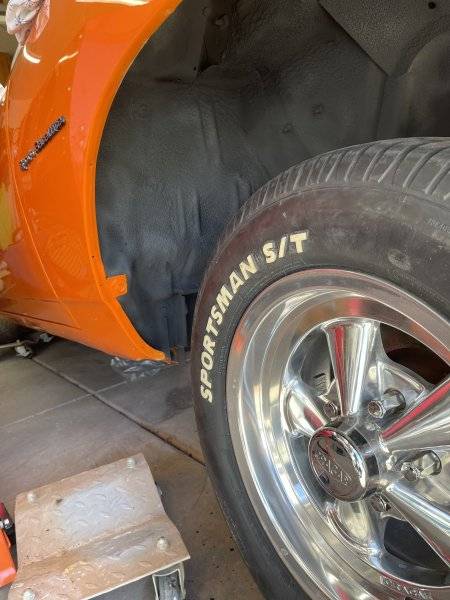

Hot wheels (and wheel wells)….

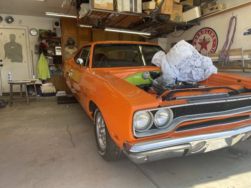

Getting close. Interior change over to white, and tiny bits. Exterior chrome. Then onto getting the motor running…..

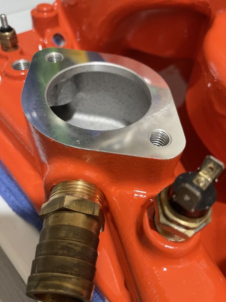

So I decided to change out my intake manifold because I needed another vacuum source and I didn’t want to drill out my M1 single plane. Also made the decision to help improve drivability. Lastly it gives me a tad more clearance for my Air Grabber set up. It was a bit more involved since I decided to paint it and the throttle kick-down bracket needed to be modified to fit properly. Here are some pictures:
I really like using this high heat fuel resistant paint.
