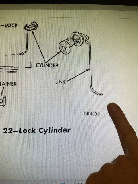

Can’t seem to locate the drivers lock cylinder link rod. Anyone have one of these that I can buy from you?

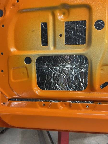

Insulating the doors. I am using a self adhesive backed sound and thermal insulation barrier with foil backing. It’s about 3/8” or more thick. I’ve decided to add a couple of coats on contact cement to the door after thoroughly washing and scrubbing it. This is to make sure it sticks and stays for a long time.

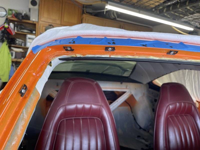

Getting ready to install my windshield. Clips are all in but I found a chip on the edge of the glass. This weakens the whole structure and is no good. So I need to get new glass and a nee gasket as well. While I wait for to order and receive that I will move onto the front end light harness, headlights grill and bumper. This will be slow detailed work. Some of the grill components need TLC and paint.
Ignore those maroon seats as I am awaiting my Legendary seat covers and interior set..
I am certainly no glass expert, but can't you file it down so it won't spread?
No the chip is about the size of a quarter. I spoke to a glass guy with 30 years of experience. The glass needs to be annealed before you can safely do anything machining to it. Otherwise it can be a point of failure later when stressed. Annealing is not cost effective. Since I’m putting this in a restoration ie fresh opening, I want to do this right and not have any extra work later in the future.

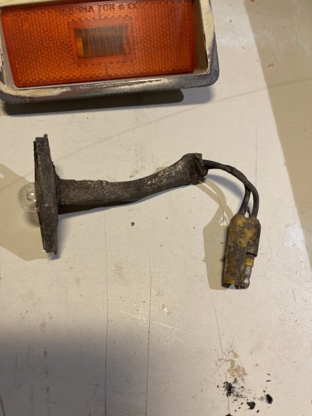

One of my bulbs broke a contact. No idea if I can solder it successfully. Wish me luck.
I suppose 44 years of having a soldering iron in my hands helped make this so easy.
