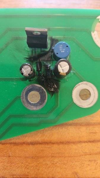

Question first: Can anyone verify whether the '68-'70 NON-Rallye gauge cluster circuit board has diodes and capacitors on it or not? IF they are normally there, what are the values on the diodes?
*Edit* I figured out this array of components must be a substitute for the voltage limiter device found on stock circuit boards. I have a new circuit board and voltage limiter on the way from Y1 now.

So I think I may have had a bit of a water puddle on my fuel sending unit, and the previous owner of my car put ALL 20A fuses in the fuse block... It smoked, then the fuel and temp gauge quit working.
I finally got the time and the good weather so I pulled my dash apart to see what was going on. Figured I blew a trace on the gauge circuit board and a little time with a soldering iron would straighten that out.
Lo and behold, the circuit board was a retrofit, screenprinting says "Charger Specialties CQ2" and it has a curious array of a couple diodes, 2-3 capacitors, and a rectifier of some sort soldered to the board behind the fuel gauge. At least one of the diodes is completely blown. I can still read the values on the caps, but no clue on the diodes. They're crispy.

That is an aftermarket board with an incorporated voltage limiter for the gauges.
That is a kluge using a LM7805 and a few capacitors. Electrically okay with a good heatsink, but I prefer the rt-eng.com limiter.

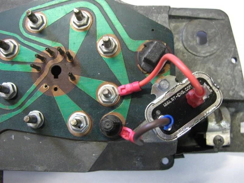

Yes.....get rid of the installed components and use RT-ENG.com. without a heat sink on the diode array it will overheat and fail. RT's offering has circuit protection. You could call RT ENG and offer to buy using a check or money order.....just a thought....
BOB RENTON
You need to either replace the board and get a new limiter or. You could clean the junk off that board and use an external set up like this. More info here MOPAR Products
