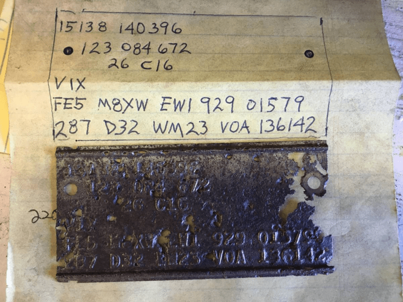

Still chasin' this one to some extent @68HulkCharger ? I, personally, would be most interested in the trunk gutter stamp at this point - to see just how "whole" this may have been when the reconstruction was started. The replacement fender tag (possibly from Govier?) looks nice and correct. Consider the condition of the original fender tag - on which, you can see the inspectors punches: (and how fortunate we are this photo has been preserved and shared)
What might the condition of this fender tag hint toward the condition of the entire vehicle "as found"? Frankly, I don't know if that matter to anyone - it is, indeed, a beautiful car.

**Edit** - I believe I see one error on the replacement tag: Interior code would be M6XW, not 8.
