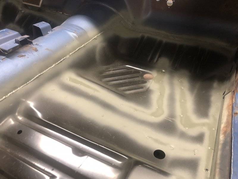

Rusted floor sections out, channels cleaned up and treated. Almost ready for new metal.
Floors in! Seam sealer going on next week.
Things are coming along. Rusty window channels are repaired, floors are in, remnants of old passenger door collision damage fixed, quarters are patched. Progress.

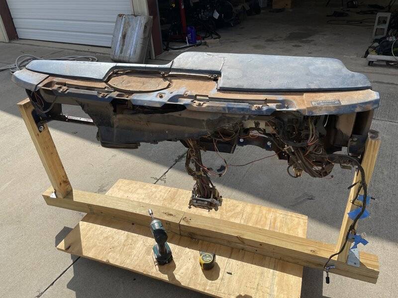

Finally had a couple hours of free time and used some scrap wood and a furniture dolly to get the dash up off the work bench and made it mobile!

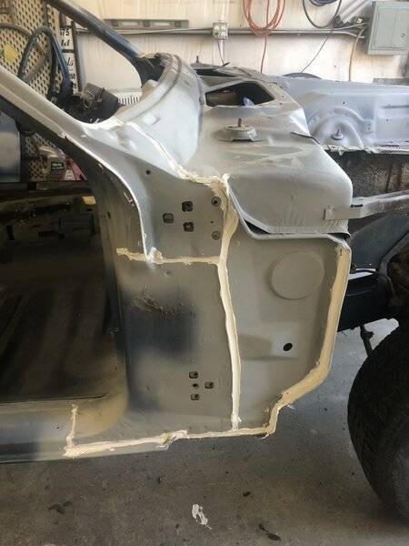

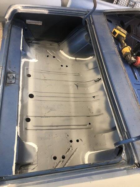

Cowl repair, trunk cleanup, and seam sealing is done. Getting closer to the rest of body and paint!

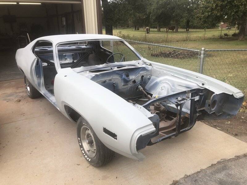

Quarters and roof are in primer and sitting for the weekend. Still some metal work to do on fenders and hood but this is pretty good progress. Hopefully I’ll have time this weekend to work on the bumpers and dash.

It helped that I had her completely stripped and “my guy” works for himself and is exclusively working on my car. Progress will slow a bit after this stage though. Both he and I need some time to catch up on other stuff!

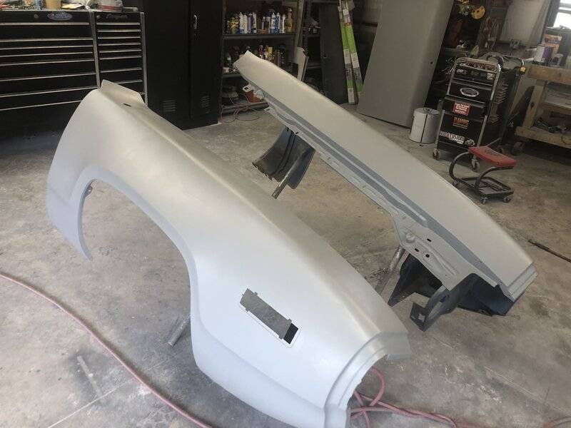

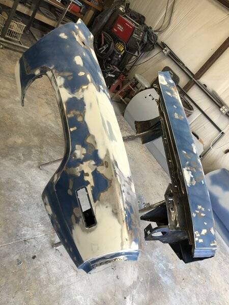

More progress. Got the oddly rusted passenger fender repaired and both fenders patched/roughed in.
Fenders hung for looks, not finished with them yet. Taking a break for a few weeks to catch up on other stuff.

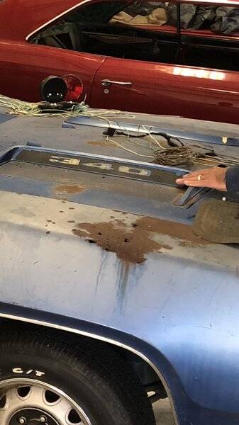

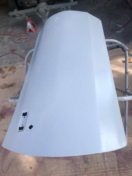

Got the hood blasted and started addressing the pitting. Will probably use some of Eastwood’s internal frame coating on the inside of the reinforcement channels.
