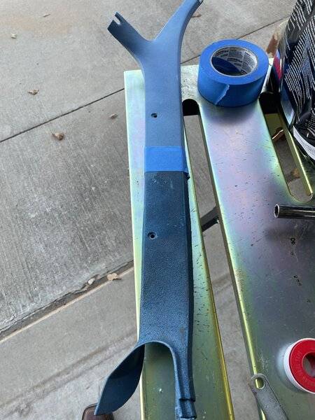

Tried my hand at cleaning up my tired and flaky plastic bits. Low pressure with fine walnut shells did a great job on my chalky A pillar covers. They’ll need prep and paint but I’m pleased.

They lost a little of the texture but I might try some SEM texture spray before repainting the right color.

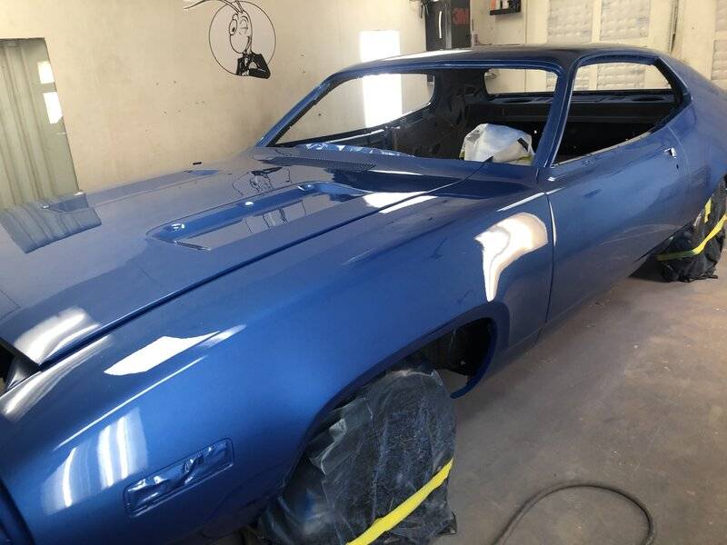

Coming home today. Much more work to be done but happy to have the rot gone.
Looks great. Nice fast turnaround when you hire a real professional and the body is solid to begin with.

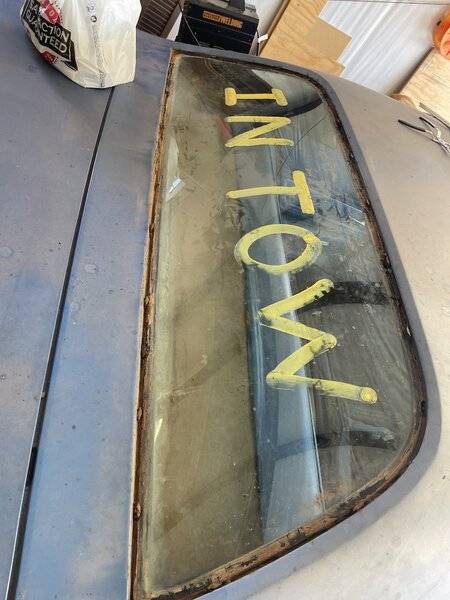

Had a good time with my two sons last night. Got the hood off and started tackling the front/rear glass trim. Back glass channel looks great.

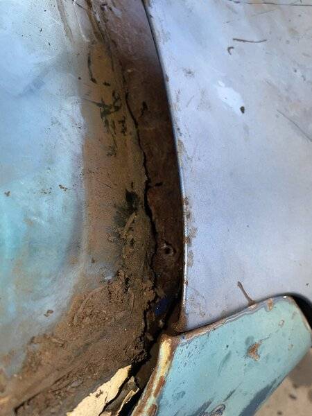

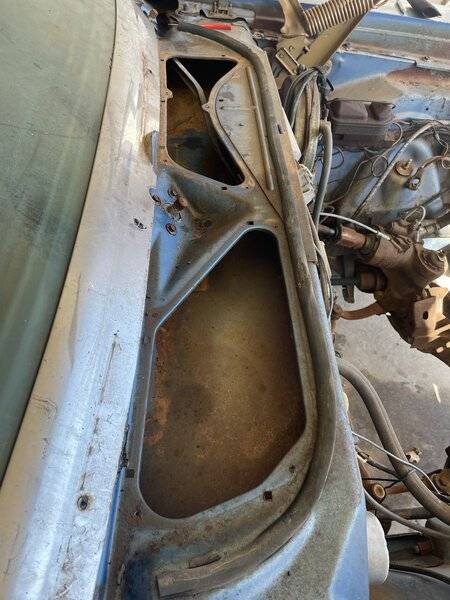

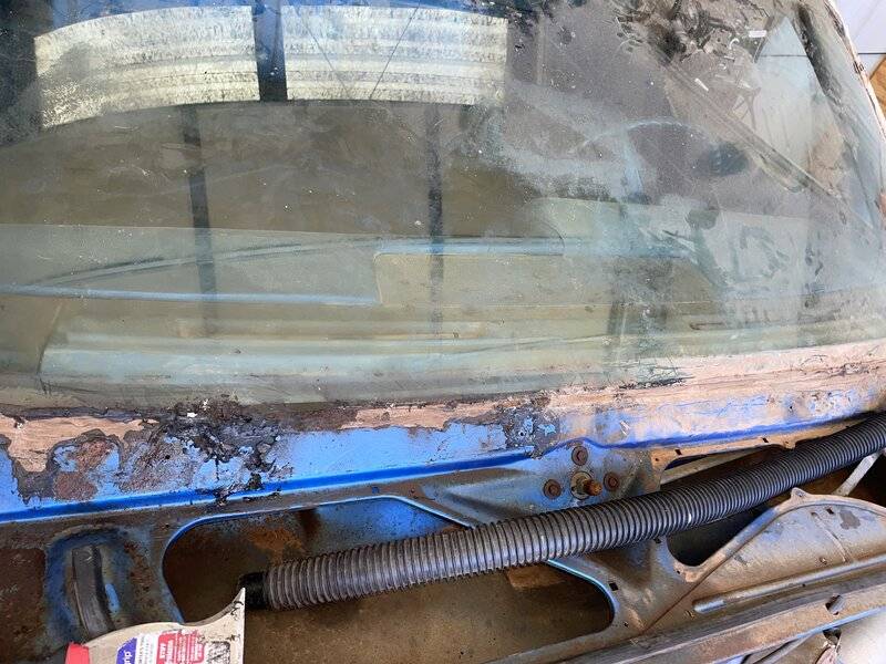

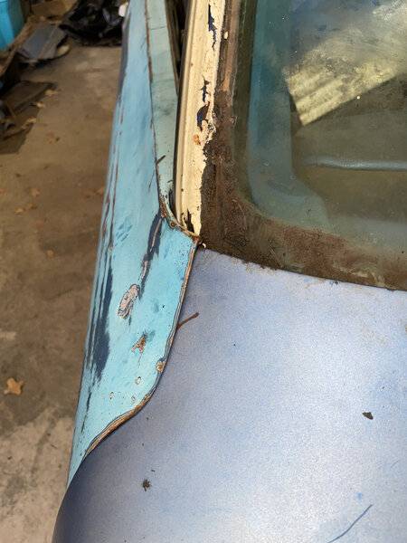

Being a vinyl top car, there is rust up high on the driver’s side. Lower passenger corner is very rusted but the whole lower front section looks/feels solid. Vacuumed inside the air intake/cowl area and it seems good too.

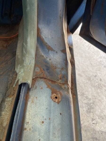

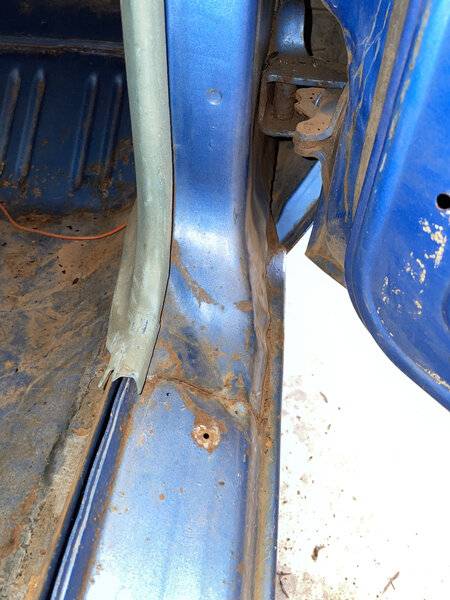

Now for the disappointing part. It appears the car took a hit in the passenger door and the impact pushed the pillar in. The rocker panel is buckled a bit and the door doesn’t really line up with the fender. Missed that in the dark shop while I was checking it out before I bought it. It was partially hidden under the rocker panel covers too.
View attachment 1086354 View attachment 1086355
I was ready for rust and dinged up panels but having the structure of the car tweaked might make this project beyond my means. Wish I had caught it before I hauled it home.

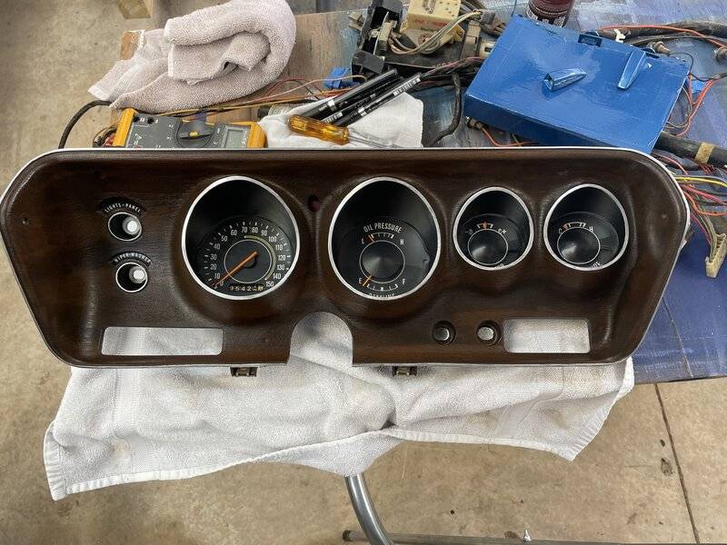

Body/paint guy is here hitting some spots while I reassembled the cleaned up gauge cluster/bezel.
In the photo of the finished gauge cluster - it looks darker than the previous photo of it, did you put something on it to darken it up?
Noob dealing with the 71’s. Why does my cluster have a clock and yours doesn’t. Where your fuel gauge is I have a big clock?
There were options for the second large gauge opening. You could get a tach or a clock in that opening, and if you did, the fuel and oil pressure were doubled up in the two small gauges.
Yup, I cleaned it well with dish soap and then hit it with a detailing cleaner/dressing.
Here’s what I used. It brought the grain back really well.

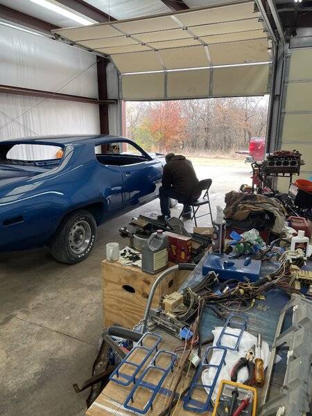

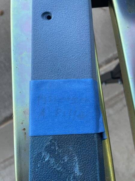

I've been chipping away at little details. Got my blaster dialed in and started stripping the dash frame and components.
Trying to find something close to the original low gloss blue for the dash. I was tempted to just change to black because it's easier.
The original Chrysler color code for the dash is AB62GB7 but none of the paint supply places I called could do that. My body guy said I could try using GB7 base coat with the metallic flake removed and finish with a low gloss clear.
Has anyone else who had a non-black interior tried that with the other colors?
