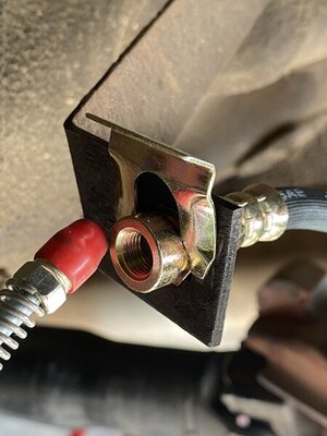

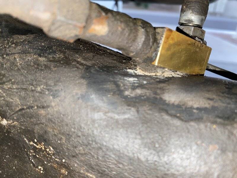

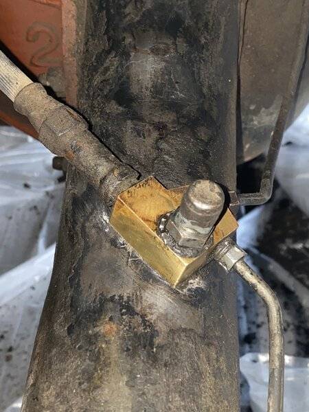

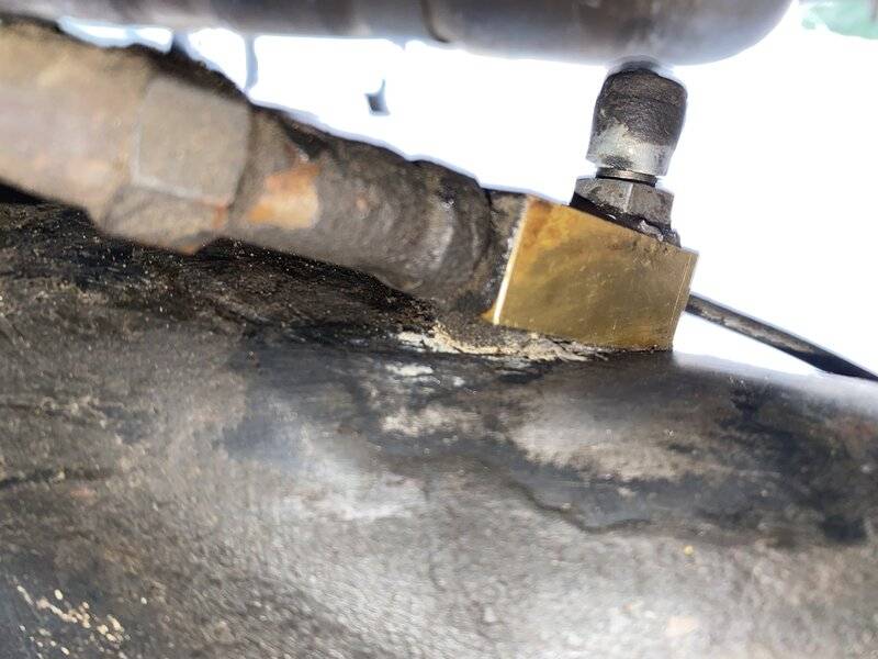

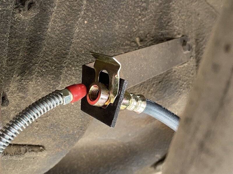

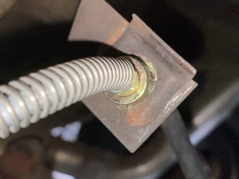

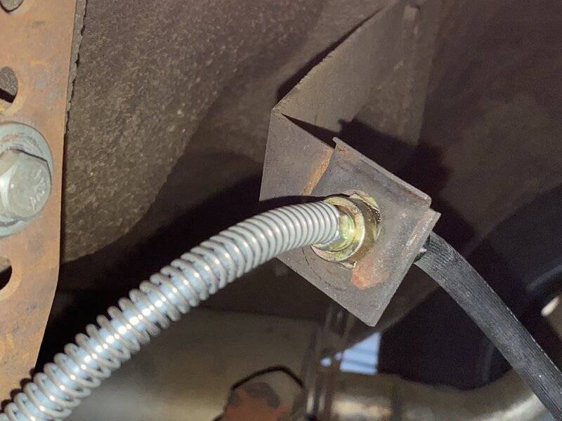

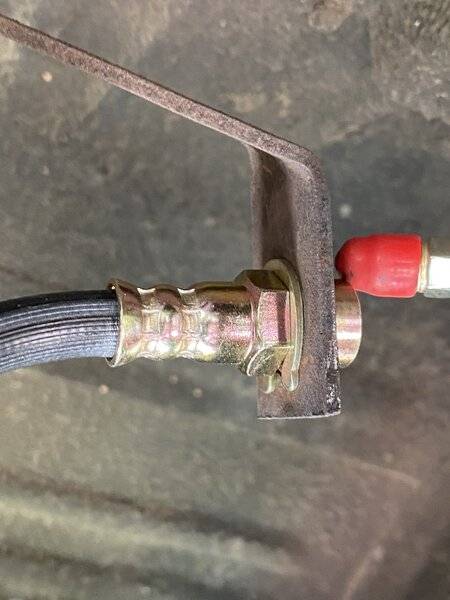

I've had success removing the clips with my largest slotted screwdriver by inserting it between the 90 bend and the hose end. twist quickly and with force. Also hammering a wedge between the two works as well, but the bracket will need to be supported.

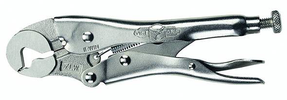

I've worked on many 50-60 year old brake lines and I've found the most useful tool is the 4" (4LW) hex jaw vice grips. First wire brush the fitting, then spray it with PB Blaster, then torch, then more PB Blaster. Sometimes the tube will twist off with the fitting, but if that's the case, the line needed replaced anyway.
https://www.amazon.com/Tools-VISE-G...t=&hvlocphy=9026273&hvtargid=pla-421878969058
