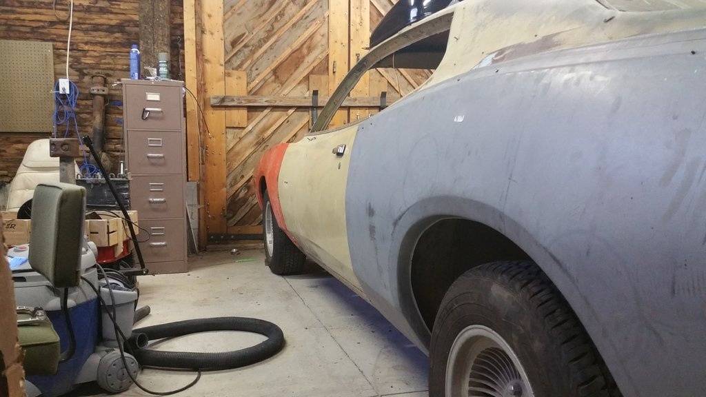

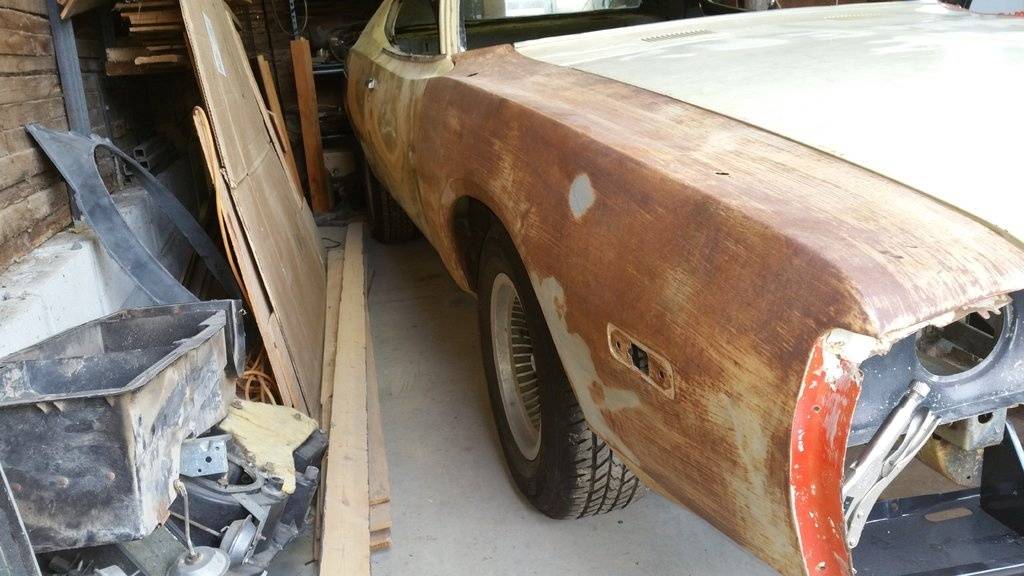

Due for an update:

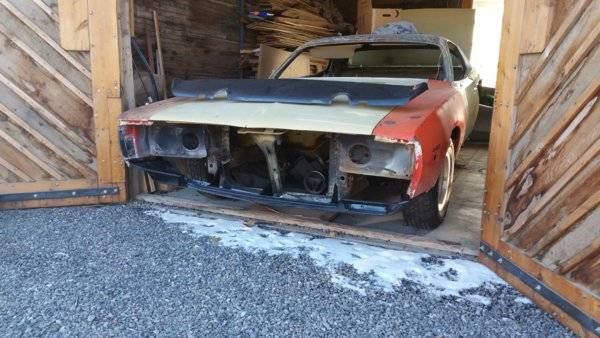

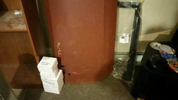

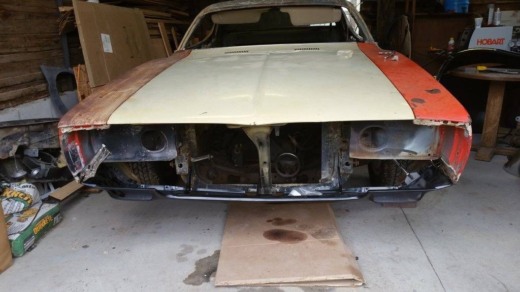

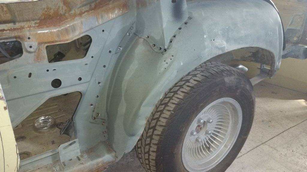

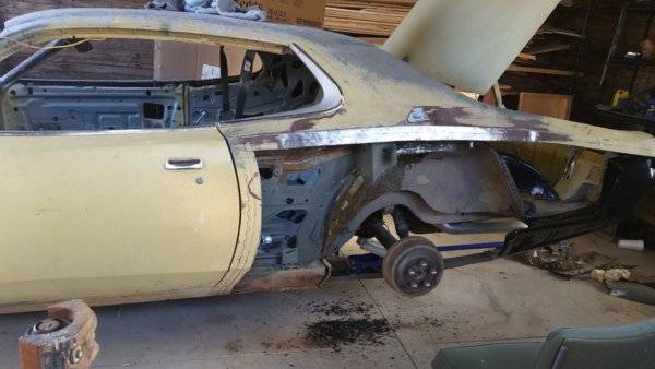

Maybe I'm paranoid, but before I get ahead of myself with the welder I decided to hang all exterior sheetmetal to ensure things were straight. Today, specifically, I hung the passenger door and fender back in place. The flat hood was laid down to ensure fender fitment is acceptable. Everything seems to line up good, besides some adjusting needing done on the drivers door. AMD front valance couldn't be better. Hope their bulge hoods are of the same quality!!! Rear valance cannot be fitted until quarter skin is welded in place, but measurements are spot on.
Oh I also undid the torsion bar adjuster bolts a few spins so the body sits more level. And I have started to drill out wheelhouse spot welds... lots of fun!

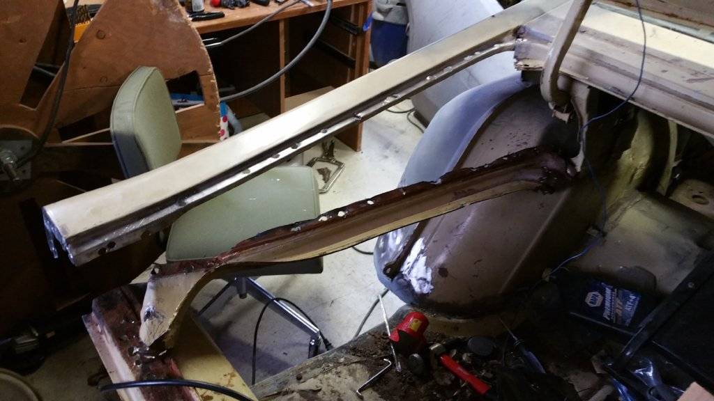

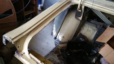

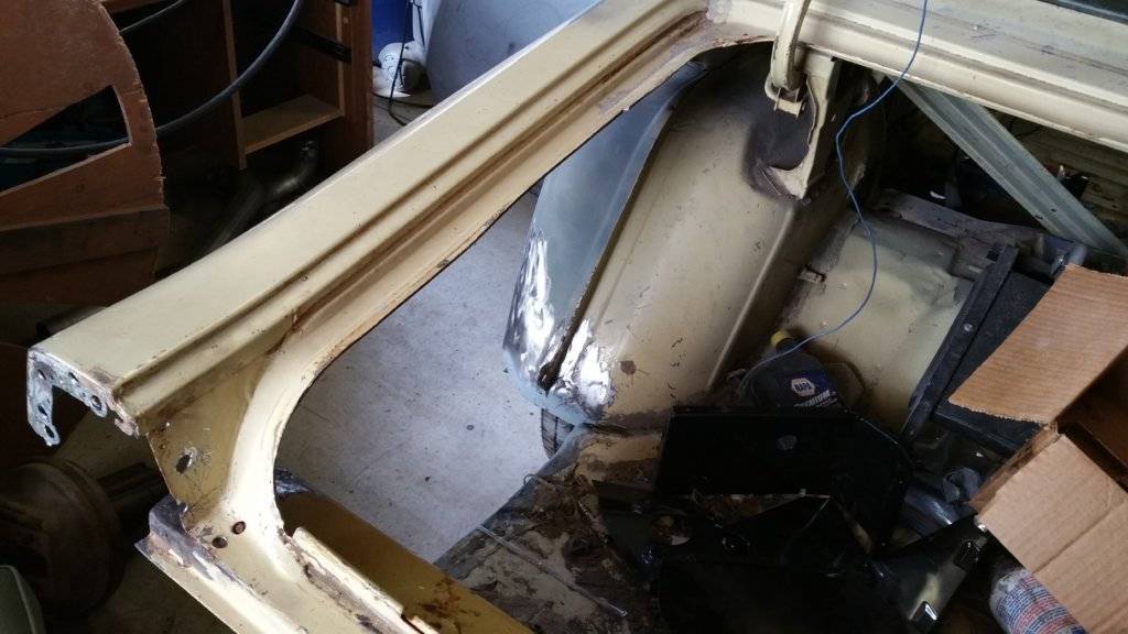

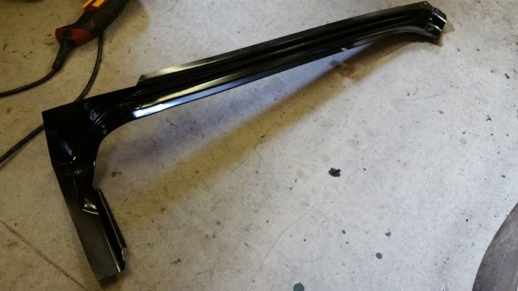

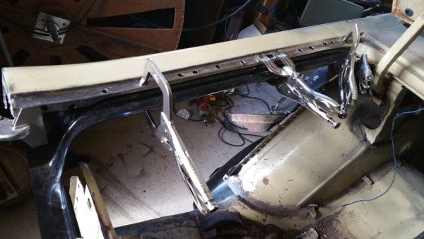

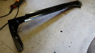

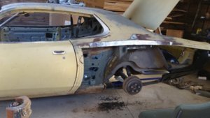

Small progress here and there... just going as I can find time and money. AMD trunk gutter came in, and I drilled out the old one. Had to remove it, because metal underneath was rusty. Looks like it'll fit just fine...
plans are to weld in patch for the rear trunk panel/bumper support, plug weld in trunk gutter, finish removing and plug welding new wheelhouse in place, then the quarter can go on.
Starting to see a little bit of light at the end of the tunnel, but I still have a long ways to go.
Pictures on my phone, will be posted in a few minutes.

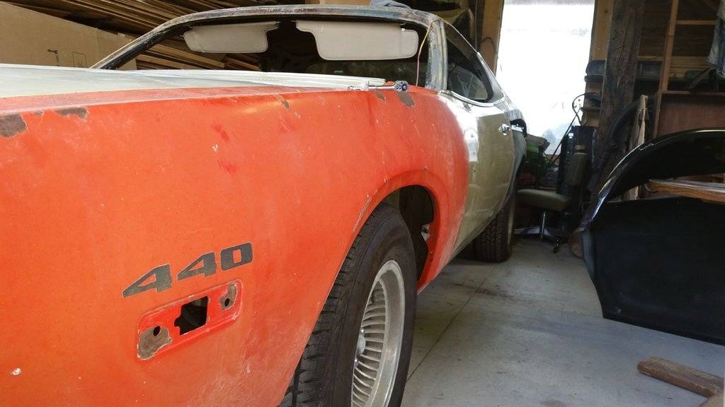

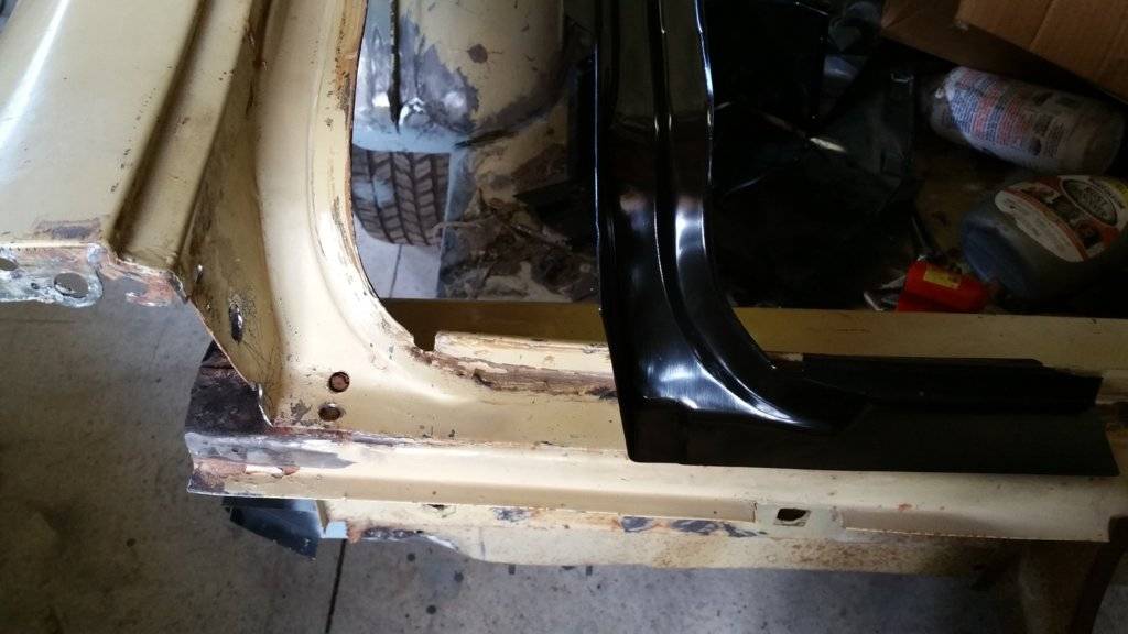

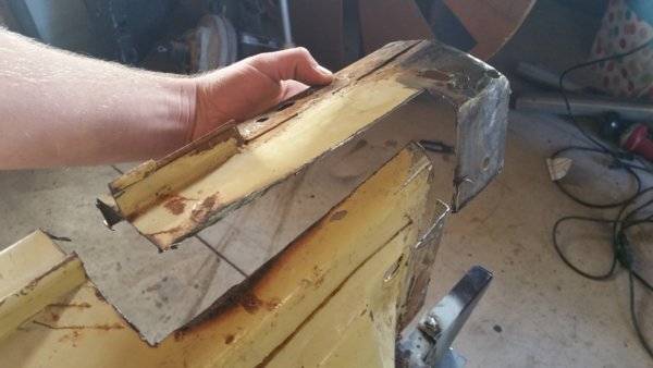

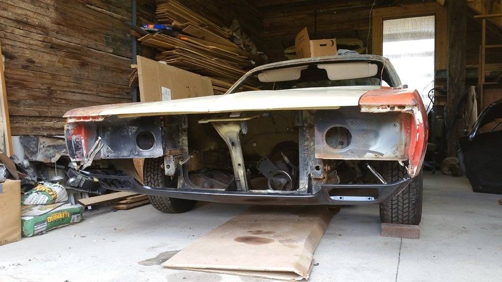

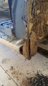

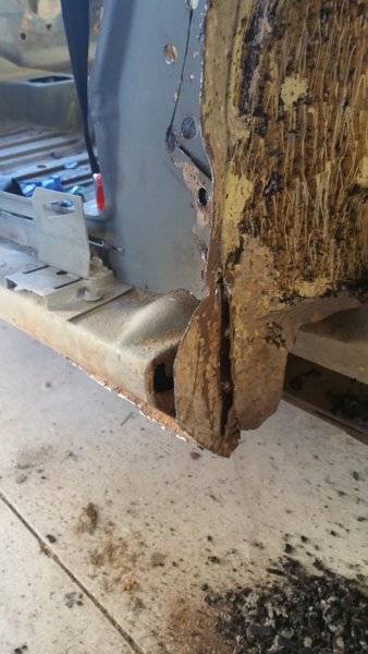

More progress here and there... I found some rust in the rear "tail panel" , and cut that out. Making a patch soon.

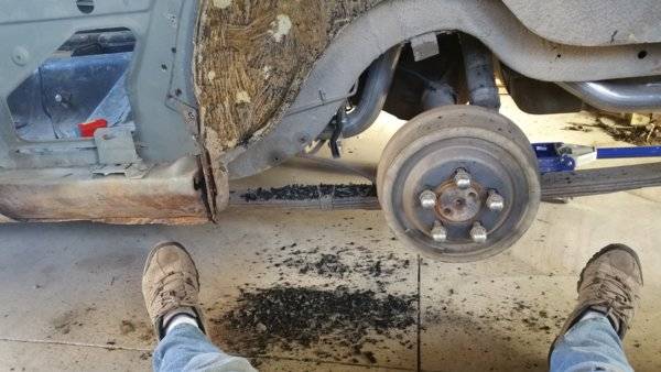

Trunk gutter fits really good! But can't weld it in yet. Most of the outer wheelhouse is out, and it's been fighting me for a long time. I'm always finding hidden spotwelds! And while I have easy access to the old factory undercoating I might as well grab the heat gun, right?
Meanwhile I traded one of my cars to a friend who works in a bodyshop... in return he's gonna do the final bodywork and paint starting in march or april. So meanwhile I'm working my *** off to get all the rust repairs done and what not!
My plan right now is:
1. Remove last of old wheel housing
2. Plug weld new wheelhouse into place
3. Weld in trunk floor ext.
4. Finish tailpanel patch
5. Weld in trunk gutters then quarter skin
6. Hang doors on new AMD hinges
7. To all the same patches on the passenger side.... fun.
8. Make a few cowl patches
9. Patch a small hole in floor pan
This is a lot of headaches and hard work, but I'm sure it'll be fun in the long run.
