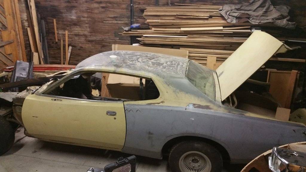

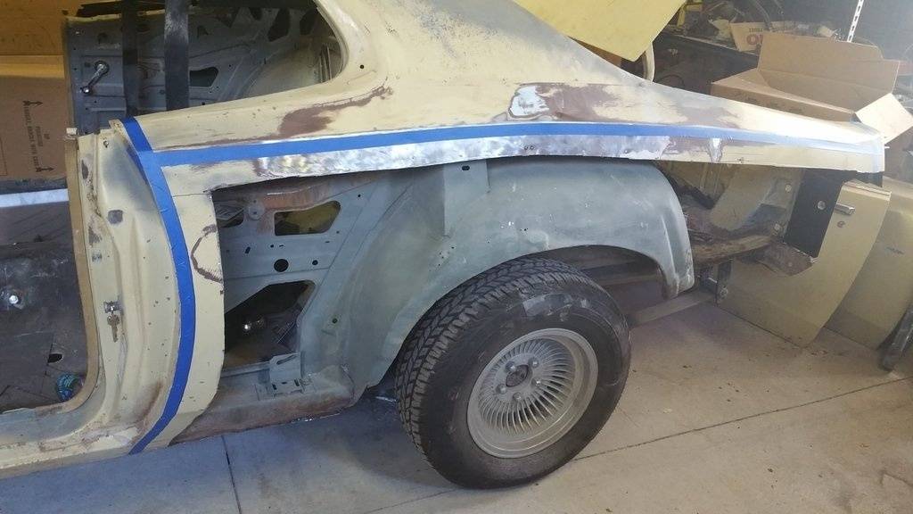

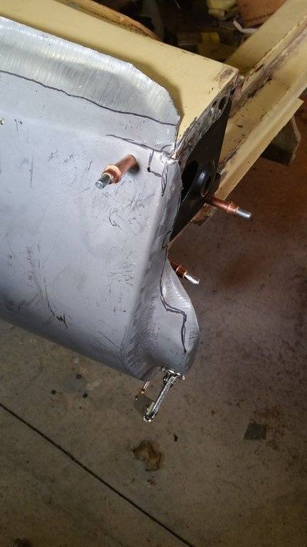

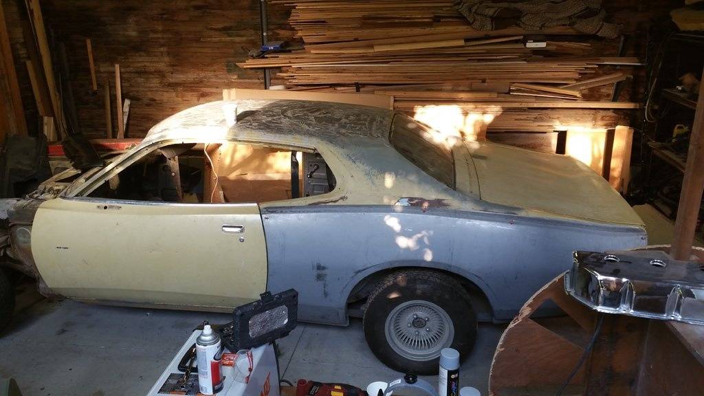

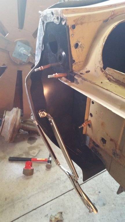

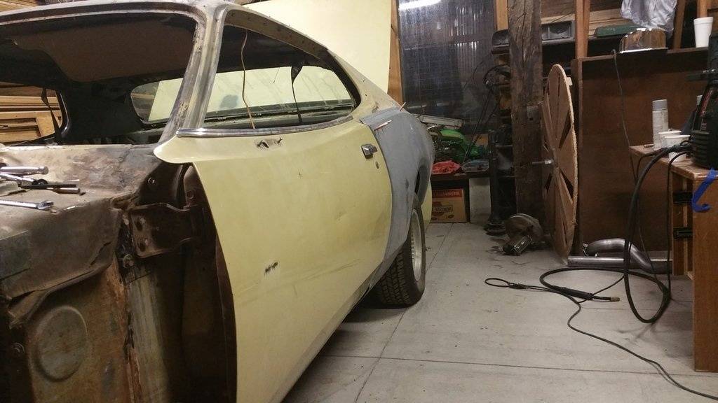

In fact, i did quite a bit today. Test hung the quarter skin, and trying to figure out the best way to install. I also hung a door to ensure the gaps were decent.
However, I'm waiting for a new outer wheelhouse to ship before welding on the quarter skin. Speaking of sheet metal, I'll have to order a pair of trunk gutters from AMD soon.
After all is said and done, I'll trim the quarter skin and weld it all together.

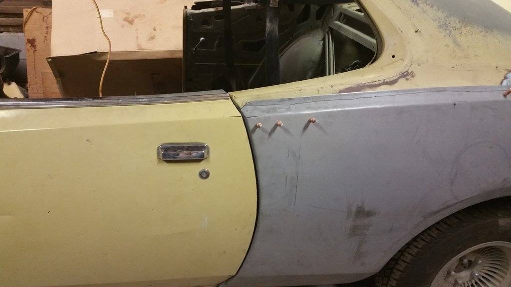

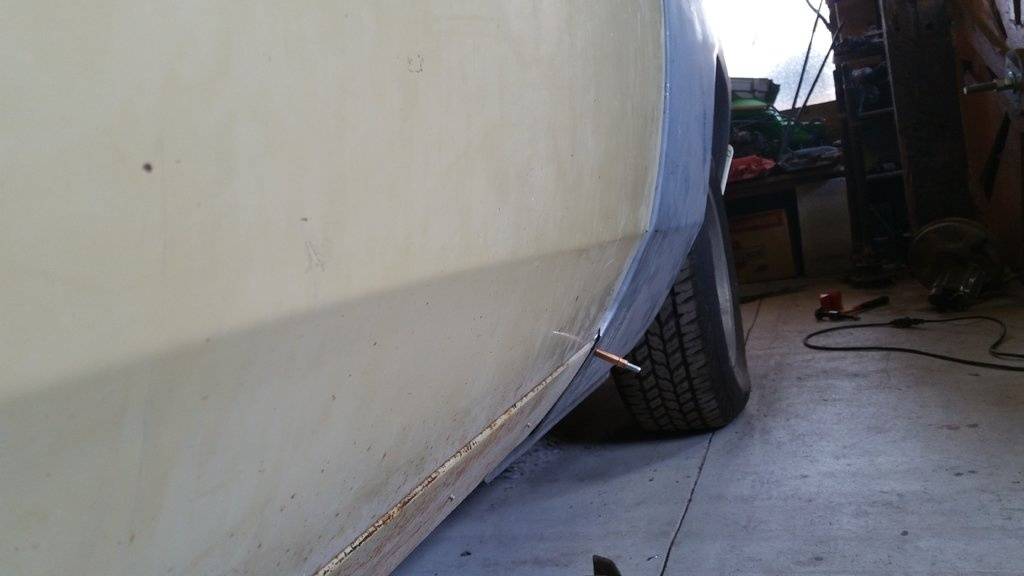

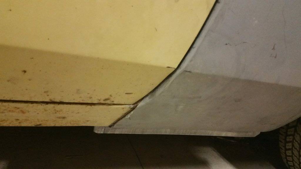

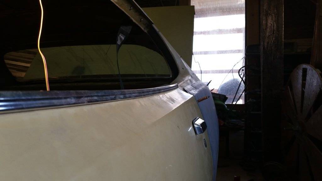

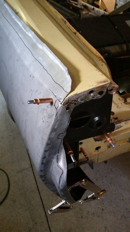

Today I tightened down the skin to make slight style-line adjustments. Dont worry, I'm not gonna lap weld it. But I want to make sure everything will fit before I pull out the electric shears!
20170822_183336.jpg 20170822_183014.jpg 20170822_183003.jpg 20170822_182936.jpg 20170822_182931.jpg 20170822_182943.jpg
Thanks! And yeah the clecos really are quite handy. I need to find some wother stronger springs, though.
I am guessing that has to be a Tabco quarter. Happy with it? Tks
Yeah it's tabco. It's not bad, but certainly not AMD quality. I just have to work with what's available. It's stamped in the USA, how can I complain? Bodylines are pretty good, except the rear-upper one. It was about 1/4" low, and I had to stretch it up.

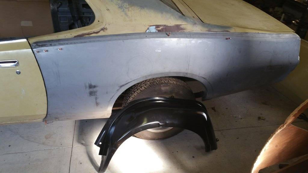

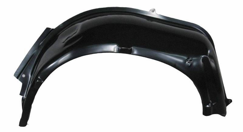

Alright guys, last week I did some work for some family and made some spare cash. As can be seen in previous photos, the driver's side outer wheelhouse is pretty beat up.
Long before I bought the car, I assume it was involved in a side collision that pushed in the quarter panel and wheelhouse.
Although the new quarter has been test fit, I want to take the time and spend money to make things right. Even though nobody will see the beat up wheelhouse, I'm replacing it to make the car "right". Do something right, or don't do it at all IMO. AMD part ordered from Summit... should arrive in a few days.
And when I can scrap up some more money I'll get both side's trunk gutters, a passenger lower quarter patch, and passenger side trunk extension. This will finish up all rear sheetmetal replacement on the rear of the car. I won't weld anything until all sheetmetal has been hung to ensure gaps are good, and frame rails measure within factory specs.
Oh and one more think I'd like to say... AMD lists many of these parts for the 71-2 Charger "only" but I have found they all fit the 73-4 model perfect, with the exception of one quarter panel support that had to be cut and bent slightly. If any of y'all want the info on the 71/2 parts fitting on a 73, I'll share the info.
