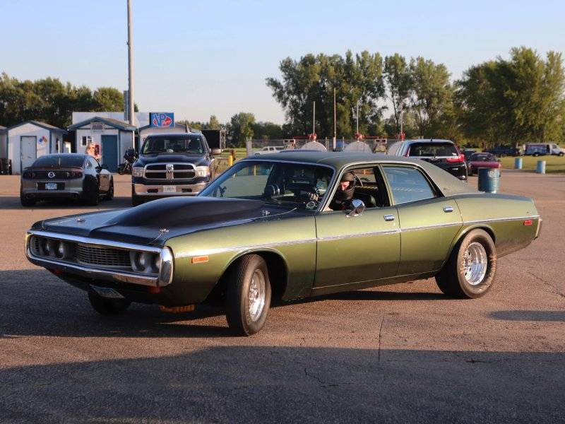

Here's a bulge hood. Very nice color on this car, looks like F8 green. Still can't get past the extra door though.
and that hideous bumper would look better body color
I don't mind the bumper that much but I had that exact thought as well. That scoop is borderline bizarre though. It's like a teardrop/aero/cowl/bulge/pillow-under-the-covers lump.
I was ignoring the hood...... it's just 4 bolts :lol:
