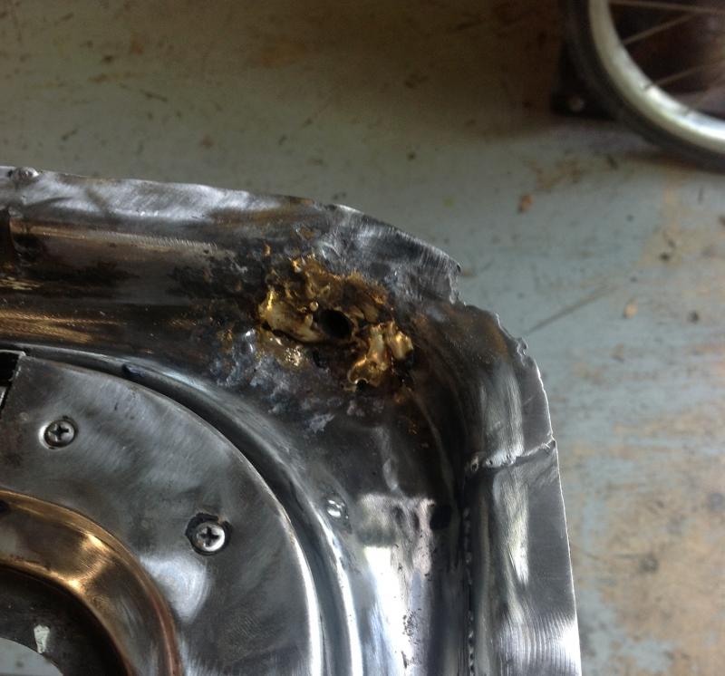

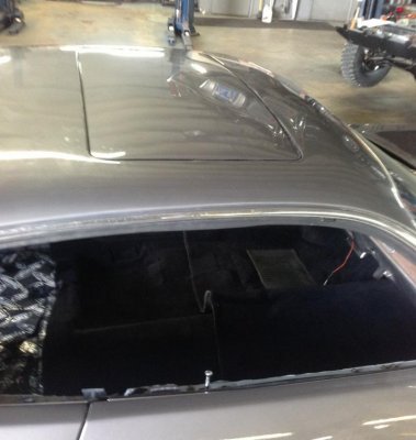

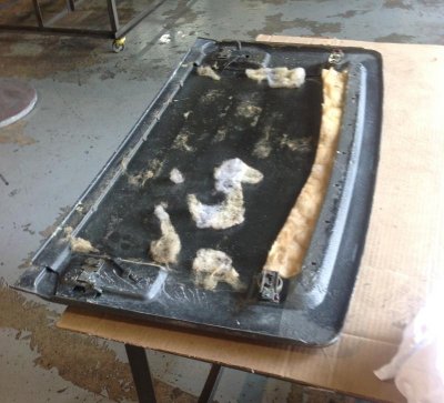

So today I was able to get in early and pull the sunroof and pan to take care of the little hole with a bit of brazing.

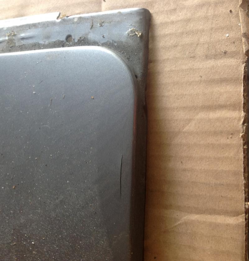

Here's a bottom view of the panel. Unfortunately, I found that the paint at the top had developed a crack in the paint just of the edge due to a filler crack telegraphing through the paint.... No big deal but it meant I wasn't able to finish up the sunroof today.
Hairline crack in the paint.... Damn

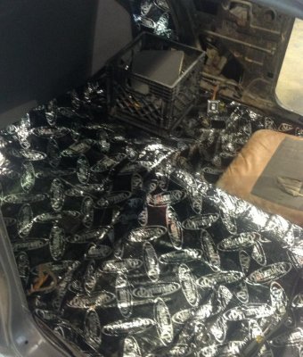

I was able to finish the dynamat install with help from Ivan and Luis. Thanks guys! Note to self .... It's easier to mark the seat and seatbelt hole as you put the dynamat down rather than after... Where was that hole????.

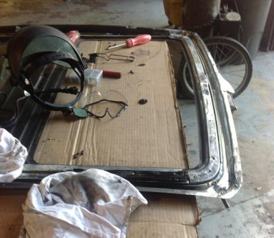

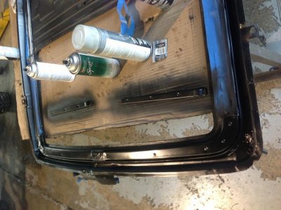

Here's the pan stripped and ready for brazing.
After brazing up a storm... I think I need to do a little grinding and smoothing...I thought about maybe some filler but decided against it...too hidden and didn't want to have it conceal and future rust or issues. All the extra brass filed down fine with a dremmel ... Not perfect but more than good enough.

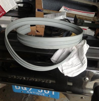

Worked on the sunroof weather strip... At least the roof weather strip got on today.
Finished install of that according to instructions... Everything went great except that the tape pulled two tiny bits of the flocking out.. Not noticeable but I'm planning on wiping the flocking for the panel with some silicon or armor all to avoid this again or worse.
Here's the view of the pan painted and ready for installation later this week.

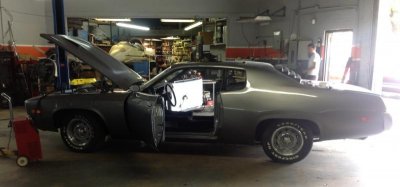

And now for my friend's surprise...
They installed and wired up the radio...thanks guys!!!!!
Yes... that's Ivan ...on his side... In the attachment below. I hate the photo apps on this forum...

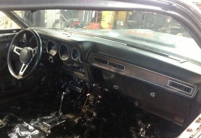

I got to the shop at around 10:00 and was able to get some work done on the sunroof, carpet, interior and console.

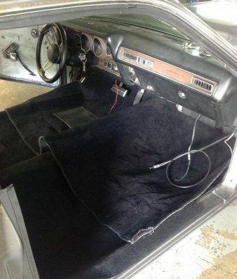

Here we are working on the carpet. Cars is beginning to take shape. During the week I was able to spend some time on Wednesday afternoon and installed the drip rail molding. Rear looks a bit off in that the rear tire looks to be small in the wheel well. I'm thinking of upping the rear tires to 255's at the rear and leave the 235's in the front. (A trick I learned from the AAR 'Cuda)
Ivan was able to paint all the interior door panels to match the legendary interior seat covers that were installed by my friends at "All in Leather". So we're almost ready to start putting it all together.
The rear carpet went in with no issues. The front was another matter. Ended up cutting off about 3 inches off the front on the passenger side to fit it up to the A/C box. Then came the floor shifter mechanism cut out. I figured I would start on the passenger side first, get that to sit right front to back and straight.
Once the passenger side front was settled, we fit the carpet up tight to the console and shifter brackets, wrapped the carpet up and over and made our first cut. Talk about tension. The rest was all about cutting the opening to allow the carpet to sit flat on the floor pan through the cutting of slits and tabs to get it in under the brackets and have it cover the entire transmission hump. Several cuts and slits later, we were done. We purposely did not cut the carpet completely in half at the back edge which made the rest of the carpet for the driver side footwell lie straight... Including the heel pad.
Last we made the cutout for the high beam foot switch and installed the grommet.

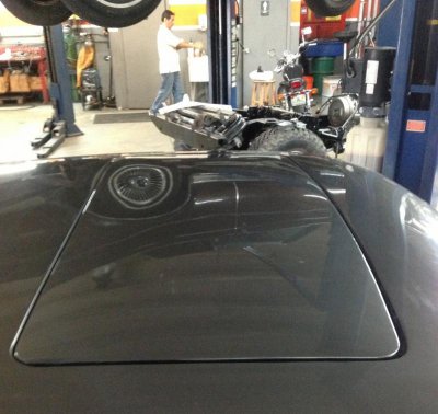

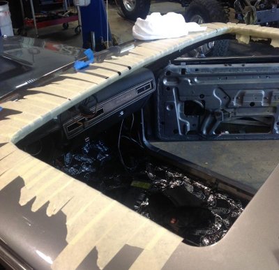

From there we went to the sunroof panel fitting and adjustment.

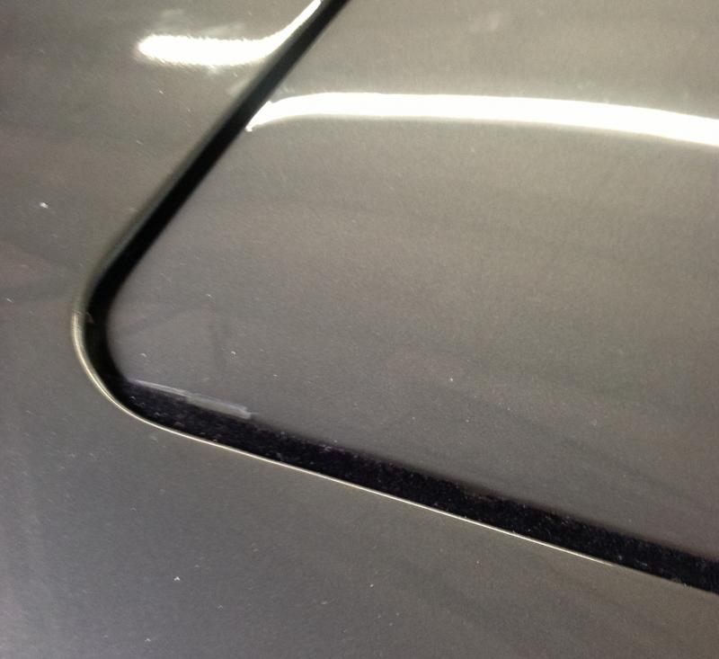

Heres the first fit... Fresh from the paint shop down the street. Pretty close. All went well until we ran it through a complete cycle.

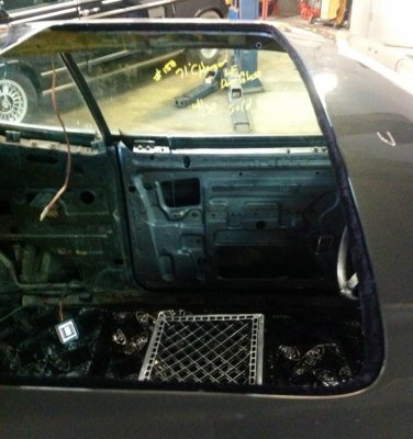

Disaster... Damn it, f**k, ****, piss.......! During the bodywork I did 15 years ago, we had to patch the roof where it met the right rear corner of the sunroof drain pan that left a tiny weld hanging just low enough to ruin the paint. I replaced the seal for the entire pan, since I had it out, and also reworked the brackets that support the pan to get a tighter seal this time around ......and this is the result. We loosened the pan, installed a 16th inch shim and no more problem. Decided to continue the fitting and adjustments before sending the panel back to the paint shop. At least we hadn't installed the rear seals.
Here's the final fit...

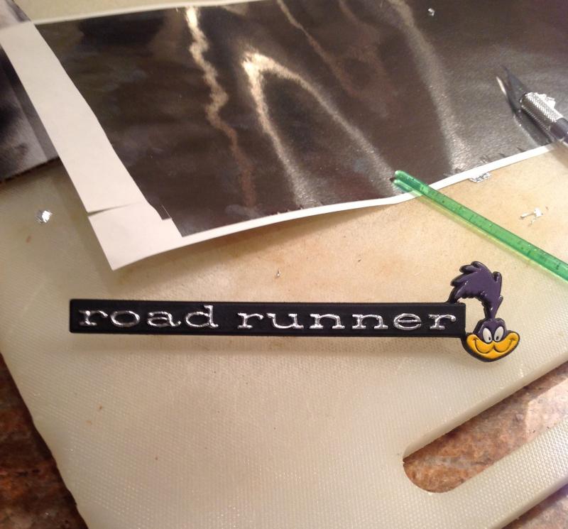

Ok.... Just finished the dash plaque that has the road runner script and little bird. Mine was missing the damned little bird since I got the car.... Actually got it for $60 bucks still attached to the trim plate a while back but it looked terrible. Seems the previous owner cleaned it to death.

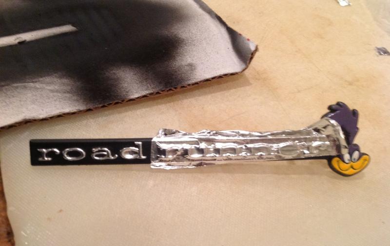

So I refurbished the bird and cleaned up the script. But what really made it pop was applying some "Bare Metal" foil I heard about on this forum from magnumgt over on the 75-79 part of the board.
Here's the first part I did and shows the foil in process.
And here's the finished product with the foil in the background together with my trusty x-acto and a small hobby brush to get the little filings!
Only took a couple of hours and once installed took a polish with just a dry cotton cloth and looks like the original chrome. Fantastic stuff!!!

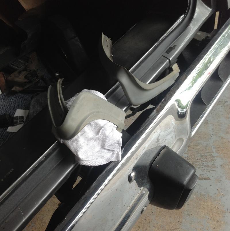

I've had a couple of pm's on the bumper fillers for the rear bumper. Questions were mostly about where to get them.
The end fillers have been NLA for almost 30 years. However....As long as they are complete they can be refurbished with some success... Not NOS perfect but definitely above driver quality.
Heres the result of some very careful sanding and cleaning off with lacquer thinner of the degraded vinyl ends. Hours of fun! And the bonus of a headache from the fumes.
The filler that goes in between I got on EBay about a year or so ago but can't remember from where. It's all vinyl with an integral windlace in the extrusion unlike the stapled windlace on the original.
If anyone knows where to get the filler, please post it here. There's a lot of people looking for it. Thanks.
Besides, I shoulda bought two!!!!

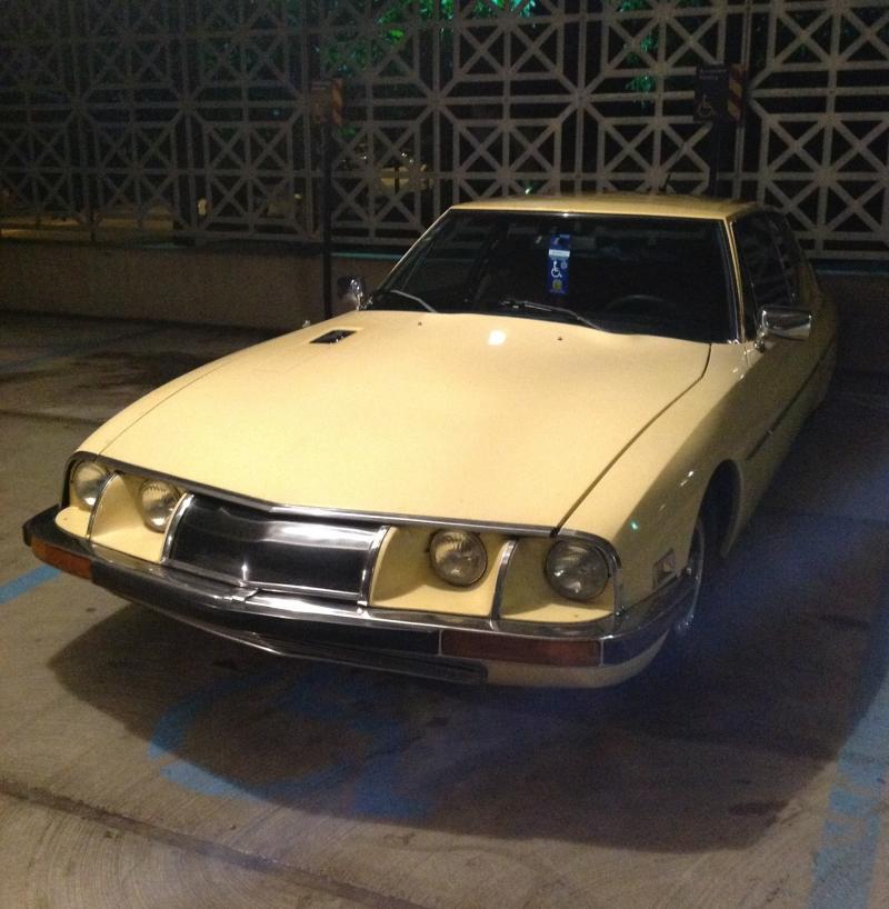

Any of you guys remember what this is?????

Wow that is a French built car I have always seen in 4 doors,but I can't remember the name. Sorry to hear about your accident and glad to see you are up and around.
You are correct. It's french. Anyone know what model or year?
It is a Citroen SM with an engine from Maserati..... ;-)

That, sir, is correct! It's a 73 with the 3 liter and five speed. Very rare and I had been on the hunt for two years before I found it at a price that I could afford. They want crazy money for these cars and the few they shipped over at either going back to Europe or Australia... Go figure
My new friend David Hume in Lexington went though it on the way down and wouldn't let me leave until he blessed it. David is the east coast guru for SM's like Jerry Hathaway is in LA. He actually did the timing chains for me in two days while I rented a car and drove to the family to Atlanta for the Father's Day weekend. It has all new timing chains now and runs really, really well. Hydraulics are also spot on.... Only needs paint and some minor sorting of some incompetent wiring "repair". But first my roadrunner has my attention for now, so ithe SM will have to wait. Nice to be able to finish something "simple" before I have to get my masters in crazy French engineering.
