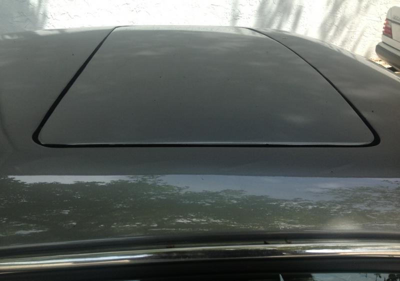

Here is an overall of the car with the new tires mounted and finally outside now that the sunroof does not leak.
Detail of the sunroof

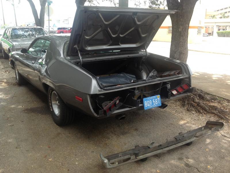

Rear bumper filler install

I reset the rear bumper with the jack and now it sits tight to the body on both sides like it should.

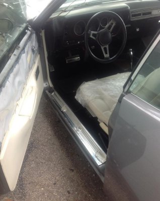

Here are a few pictures from last week's trim of the door jambs and sills.
Drivers side... Waiting til headliner is in to install uppers door panels. No need to have them damaged at the shop. I'm really happy with how the carpet and other trim is beginning to come together. A lot of hard work and patience is beginning to pay off.

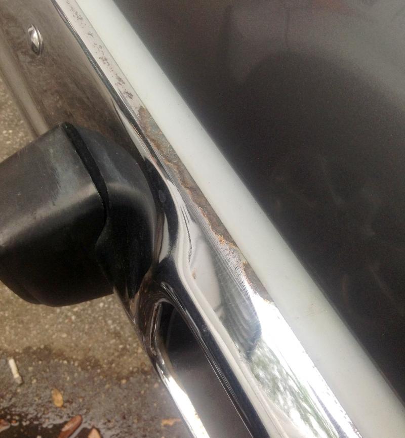

Here are some details of the rear bumper and why I need to have it rechromed.
For some reason the top of the bumper chrome peeled off and rusted.Didn't even notice it 'til i pulled what was left of the old filler out.
I have another outer bumper shell that went in for new chrome. This one was the original that had a Toyota commit suicide on it about 20 years ago. I drove off with with a bent bumper, lower valance and licence plate frame. His Toyota was totaled. Insurance paid to have it straightened and repaired but it came out a little wavy. The other shell is straight and has only a little surface rust points. It should come out great... I hope.
Here you can see the chrome has crazed a bit. But the fit of the end trim fillers is good.

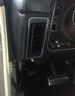

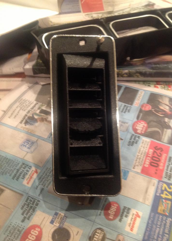

First, I got a new a/c vent for the drivers side from fleEbay. I noticed that the outer rim was originally chromed.

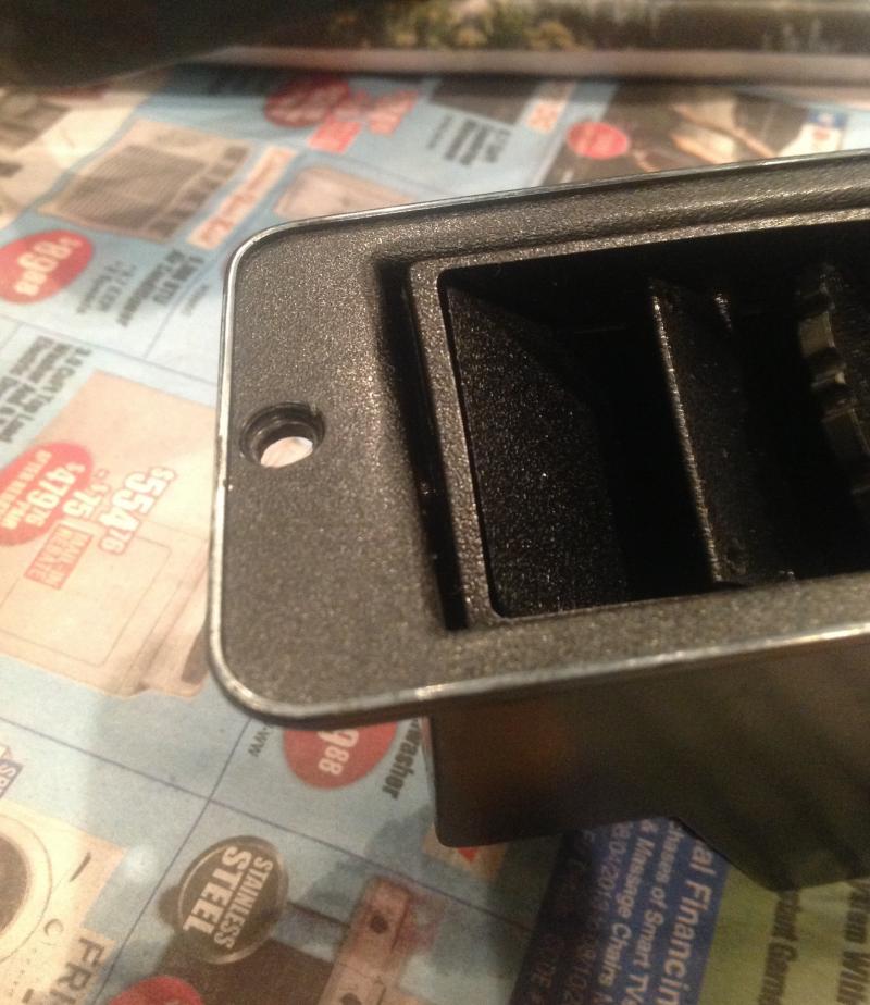

Heres a detail:
I decided to go back to the Bare Metal product that worked so well for me on the road runner emblem.
This stuff is a pain to use.. It's thin and difficult to work with... Did I say thin?? It's actually really really thin.
I found that the best burnishing tool was actually my thumb nail.
Here it is installed...
Now I need to do the ralley dash bezels and trim... That's sure to be a whole days work....and a/c vents.

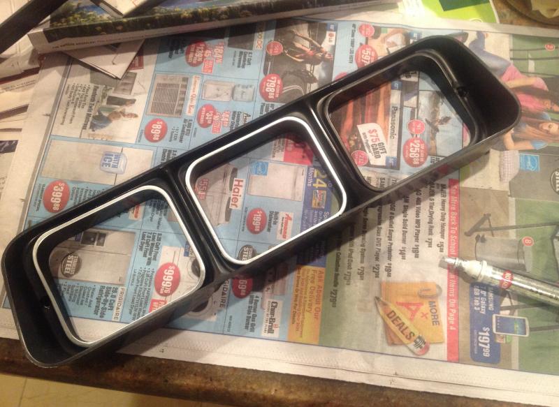

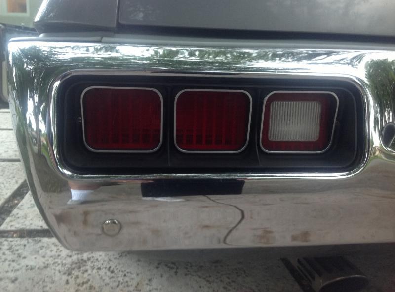

If you looked closely to the backgrounds from the above views you can see what else I was up to at the same time. The tail light bezels were also bright finished at the interior rim of the bezels. For this, because it is an exterior finish, I went with a Krylon paint pen from the local craft store. I found it in the gold and silver leaf section and is very easy to use. First I washed it in Dawn soap as a mild degreaser to get any remaining road film off the black plastic bezel..
And here it is on the car
I was able to do all this on my kitchen counter where I do a lot of the little things I do.

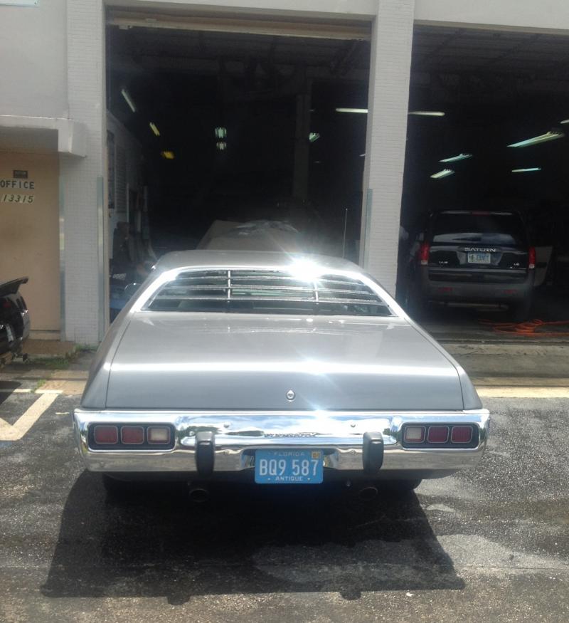

Made it to the trim shop. Drivers window is stuck. Luckily, the sunroof works fine. Very very hot!!!!

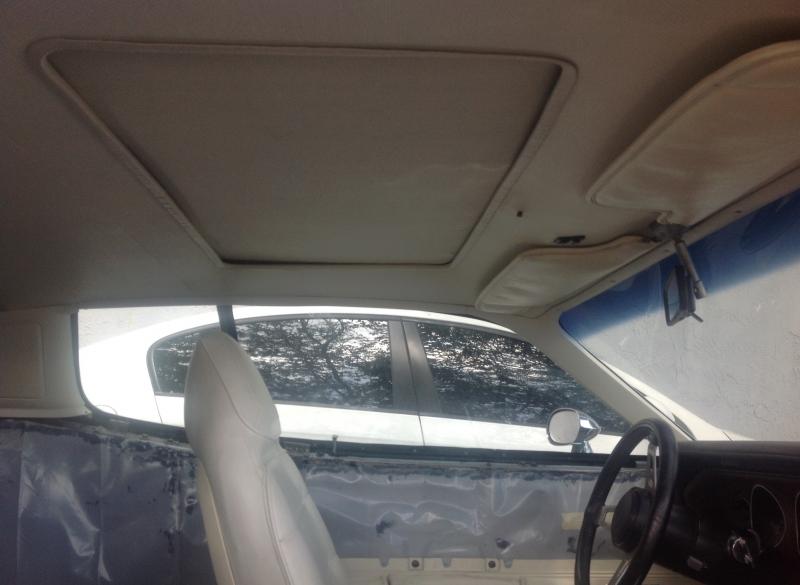

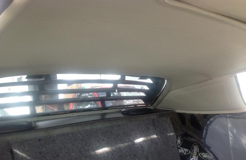

Progress. Finally.
It seems the last 5% takes 50% longer than anything. I guess that's because all the little things that have been put off or worked around until now are now critical.
Example.... Headliner. Yes I wanted to get the original material and yes I guess I could have ordered it earlier. But who knew SMS would take 8 weeks just to ship the material? Usually it takes them two weeks max. I just ordered some original top material for another car and they took a week to get it including getting me a sample to approve. And I couldn't finish putting in the interior rear panels until the headliner was in because the rear trim around the window also holds in the sail panel and etc. etc. etc......
So here it is. Finally.
Now that the front and rear of the headliner is in and tight, I will be loosening the sides to install the seat belts, and hangers, coat hook.
Cant wait. ... More to come soon.... now!

Those rear window louvers are killer!!! Where did you find them?
Here you go....
http://www.andysautosport.com/plymo...indow_louvers/astra_hammond/asha01010145.html
Yeah, where did you get those and how well do they fit?
See above for link to louvers.
Fit is ok... Not great. I do like that they fit inside the window trim. And, it does help keep the car cooler.
Some minor trimming is required for the flashing on the part .... New item on list of stuff I want to do. Never ends.
