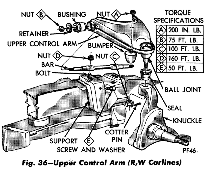

After installing everything, I noticed that the frontend of the Satellite sits really low, although the torsion bar adjusting bolts are almost all the way in.
In another forum I read the following:
"If they need too much adjustment, you will have to re-adjust your camber[upper a-arm]"
As I didn't adjust anything yet (only brought everything to torque specifications), I have a few questions:
a) Is the mentioned quote true and how does camber effect the height of the front end which is usually adjusted by the torsion bar adjustment bolts?
b) What the best way to temporarily adjust the camber / entire front suspension before the car goes to the shop for final adjustment? I have an upper control arm with a pivot bar (R,W car line, see image attached)
I tried loosening the bolts (marked "D" in the picture) but was unable to move anything by hand)
