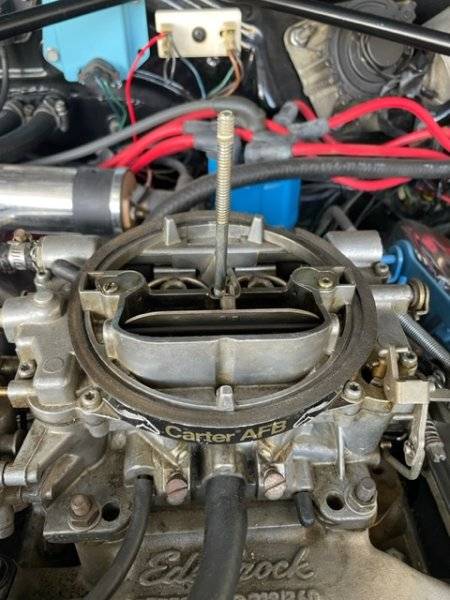

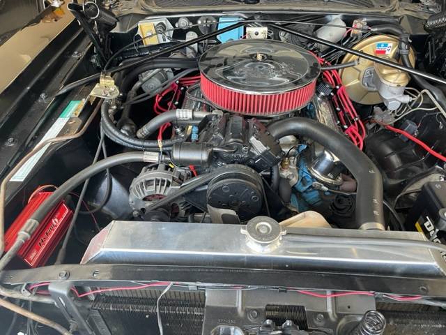

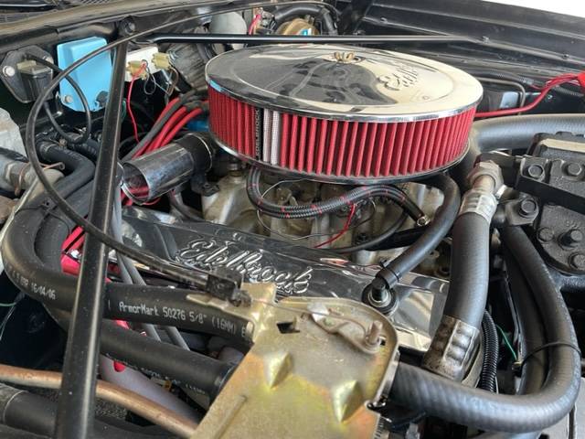

Maybe some pics of the motor so we can see what has been done to it already...intake, carb, ignition, headers vs manifolds..etc. But you can wake up a little 318 easy enough with a properly sourced cam, intake and carb that are designed to work together, and OEM mopar electronic ignition and dual exhaust through manifolds or headers. The transmission is probably a 904 but they are pretty reliable transmissions and might just need a service and the bands tightened and re-adjusted.
The rear axle is most likely an 8.25" unit and might be spinning some crazy highway gears like 2.45's or 2.76's...which with an under powered 318 will be a dog in and around town.
If you can find a 8.25" with a set of 3.21's that would be a way better gear set for your current set up and would increase your fun factor behind the wheel with just that one upgrade, you don't have to swap the entire axle just have the gear set and have it swapped into your axle.
These few things would get you a car that moves along nicely and should have a enough power to be fun and you can enjoy cruising in the car, and in the mean time you can source out a factory 8.75" B-body rear, 727 and what direction motor wise you wish to go and gather all the parts and pieces to do the swap in one shot.
Here are some that I have, looks like he had done rear struts at some point, I don't have a picure but I know the left side headers are pinched a little after my dad found a rather large speed bump lol
