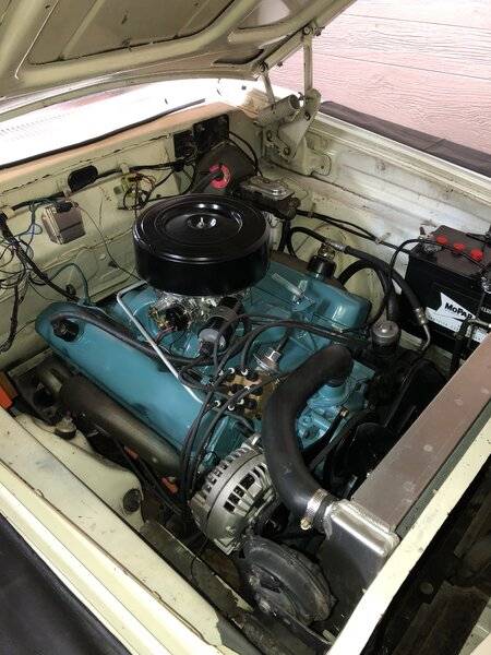

The engine is a 1970 383 HP block with factory flat tops, compression is 9.4/9.5 through 518 heads with oversized stainless steel valves and 0.20 shim steel head gaskets. Intake is a Edelbrock Performer with a Edelbrock 650 CFM carb, electronic ignition, voltage regulator and Engel cam just slightly hotter than what came in the road runners. As stated I am running HP manifolds through dual 2” exhaust with Flow masters. Thansmission is the original 3 speed automatic with valve body and push button shift. Gearing was just updated to 3.23 sure grip in a 68/70 8 3/4” rear end housing. I haven’t had a chance to drive the car since all the changes but I am hoping for the best. Thanks for the input!
View attachment 1198258View attachment 1198259View attachment 1198260
Ok, just have to ask, 518 or 516 heads? 518 are MW.
Oops ,sorry…fixed!
The 516 heads with larger valves and mild porting do well. The combination sounds like a winner for driving/cruising. Hopefully the available gas works OK.

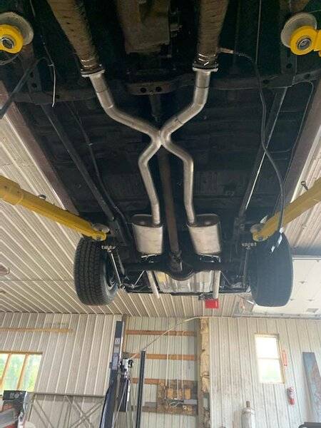

Exhaust pipes measure just a little over 2” OD so I am guessing they are 2” ID.
Tubing is measured and identified by outside diameter. You have either 2" OD, or 2 1/4" OD. Factory 383's had 2 1/4" OD compression bent exhaust to the muffler. The tail pipes could be smaller.
My Charger ran 12s at 109 mph. The Moroso calculator has it at about 450 hp. The car had 2 1/4" full body mufflers and compression bent exhaust.
Looking at all the posts on this thread I still say leave the 2'' pipes that you say look to be new and when you have the new head pipes made to connect to the HP manifolds have an "H" pipe installed if at all possible like @Don Frelier said to balance out the system. I think this would offset the fact that the pipes are 2'' diameter. If you are 330 h/p or less this should be fine for your car IMHO.

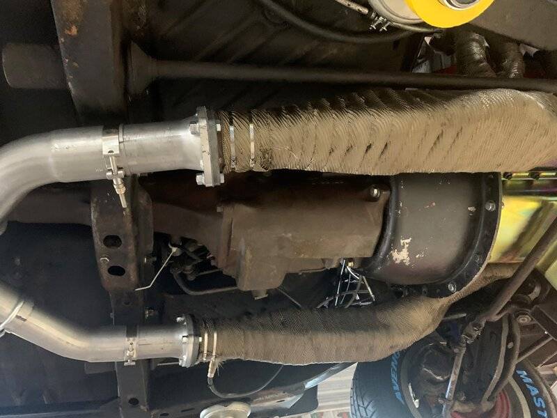

Your 2 inch will be fine. I have a 512 Stroker that Dynode in the mid 500HP and close to 600FPT. I run a 2 1/2 in exhaust ( I do have headers though.) and have had zero problems. My headers are wrapped so I do have some improved flow with that, but they still feed 2 1/2 main pipes and magnaflow mufflers.
How do you figure that you have improved flow with wrapped headers?

I have the TTI 1 7/8 headers and TTI complete xpipe exhaust. mufflers are the magnaflow super turbo. Wrapping any type of exhaust piping is a crucial and important step when controlling exhaust temperatures and reducing radiant under-hood heat. Keeping exhaust gases hotter within the exhaust system helps in decreasing density and increasing the flow of exhaust gases. This improves exhaust scavenging which, in turn, adds power. Also, limiting the radiant heat inside the engine bay can decrease temperatures up to 50%. This reduces heat absorption for electronics, air intakes and through the fire wall, keeping dash components and cabin temperatures to an absolute minimum. Hotter gasses flow faster than cold gasses. SCIENCE!!!

Your Probably right. I was just thinking of the 2 1/2 exhaust pipe part when I wrote it. The main reason i wrapped was the engine bay temp decrease because I am running the Holley sniper EFI system as well and was worrying about street use temps.. the exhaust scavenge/and(Slight ) power increase was just a bonus..

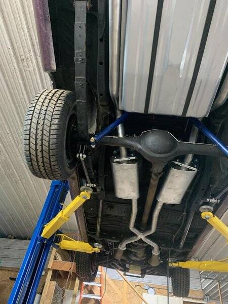

My 64 Fury was upgraded to a 383 this past summer. Before I could finish the exhaust I ran out of warm weather. The dual exhaust that came with the car is just about new with Flow Masters, all nice and shiny. The car isn’t going to be raced and will just be used for cruising. Exhaust pipes measure just a little over 2” OD so I am guessing they are 2” ID. Question is, is it worth upgrading to 2 1/2” pipes for a cruiser from new 2” pipes off of HP manifolds.
2.5" minimum if you have a cam with a good amount of overlap. I can kill my 451 by closing the electric cutouts when it is cold (no choke) just from the change in back pressure. If that happens a 950 RPM think of the restriction at 5500 or more. Just food for thought.
Also, I picked up 25rwhp with the cutouts open. I think you could do better with something other than turbo or glass packed mufflers at the expense of some extra db's for the neighbors.
