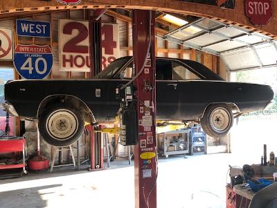

I have a Challenger 10,000 asymmetrical. 220V that I had installed in 2015 for $3400. I ran the wiring myself.
