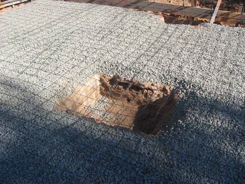

The hoist column base can always be sawed out and the area and depth can be whatever you desire. Common practice in factories with heavy machinery.

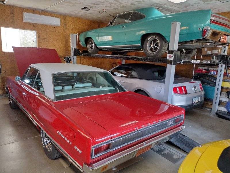

I've a 9K Challenger asymmetric that I use exclusively for working on stuff and a 10K Bendpac 4 post. The 4 post is storage most of the time, but there've been a few times when I've worked on a car with it. I'm very happy with both of them. Both are well built and stable with a car or truck up in the air.
Working on a car on the 4 post is much more challenging than the 2 post. You're always bending to get under the ramps or cross over beams. Can't tell you how many times I've hit my head. Removing/installing wheels/tires is easier and quicker with the 2 post. Bleeding and adjusting drum brakes is also much easier on the 2 post.

I have a 4 post mainly for storage. I did get the trolley jack also. It came with the caster kit and 3 drip trays also. I added LED strip lights underneath. No need for drop lights when working on something.
I have 2 4-post hoists on my standard floor, in the back half of my shop. They're for storage and detail cleaning. No issues thus far...

I like the fiber mesh much stronger. Pored my garage floor six inches thick with bell footers. Pored it in sections three bays. The last one was the middle one. It got cold and was waiting to finish bull floating the floor it did not want to harden. After much time went in for a cup of coffee and came back it had set. Oh well things happen! But it was level just did not get to broom finish it. Getting too old now for those kinds of projects.

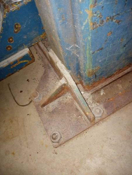

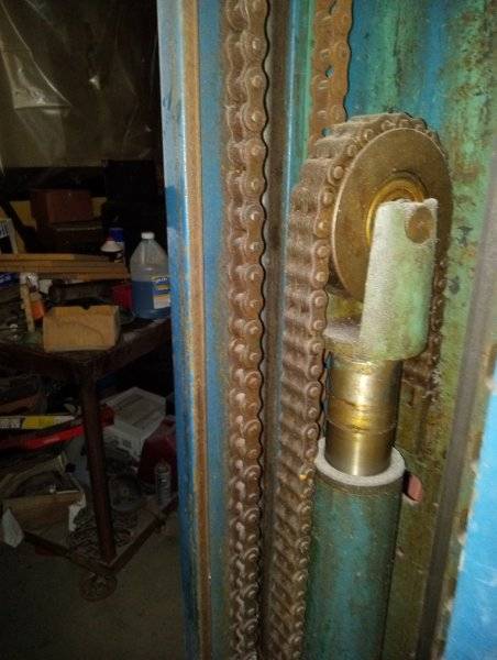

I bought a used 9k two post in 1996..its a Weaver. 1" thick steel....3" hyd cylinders. Leaf chain and roller chains... no wimpy cables.
$1800.
Weighs about 900#'s.
I have had my F350 dually on it...and my E350 loaded with 3000#'s of steel castings..
It sits on 4" of 6 bag mix concrete with fiber mesh added. No rebar...no wire.
After 27 years of good service no cracks or issues with the concrete despite all the scary predictions.
If you want peace of mind don't buy a cheap China lift.
YMMV.
