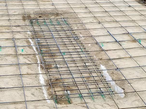

Just about done with hillside detached garage/workshop project. As others have said 2 post for working, 4 post for storage. My 2 post lift will be moved from attached garage to center bay of the new shop. Pad was 5" with 3500psi mix. In the lift area, a 4'x15' tray, 12" deep. Gradual slope from 12" to 5" to minimize cracking. Used Bendpak specs for rebar, one layer at 9" depth in tray area, below Hilti Hit-Z anchor rods at 8" depth. Other layer at 3" depth over entire pad, spaced to avoid fastener holes (hate drilling through rebar).
