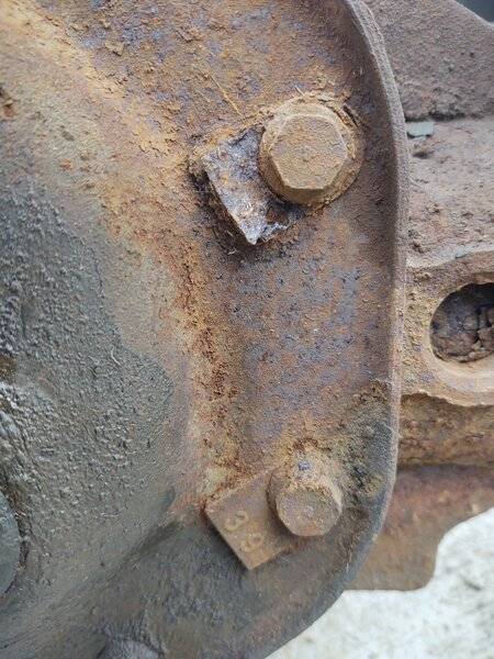

most all are 3:55 gears,check the glovebox to make sure the l/s code is there.

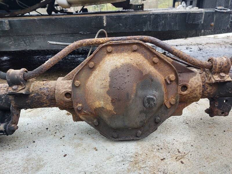

You can look in the bottom of the glove box for a label which should tell you axle ratio. The Gen 1's were 3.55 or 3.92. Through some research way back, I found that the 3.55s were selected about 66% of the time, whereas the shorter 3.92 was around 33%. If that label in your glove box mentions "Anti Spin", you have the oem limited slip carrier. The larger 9.25 inch ring gear housing inspection cover resembles a stop sign, whereas the smaller 8.25 inch ring gear housing is kind of round.

Well it looks from as far as I can see that the daughter's 72 Satty has at least the same differential cover so maybe this is dumb luck? The drivetrain is slated to go in her Satty. I'll store the rear away in hopes that it can give up the SG for her build.

The rear end in the pic you posted looks a bit on the crusty side.....at least for SE Texas stuff. I'd pull the cover and make sure things look ok inside.
The R/T'S got 8.25's from the factory, the Durango's were all 9.25's as I remember from my dealership days during that time. Mid 90's is when the Dakota's went from 5 to 6 lug. They used the same pattern as the Vipers and I believe the same hub/bearing unit as they were a sealed unit as opposed to the earlier Dak's using serviceable bearings and seals with the 5 lug.

This is an 01 with 6 lugs.
The "crusty" is common in Ohio when a truck sat for years in someone's yard as this one did. I have no concerns with the internals, typically something this crusty will clean up nicely and look like new inside. We have some very damp seasons, leaving a vehicle sitting in a yard is the absolute worst thing one can do.
There is nothing in the glove box on my 92. There is a label on the underside of the hood. It shows the model of transmission, gear ratio and rear brake size
