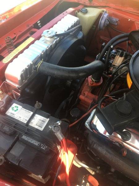

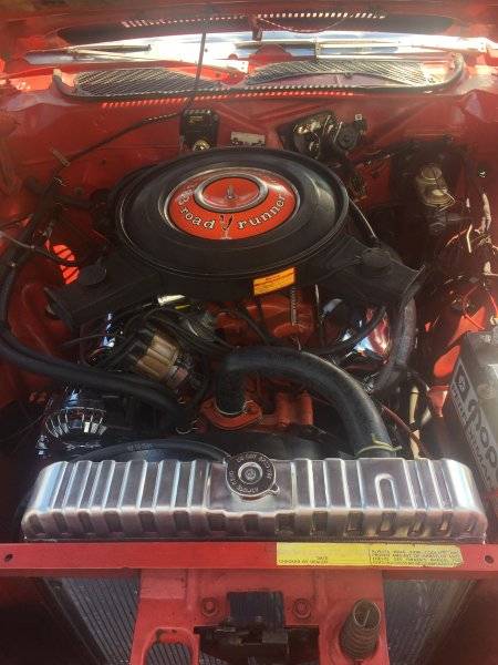

Anyone have a part number for good fitting aftermarket top radiator hose for 22in radiator 71 383 inlet on drivers side? I really don’t want to spend $70 for a repo oem style hose.

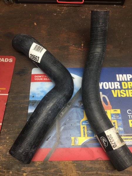

I looked through my old receipts and found one I purchased from O’Reillys back in 2007. It was a Gates 20370. See photo.
Ron
Seems like I had to cut about an inch off one of the hoses. I believe it was the upper, but being 15 years ago, not 100% sure.
Ron
Installed a new oem style aluminum radiator with the 20370 gates upper hose worked with out cutting the hose!
