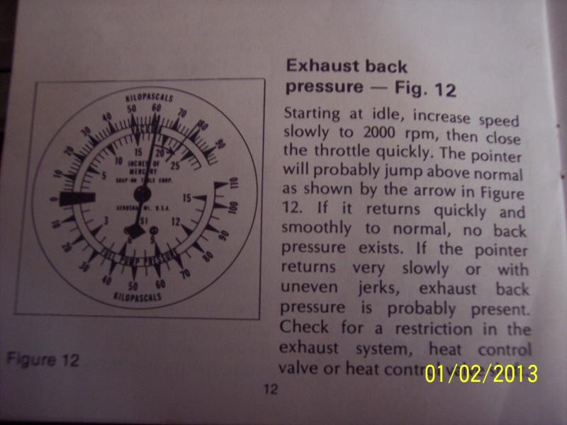

High vacuum
Saccylone
I will take a guess and I would check the exhaust for restriction.
Heat riser froze shut,critters carrying debris up the exhaust???
