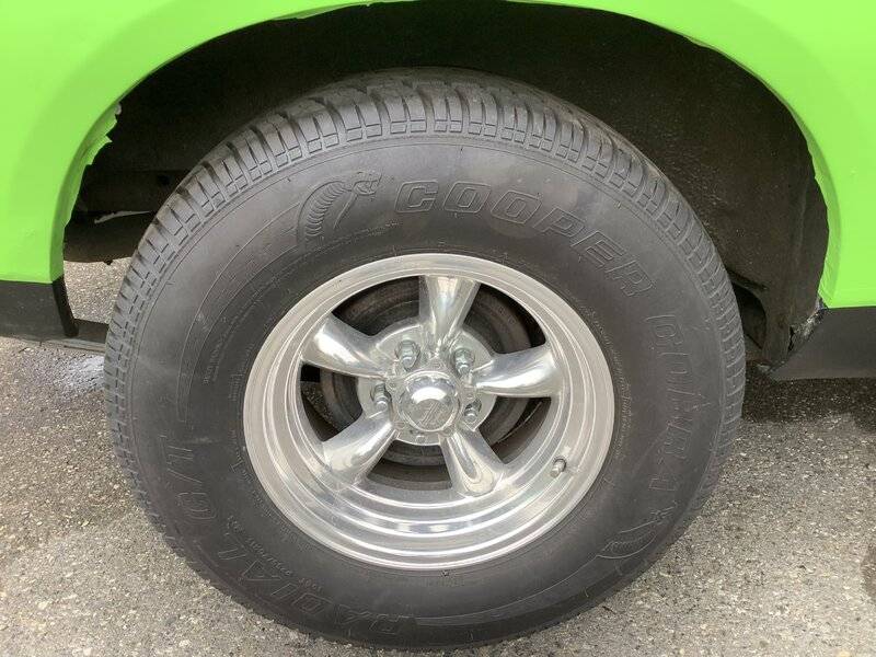

They are Cooper Cobras, I just mounted them white letters in. I purchased mine locally but you might want to check one of the mail order houses. If they have them the prices seem pretty reasonable.

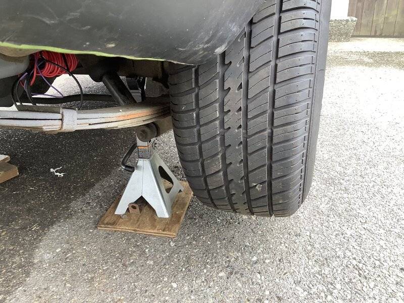

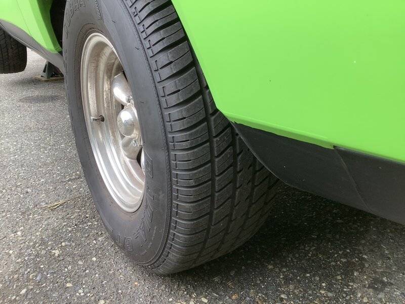

I just put on a 245/60/15 Cooper Cobras on a 15x8 with 4 1/2 backspace on the front of my 70 Charger. No rubbing issues at all. The rim is very close to the upper control arm. A 4 1/4 backspace 15x8 would work perfect.

I just put on a 245/60/15 Cooper Cobras on a 15x8 with 4 1/2 backspace on the front of my 70 Charger. No rubbing issues at all. The rim is very close to the upper control arm. A 4 1/2 backspace 15x8 would work perfect.

72 has a lot of room for tires. Ran 255s on the '71 Charger with 7" wide rims and 3.5" offset. The 68-70 need a smaller tire or more rim offset. I put those rims/tires on the '69 Coronet, and they "fit", but on full turn I have caught / touched the wheel well trim.
I run Cooper Cobra tires 255/70/15 all around on my 3rd gen Charger on A/R 15x8 and still have room. I went with 70 series to get a taller tire to help fill out the opening. Makes a great footprint and these tires handle wet roads really nice.
