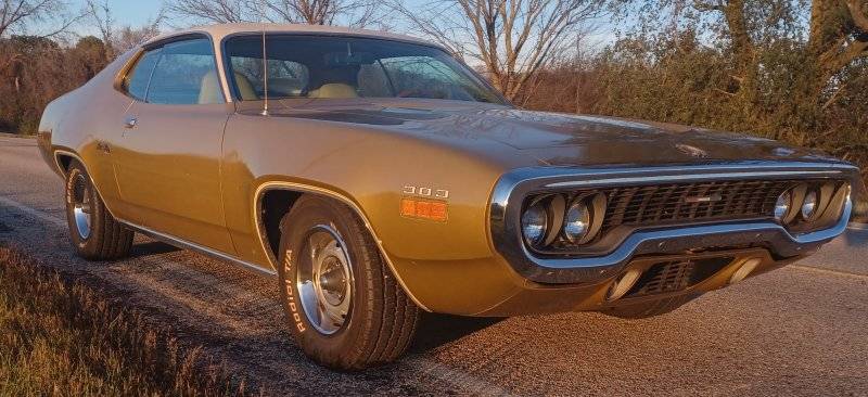

Sleeper Satellite...3.55 SG, built 383, yes 55-60mph is really it, but it loves throwing you back in the seat!
